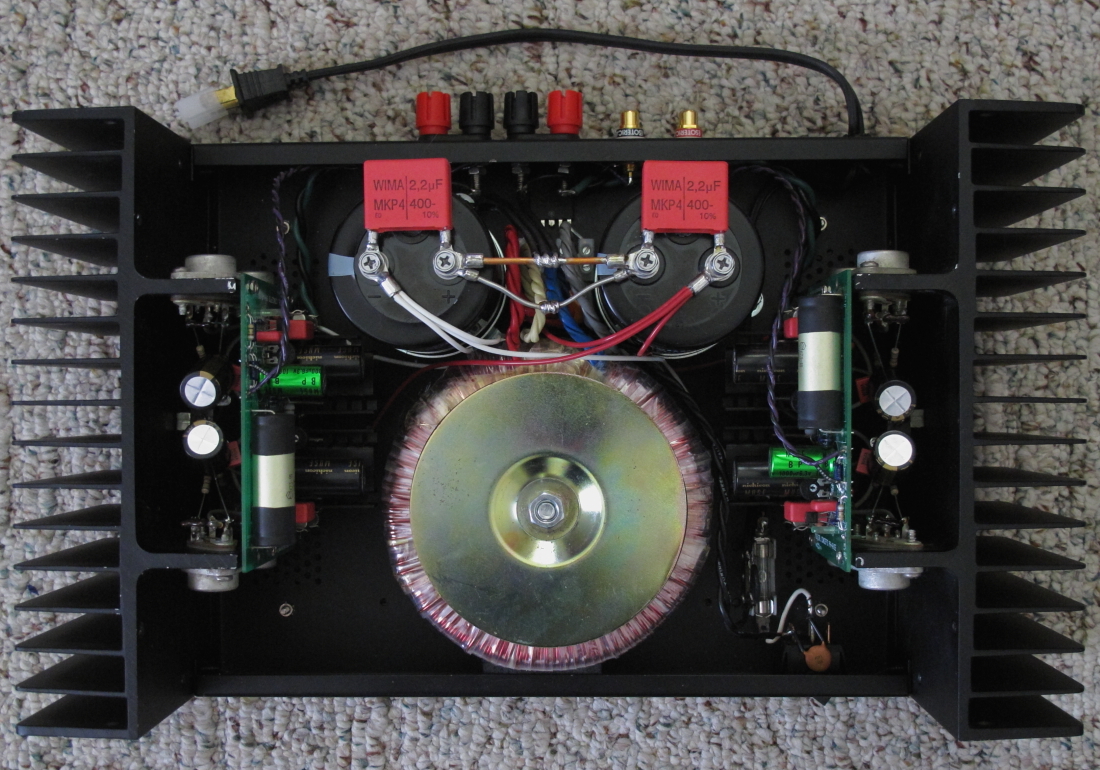

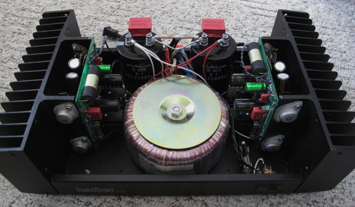

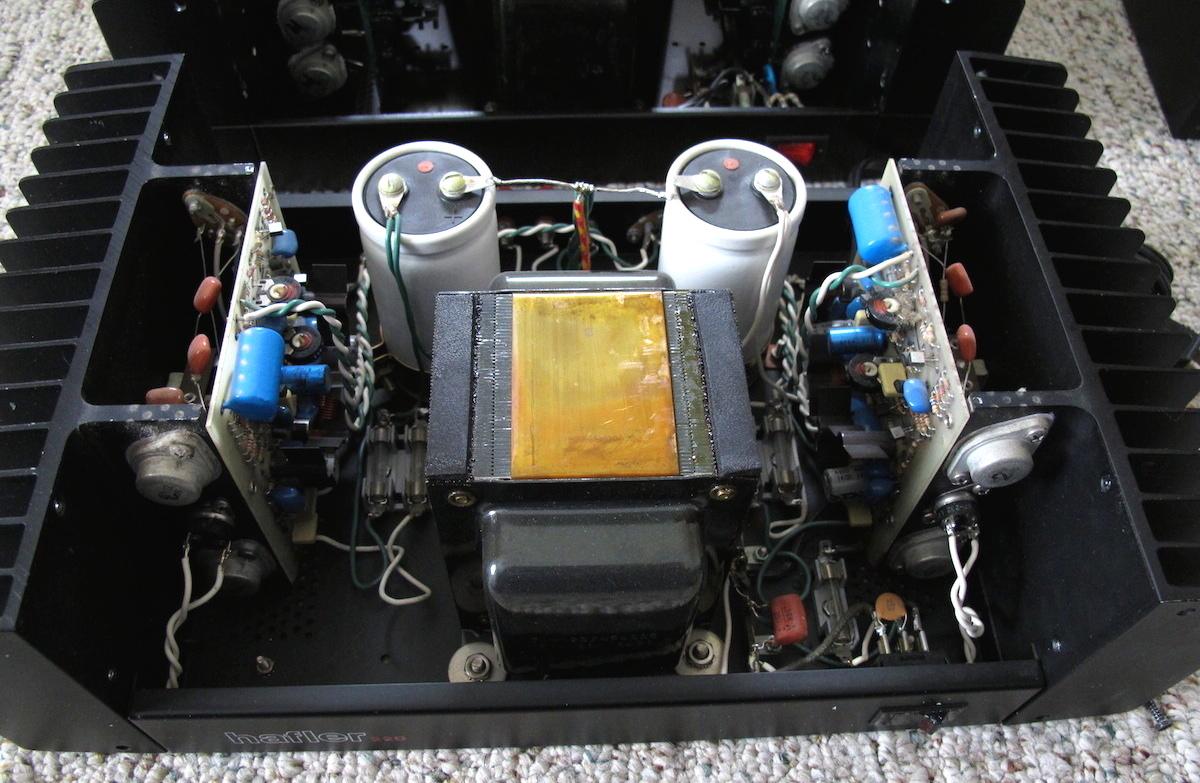

Stockish DH220 and crazy MM220
A few pictures of my latest “Hafler” DH220 based amps builds, referred to as MM220 amps. These amps ~ WERE NOT CHEAP TO BUILD ~ I was not building to a price point, I was building to a standard of quality, not possible in their original manufacture. Hafler amps were built to a market driven price point and to only ‘deliver spec’. I usually spend twice what I pay for the ‘working chassis / amps alone for a basic build and triple or quadruple that to create super amps ~ vastly surpassing ~ so much of what is available in todays products, up to 10 times their cost. I understand that this may only appeal to limited few here.
The one on the left, for a music appreciating, non-audiophile person, wanting vintage gear, with modern parts. He was not in a capacity to afford newer / completely modernized Musical Concepts driver boards or the more expensive power supply options. I left the speaker protection fuses, but moved them in series with the speaker outputs, while simplifying the output stage filter networks. It is rebuilt as a brand new amp, should play wonderfully for another 30 years...
I left the stock transformer to reduce costs and used the best capacitors that the collective / entire budget would permit. I used the stock PC19 driver boards, but completely rebuilt and optimized them. I did not simply only change the stock 3 electrolytic caps to audio grade caps. *These amps border unsafe with stock electrolytic caps… especially the stock white main P/S caps...
The amp on the right is an ~ ALL OUT AMP ~ which I built with 'scavenged parts’, the toroid from my original MC220 from 1985. This new amp is for a close personal friend, that will use it a bass amp in a bi-amp speaker system. I often ask people what their budget is… to establish some hierarchy in allocation of a sensible / meaningful cost structure... to spend money where it will make the biggest difference given its intended role and application in use. It matters and ever builder should look at their approach, consider where it will make the greatest impact in the collective of parts being assembled as a whole. I am paying it forward with this amp… It is the most stuffed chassis I have build in 40 years of building “Hafler” based amps.
I cannot emphasize strongly enough how important building a solid core is to the end result. Of course everyone's abilities and or limits must be considered, as it is not an easy task… but very much worth the effort. A happy chassis is always a great sounding chassis. Many older kit builders, in the day used wretched silver coated copper wiring, among other things that really harmed the beauty of these amps. I remove these sort of things, the original tinned copper wiring is not sonically in need of replacement (if in good shape) but everybody has to begin and learn somewhere. I often time ‘have to rewire’ as newer parts and chassis layout requires it, the original wire lengths will not fit the newer component placement. Modern driver boards with fuses on them eliminate chassis pan fuses, freeing up much room to do a lot of creative building..
In this build the #1 most important "component part" was the DRIVER CARDS. Goods ones ~ ARE NOT CHEAP ~ the original PC19 ones are showing their age and are profoundly limiting. I no longer even bother rebuilding original Hafler 200/500 (PC6 / PC10 boards)… I will not build any amps around them. The fully rebuilt ‘modernized’ PC19 driver boards are used in the “STOCKISH” MM220 on the left is pretty good but does not adequately showcase these fantastic vintage lateral MOSFETS
For the ~ ALL OUT AMP ~ on the right, I used my original (exemplary) Musical Concepts PA4 boards, pulled from my 2013 MM220 build, which were effortlessly running Magnepans for many years. I knew what to expect, including these in this stuffed MM200. The #2 most important part, the beefy 625va toroid, was the biggest I could squeeze in to the chassis with (the #3 most important part) 80 wvdc / 22,000 mfd, 62.5mm filter caps. The #4 in order, was the RCA inputs and the 5 way binding posts. I budgeted accordingly, am happy with the result. cannot wait to see the expressions on my buddies face when he hears this amp. He will be comparing them to Futterman OTL amps; the ones I used to own..
It could be debated using the stock speakers terminals... however they will not accommodate too many types of good speaker cables [none, that I own or use] with modern connectors (unless using just ‘basic’ banana plugs) they are an absolute hazard with modern spade terminals and risk damaging them, even worse short circuit. I asked my friend what he would be using in making decisions. As a direct example, the 5/16” WBT spades (200.00, for a set of 4) on my Monacle Kimber Kables, would possibly only be mangled, not even work as intended. GOOD BINDING POSTS ARE A MUST… budgeting them your call… filing out the chassis to fit (is based more on your skill and ability) Not easy but worth the efforts.

TM2, My recent post touches on elements we talked about, there examples of chassis layout and wiring. "Stockish" and a super dense pack model [not so much that I am recommending it...] which took me the better part of a month to wrangle, in my mind...
I used what I modeled and learned from the P230m layout. It was still a challenge... I try a lot of different things, learn from every approach... each having it's own place, either cost (budget), the intended use or layout constraints... very common.
You can sort of see the IXSYs HEXFRED mounted on the barrier strip and buried between the filter caps. It is straight forward and worth the effort over the stock block rectifier. Musical clarity and bass slam will amaze you...
*Yes, my buddy request a 1 foot power cord... I cut it that short... LOLS.
