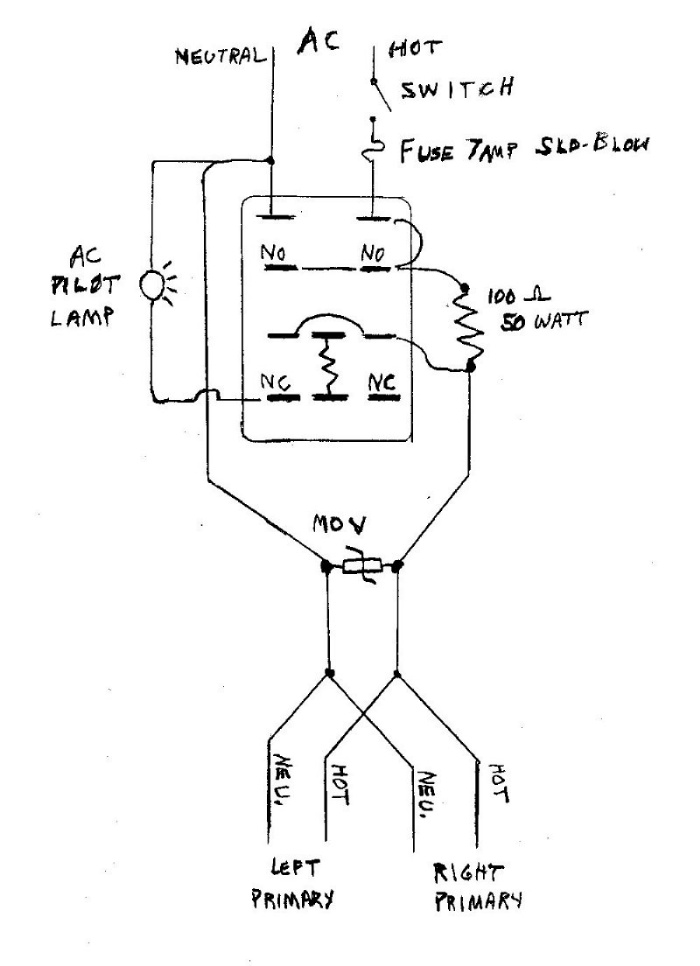

My DH-200 pair of mono blocks each have a pair of 39K mfd caps suitably bypassed with quality film caps. No changes were made to switch, diode bridge, etc. No change was needed because I use a soft start circuit.

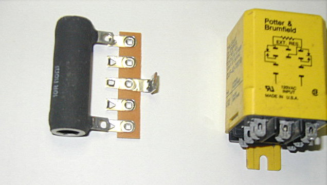

My soft start is mounted in a separate metal cabinet that has AC sockets into which an amp can be connected. The soft start circuit is realized using a time delay relay and a 50 ohm power resistor. About 8 seconds are used when turned on until the amps' PC capacitance is fully charged.
So, you could swap in a pair of higher capacitance good quality PS caps, and maybe even find a way to shoe horn in a 2nd pair of caps. No muss, no fuss, when using an outboard soft start box. I soft start 156K mfd of PS capacitance for this pair of amps with nary a whimper.

8 seconds? That must be a very large power resistor. I think a typical soft start circuit would trigger in a second or less, and this is typically long enough.

You are correct. The 8 seconds is too slow. A 20 ohm resistor might be more suitable. I went with the power resistor I had handy, plus I did not know at the time how many amps might be soft started at one time. Building a soft start circuit is simple to do if one wants to do it. I went for a more plug n' play approach. Here is my wiring diagram and a picture of the power resistor, a stand off connector, and the time delay relay.
The trick is to find an AC powered relay suitably sized for the occasion. I got mine off (where else) eBay.
