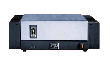

The NYAL Moscode 300 was based on the Hafler DH200 chassis, so it can be done.
George Kaye (the designer), is still around and has some parts for the Moscodes. I know at one point you could send in your Hafler DH120/200/500 and have it converted.

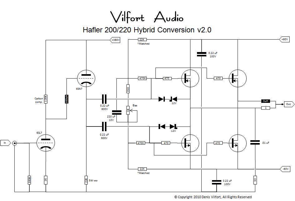

Hafler tube conversion version 2
Like all amps, this one too needed to be listened to for a while... Well over the weekend it became crystal clear that the MOSFETs are VERY precise in their control of the speaker. Even without feedback... So the old Broskie Aikido setup started to reveal a bit of glare in the high treble.
I have used SRPP in the past and always liked the detail the topology provides - but with MOSFET output as opposed to say 300Bs and OPT it became very fatiguing to listen to. As a result, my wife left the room when I was playing at high levels. - That did it!
So back to the drawing board. We need a medium of voltage gain and low output impedance here. The easiest way to get there is two stages: a plate loaded voltage gain stage and a cathode follower. Since I already had the 6SL7 and 6SN7s plugged in, why not do a little math and leave the tubes in place? The result is half the tubes can go. We now have a 120K carbon comp plate load on the 6SL7 and 22K wire wound on the 6SN7s cathode (see attachment).
This helped a great deal. We still have all the detail – but midrange and treble is now a little more ‘airy’ and less harsh. Wide sound stage. Sounds very 'live' - and this one makes the speakers disappear!
So if you want to build something, try version 2 here. I have never heard the Moscode so I cannot compare. If you build it, please post your findings and comparisons with the Moscode.

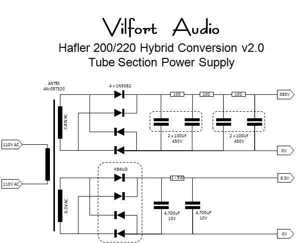

Vilfort: Looks very interesting. Is the 10 ohm resistor correct? Can you show us your power supply for the tubes. Were you able to fit in same chassis?

Richard: Yes, by using a torodial transformer (link here: 320V 50VA Toroidal Tube Pre Amp Transformer Guitar Amp - eBay (item 250596547118 end time Mar-20-10 19:44:30 PDT) ) and placing it right next to the power transformer on an L-bracket it fits nicely. The tube section can be built on stands and a mounting plate off the bottom of the chassis. Caps and cap brackets can also fit there. A few good solder lug strips help here. You may have to move the big power supply caps from the MOSFET section. But with a little care, it all fits. I have enclosed the tube section power supply schematic you asked for.
