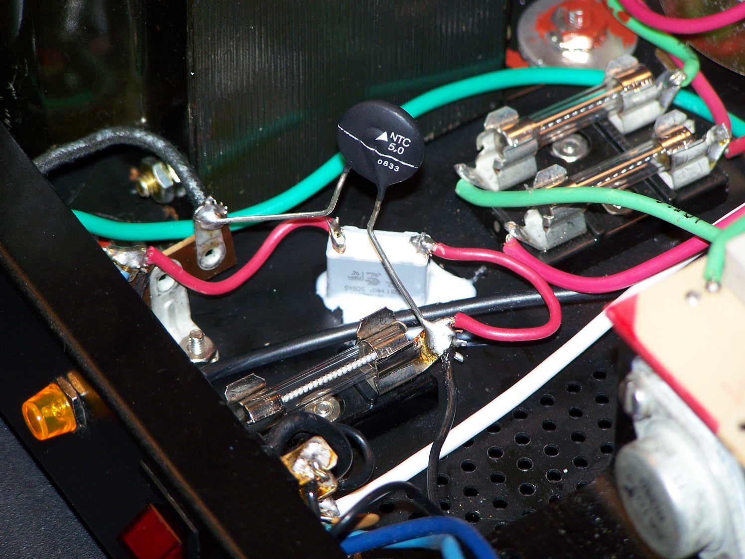

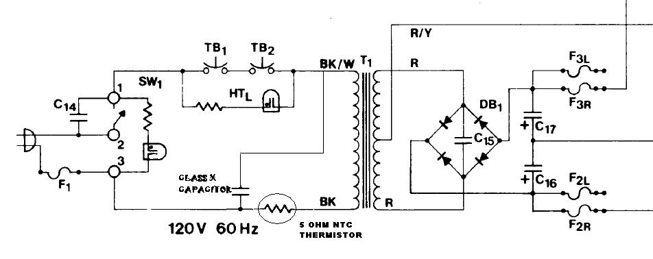

The first mod is simply an NTC thermistor (5 ohm cold) on the AC power. This is needed to prevent the switch from failing due to high inrush current. On most of the amps I see, the power switch is toast and has to be replaced, but it will just fail again unless you do this mod. If you do nothing else, do this mod!
The second mod is a MOV across the transformer primary, in parallel with an X Cap of 0.047 400v. I also put the same value X cap across the rectifier bridge AC inputs. This removes switching transient noise on power on and off, and protects from line surges and noise.

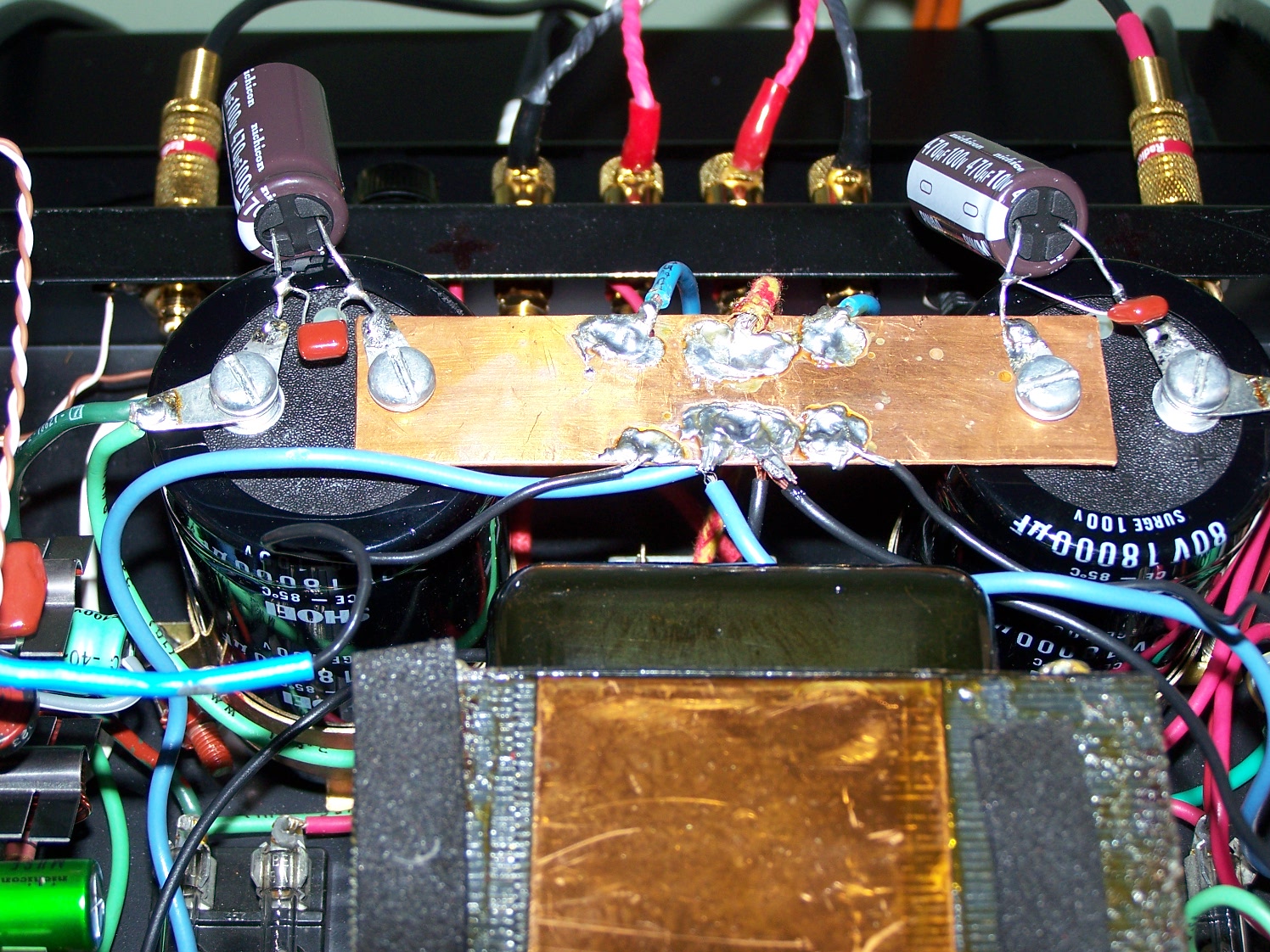

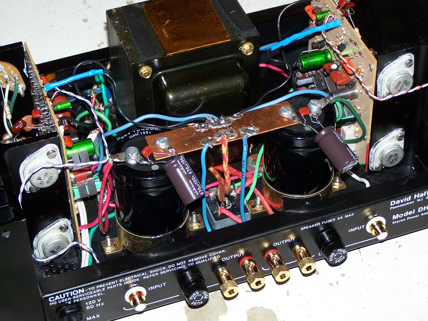

My power feed mods are done. 3-prong 14 AWG power cord, 5 ohm NTC thermistor and X class capacitor on AC feed line. I need to somehow take the output transistor ground chassis tap off and come off the new ground bus on the main caps. Only problem is the connector itself is screwed on to the the heat sink now receiving house ground via chassis. I am isolating all grounds to the new ground bus made from a flattened 1/2" copper water pipe.

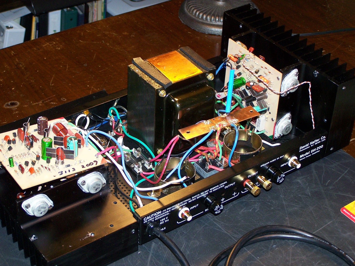

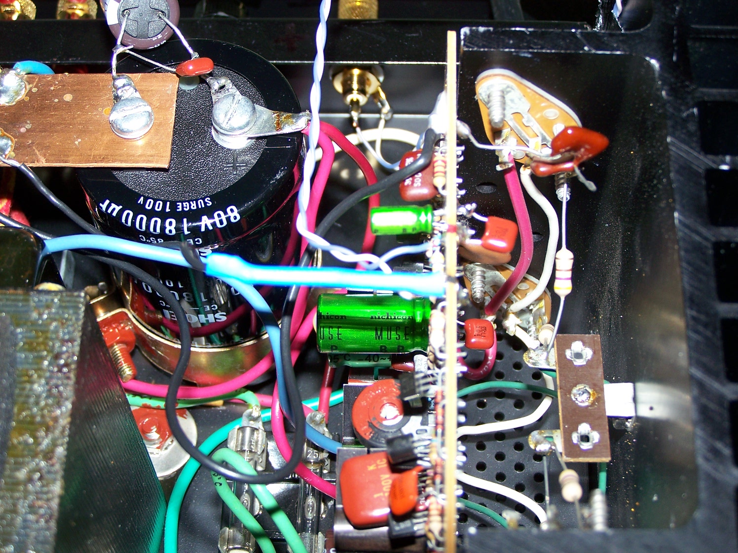

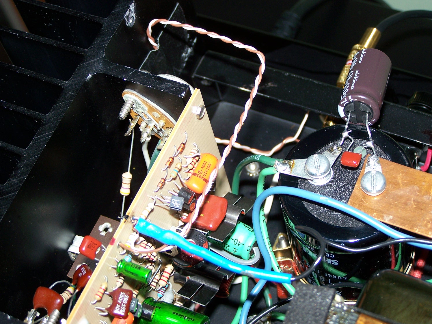

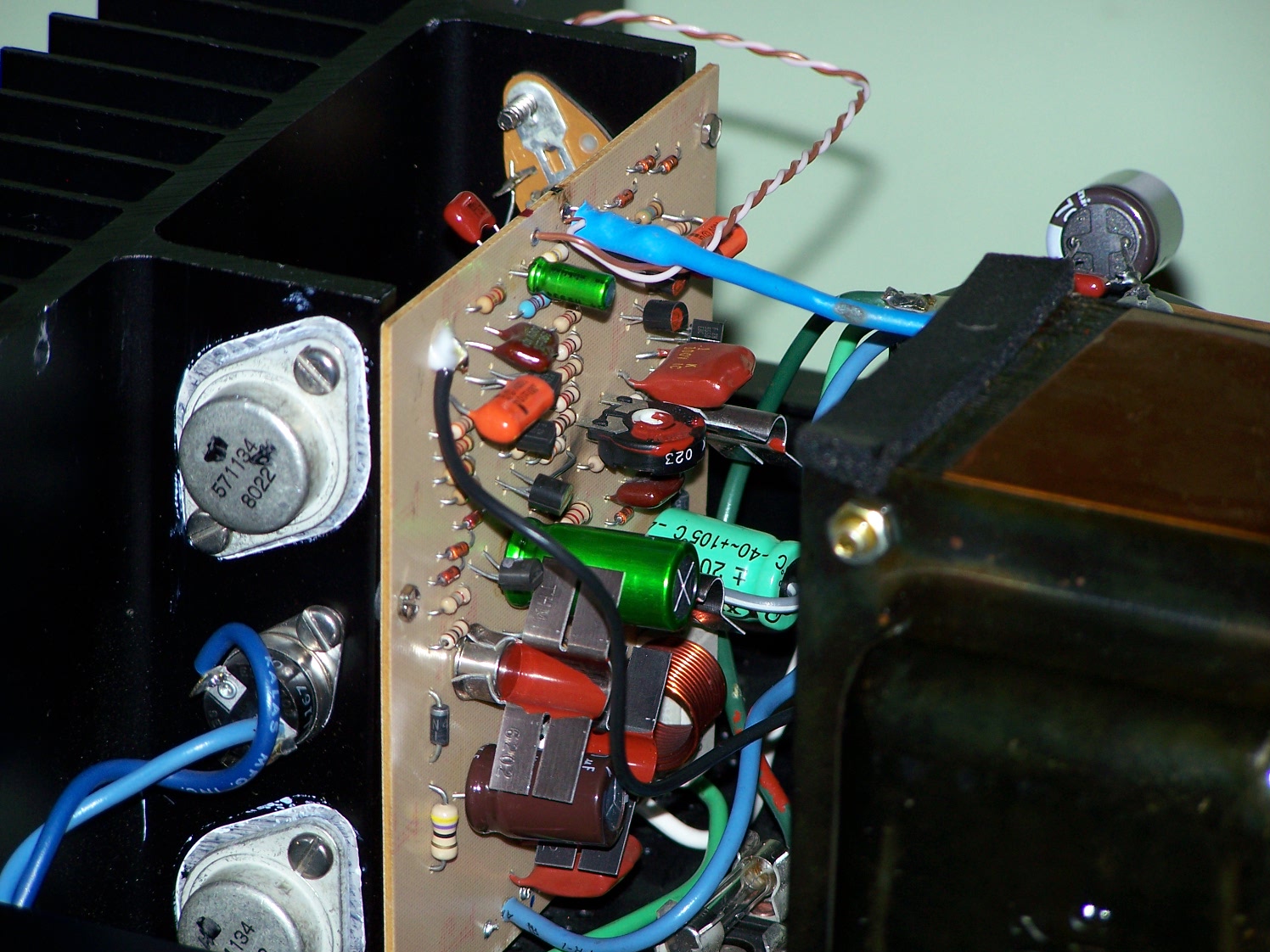

The Hafler DH-200 is done. With advise from this thread and others, here is what I've done:
  1. Replaced all electrolytic capacitors.
  2. Mains were upgraded to 18,000 uF 80/100 VDC each caps (from 10,000 uF ea.)
  3. For bipolars, Nichicon MUSE ES were used
  4. For the other two, Nichicon and Xicon
  5. Installed 3 prong 14 awg power cord
  6. Grounded chassis
  7. Removed all grounds from chassis, ran them home via star topology to a replaced copper bus bar
  8. Input ground via 2.2 ohm resistors
  9. Replaced all input and outputs connectors with 24 K gold plated
  10. Used CAT6 data cable for input signals
  11. Bypassed all bipolar and main caps with .1 uF film caps
  12. Bypassed mains with 470 uF 100 VDC and .1 uF film caps
  13. Removed output tranny grounds, tied them to ground bus
  14. Installed an NTC 5 ohm thermistor as inrush current limiter
  15. Installed a class x capacitor accross the main AC line
  16. Set bias to 275 mA
  17. DC offset L 11 mV R 70 mV
Sound is awesome even with caps not broken in. Very quiet and powerful. Nice laid back disposition like that of tubes. Love it.
Thanks for all your help.

Here you can see output transistors black ground wire towards left side of pic. I drilled a hole and fed the film cap through it to meet the wire.
attachment.php
Here you can see the CAT 6 input wire and the main caps bypassed with a .1 uF film cap and a 470 uF 100V electrolytic. If someone has a good grasp of what these bypasses do, please say on. I have read Tamara's and Wong's white papers...
attachment.php
