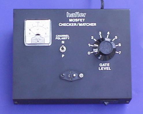

DH-200s. I guess I'm ready to start working on these. Over the summer I knocked out 3 Ampzilla rebuilds, 2 SonofA rebuilds and I just finished a GFA-555 and a complete rebuild on a Phase Linear 700 II. I feel like working on something more simple now.
I have 2 defective DH-200s that I can basically do whatever with. One just fails to proceed and the other has been modded to death, mostly by the addition of soldering iron burns and the removal of critical insulation. I have a batch of semis on order and I could just restore them to original condition, but I feel like doing something more interesting with them.
One suggestion was monoblocks, incorporating one driver card/chassis. As described, the N-devices would be on one heat sink and the P-devices would be on the other, allowing more output devices, higher bias current & other changes.

My priority would be improving current delivery into low Z loads. My main speakers for now are Linn Isobarik DMS. They seem to like MOSFETS better than BJTs. The Z goes below 4 ohms in significant places and they're in a very dead 900sf ( ~ 80 m sq) room. Power is needed but not kilowatts. I'm thinking that a lightly modded pair of these Haflers might be just the thing, and would be cheap to do.
Stuff I'll do for sure:
0) replace defective components.
0.5) test and match all xstrs
1) correct the grounding.
2) upgrade all electrolytic capacitors, within reason
3) take a look at the film bypass options & adopt those that seem practical
4) retrofit circuit on input for DC balance.
5) incorporate into my PC-19 boards improvements that were added to later versions.
6) add IEC sockets for power cords ( safety issue. I've badly broken a bone in my foot tripping over a line cord while carrying an amp and I eliminate them whenever I can)

Practicality of separating N and P MOSFETS to opposite ends of chassis
So my question would be if a DH-200 was converted to a mono amp as described in an earlier post, with a single driver card would it be practical to separate the P and N MOSFETS to opposite heat sinks, distributing the heat equally?
The problem it seems to me would be long leads to the Gates of one or both sets of outputs. Possible issues:
1) lead inductance
2) stray signal pickup.
Are these significant considerations?

Thanks for your reply. I suppose matching should take care of the DC offset initially. I noticed that later versions of the PC19 board incorporated a DC offset adjustment pot. This leads me to believe that there might be a need for it due to heat, aging, etc.
One way to avoid having long gate leads on one side would be to place the one driver board centrally. This would require moving the rectifier and filter caps out of the way. I can do that because I have some very small 15,000uf @ 80VDC caps that I plan to use.
I'll have to do some measuring, but I think the leads to the gates could be gotten down to under 5" on both sides.
I'd like to use both heat sinks so I can drive a total of 6 MOSFETS and have plenty of cooling.

pidigi said:Hi,
I wouldn't like this so long gate connections, for the reasons you already pointed out.
But why do you feel a DC balancing is needed if you are going to match the transistors?
Ciao
Paolo

Transistor matching also takes care of some distortion in the input stage. The balancing circuit will hide this problem.BAUHAUSLER said:
Mosfets are high input impedance devices, as you already know. I don't see very well this long gate connections.

I've put 6 mosfets (obviuosly matched) directly soldered on the PCB, not the 2SJ49/2SK134 but their TO3P equivalent 2SJ162/2SK1058, and I'm planning to use a board on every heatsink. You said that you are going to install external low speed fans anyhow, so I wouldn't care about temperature rise.

I see. So if I understand you correctly:
1) keep all outputs on one heat sink so that Gate leads stay short
2) use a fan if necessary to shed heat
3) use matched input transistors to achieve DC balance and reduce distortion.
Sounds like a good plan. I also have the TO3P outputs on order so fitting 6 of them them on the heatsink will just require a little drilling and tapping.
I got my 3440 and 5415 transistors from Mouser yesterday. I ordered 15 of each, specifying units from ST. A quick check of them on an HFE meter showed nearly all are 63 +/- 3 for both the NPNs and PNPs with 2 or 3 outliers around 70. This is exceptionally close for a batch of randomly chosen devices.
That reminds me I need to hunt some nice heat sinks for them.
The project is on hold pending delivery of more parts...

How will you match the output MOSFETs on Vgs?

I don't know yet. I downloaded some circuits for simple testers to match power MOSFETS. I assume I'll just mod one of the rigs that I use to match power BJTs and it will be like that except less thermal drift hassles. I'll lash something up when the MOSFETS arrive and start fooling around. I ordered the Renesas 1058 and 162 devices.

I match my MOSFETs using an original Hafler MOSFET checker. If you pay postage both ways I will match your devices for you and grade them 1 through 7, just as in the Hafler amps.
