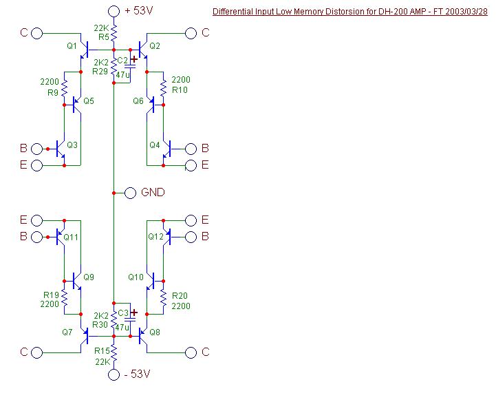

Next, I want to present the next significant mod, the "low memory distortion input stage. It consist of replacing the 4 input bjt with this attached circuit. It can be built using one Radio Shack universal pc board for the 2 channels. The resulting input module (1" x 2.5" for each channel) is installed as a daughter board on the main board.
I must say that I have heard details in the music which were not known to me before the mod.
Has anybody other diy used and appreciated this input arrangement?

Slowhands
First, thank you for all your comments. As usual, you are very precise and clear. I agree mostly on everything you have indicated. In fact, I have already performed almost everything you have indicated. The re-routing of the "power" ground is imperative as it is also for the other ground connections.
However, I am not "wary" at all to modify this board. Maybe this is because I have always recovered from any of the numerous mods I have tried on this DH-200 driver board. It is true that when you remove a frequency compensation network of the amp it can oscillate but are any amplifier needing a compensation? The input cap is mainly to restrict an extremely fast input signal slew rate and this approach is well recognized and used. I confirm that no miller capacitors revealed to be usefull with any mods I have tried. The amount of overall feedback can be reduced a lot and still preserving a good stability. I actually use about 42 db which can be considered a low level feedback design.
Regarding the specific input stage mod described, the diy builder is not to wary at all since the stability of the amp will not be affected (if the same 2N5551 and 2N5401 are used for all input transistors). In fact, if a mod I suggest require an adjustment on the frequency networks I will indicate it.
Again, I try to present small very cheap mods that can be fun to do (at least it was for me). I have the layout of this input stage board using an universal cheap pcb for those "diyers" who are interested.
Thanks again for your valuable reply.
