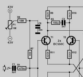

I'm looking for a fix that will help me eliminate (or reduce) the 50mv DC ofset (in one channel) of my Hafler 9180 series amp. The DIY mavens were very helpful in curing the DC offset problem in my DH200.
see DIY Thread for that background: http://www.diyaudio.com/forums/showthread.php?s=&threadid=131364&perpage=25&pagenumber=1
ANYWHO...My need is to direct-drive a Morel EM1308 from this amp. I'll need as little DC offset as I can get so the dome remains centered in the magnetic gap. (5 mV max would be nice)

I decided to try the same tweak which brought the DC offset in my Hafler DH200 down from 300mv to 4mv. In the DH200 they are Q1,2,5,6. In the Hafler 9180 they are Q5,6,7,8. The devices I used are Matched / Paired 2n5551 and 2n5401. Unfortunately in the 9180 NO CHANGE! Still 50mV on the left channel and 25mV on the right. This wouldn't be so bad except I need to directly power a low excursion midrange directly from the amp. Does anyone have a suggestion to get the offset down to below 5mV?

If the offset is consistent and does not fluctuate with time/temp,
then you can eliminate it with the opposite amount of offset injected
to the input.

I am sorry you've not yet found the FETs needed. Now you know why I said on the other thread that I was avoiding this amp. FETs are often difficult to find a few years later.
On the other thread I told you how I fixed the DC offset in my DH-200. It is essentially the same circuit as Lord Winter just described. His parts values are quite high so you will only get a trickle of either + or - voltage, depending on the setting of the pot's wiper. Reread my message on the other thread on how to do this.
