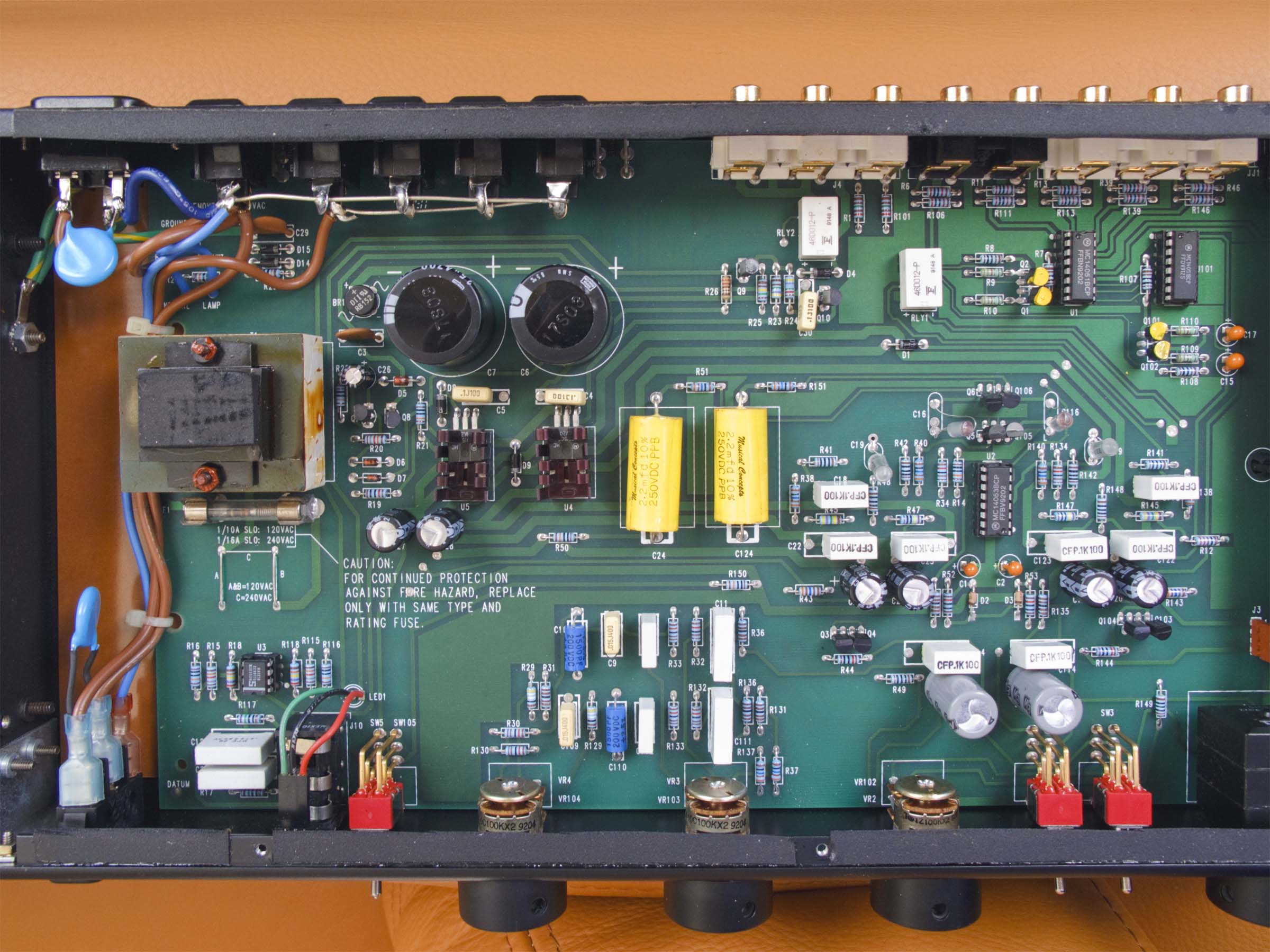

I have a early '90s Hafler 915 preamp in perfect working order. It is smooth and musical, but not the most detailed. Anyway, I like its sound very much in my system.
Would I benefit with replacing the two 4700 mfd 35v polarized electrolytic caps in the power supply (large black caps in upper left of photo) to something better? What would your recommend (they are short and wide)?
Thanks Mr Marsh,
I was too lazy to open it up to take better photos so I found one on the web. But, the caps are a non-specific brand?
What do you mean by 'low Z'.
All I find are electrolytic in my search. Is there a better option, or is it ok to get a better electrolytic cap?
Lastly, should I up the mfd to a higher value than 4700 mfd, 35 volt?
Most important is to get caps that physically fit so check the data sheets of any you are looking at for size and pin spacing.
Low Z or low E.S.R. denotes a low internal impedance. That is perhaps more applicable to switching type supplies rather than linear ones such as this. I wouldn't increase the value at all and yes, any caps will be electrolytic types. Go for a reputable brand rather than a "generic" unspecified device.
(I suspect there is probably no benefit to be obtained by swapping these)

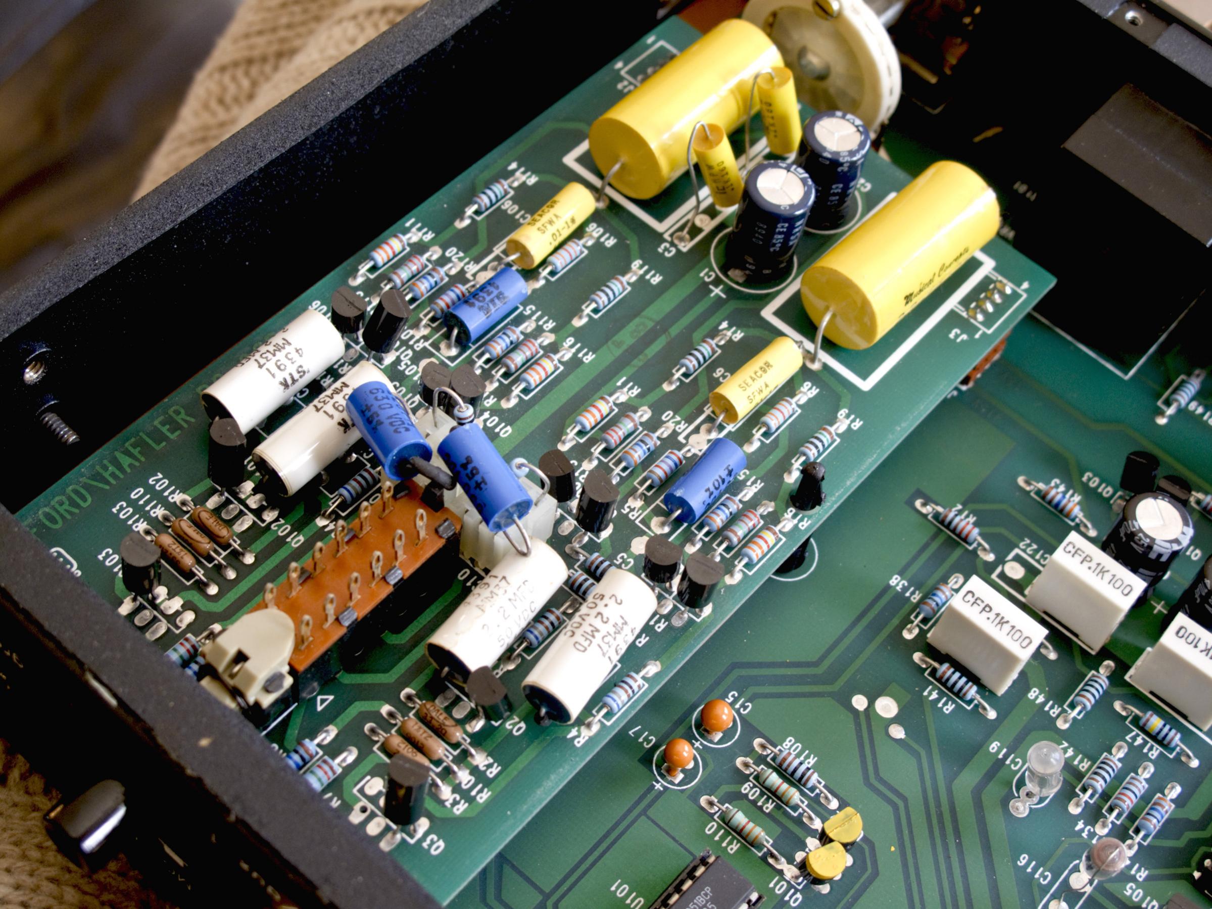

Ok, I'm back with one more question. Here is a photo of my actual preamp (earlier photo is not my unit).
I now see that mine has not been modded like the first photo posted earlier. The 8 other yellow Musical Concept caps populating the other 915 preamp are .1 mfd 100v polypropylene caps (8 of them). I figure if I replace these I may have one of John Hillig's mods to my preamp. He is not willing to sell the parts only and I don't want to invest the $399 he asks for his basic mod. What brand would you recommend to use to make the upgrade?

Interesting, on this site folks talk about the advantages of better caps.
Indeed, and resistors too. The debates run and run. Me... I'm content to choose and use good quality "commercial" grade parts of known provenance. What I look for in terms of sound quality comes more from the circuit topologies I prefer to use.
Hey 😀 but don't let what I say or think stop you from experimenting.

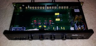

I have an SE100 which I modified with CRC filtering on the stock rails to help decouple the channels from each other. The SE100 design had provisions that allowed rail resistors to easily be installed and the traces cut. I used 8.2 ohm 1 W resistors here. The SE100 was the precursor to the 915 and utilized a very similar line stage circuit, so Hafler might have implemented this feature on the later 915 as well. I looked at the pictures posted of the 915 and I do not see it there from the top, but its possible there might be something on the backside of the board.
I posted a picture of my modded SE100 with the rail CRC resistors installed, for those that have trouble spotting them. They are the 4 larger light blue ones in the center of the board. Two of them are sitting vertically and have their wires soldered together, the other two are laying down horizontally.
