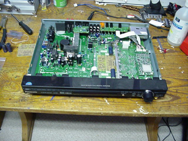

I was very impressed and inspired by hifiZen's NS500V mods in this thread. So I decided to do these on my player--however, I'm using DVP-NC650V, the 5-disc carousel version of the NS500V. Its design is similar but not identical.
For your reference, here are two pictures of the audio PCB:
Labeled photo
Sharper unlabeled photo
So far, I have successfully removed/bypassed C247 and C248 (hifiZen bypassed the same-numbered capacitors). However, I still wonder if I should instead have removed C253 or C254 instead (basically, which caps belong to which Output, #1 or #2)... maybe I should desolder my cap bypasses and see which output gets muted?

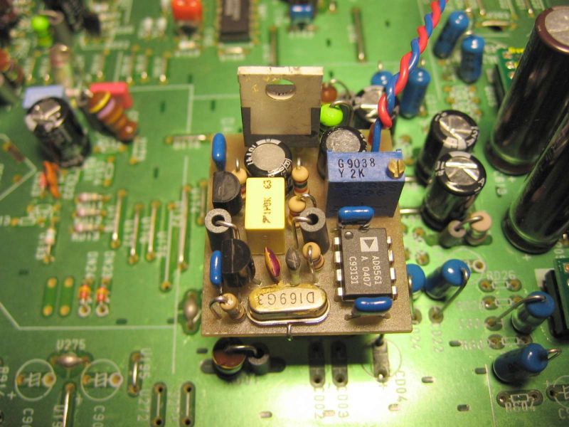

1st mod: new opamp - I replaced the crappy one with an Analog Devices AD8620... very worthwhile! I also added 1uF Panasonic HF supply decoupling caps (no HFQs on hand...).
short out C247 and C248 (47uF electrolytics) output coupling caps with a small piece of trimmed component lead
- bypass R288 and R289 (470ohm each) series output resistors by stacking a 10ohm resistor on top.
- remove muting transistors Q213 and Q214
- remove C280 and C281 (220pF) caps to ground
- bypass R323 and R325 (470ohm) series output resistors with 0ohm resistor stacked on top

Leo,
Thanks for the compliments! So let's see here...
Boy, that analog board looks a lot like the NS500 one! I got the schematics by ordering the service manual straight from Sony... you may be able to do the same, but I don't have a part number for the 650V. The service manual was quite affordable - maybe $30 or so.
AD8620 should be available from Newark and Allied Electronics (both carry Analog Devices, AFAIK), but don't seem to show up on their web sites. You may also be able to get them as samples(?). Actually, if anyone else knows of a good supplier for Analog Devices parts, I'd like to know! You could also use the OPA2134, which should sound excellent here as well, and seem to be easier to obtain.
The mute transistors were removed from the two larger circles shown at the upper right side of the image, near the chassis metal. There was nothing put in their place. The big decoupling caps were actually soldered right in place over the existing ceramic chip decoupling caps... if you look closely you'll see them still there at the ends of the cap leads.
C280 and C281 were located in the circles next to the silkscreen labels C277 and C278. Confused? Me too. I hope I didn't get those part numbers wrong. Anyway, they were a shunt to ground after the series output resistor. From the pics of your board, you don't seem to have these caps, so I wouldn't worry about them.

I just removed what I believed were the mute transistors: Q214 and Q215 as seen in the picture. However, to my surprise I didn't hear any power on/off transients! Just same normal operation. Any way to explain this?
Thanks,
Leo
