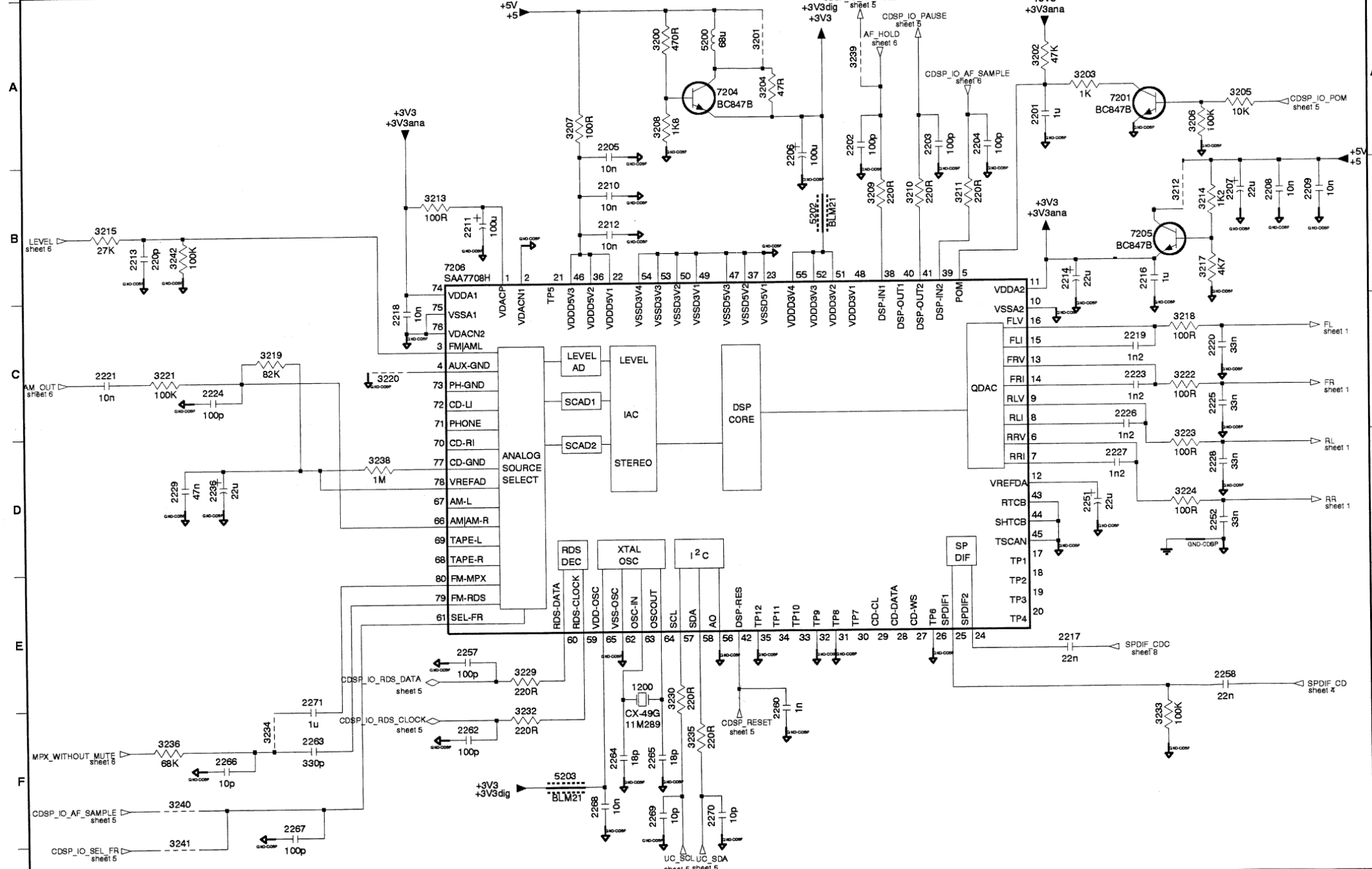

The easy way for me looked like I could just hack another input into the dsp chip.
Looking at it's schematic, the chip has many inputs. The only problem is that the unit does not go through all of the inputs. If no CD is inside the unit, it defaults to radio, and I can only switch between AM/FM. The CD unit inside this player also uses a spdif input on the dsp chip. So no luck there. I would have happily removed the cd-unit but no luck.

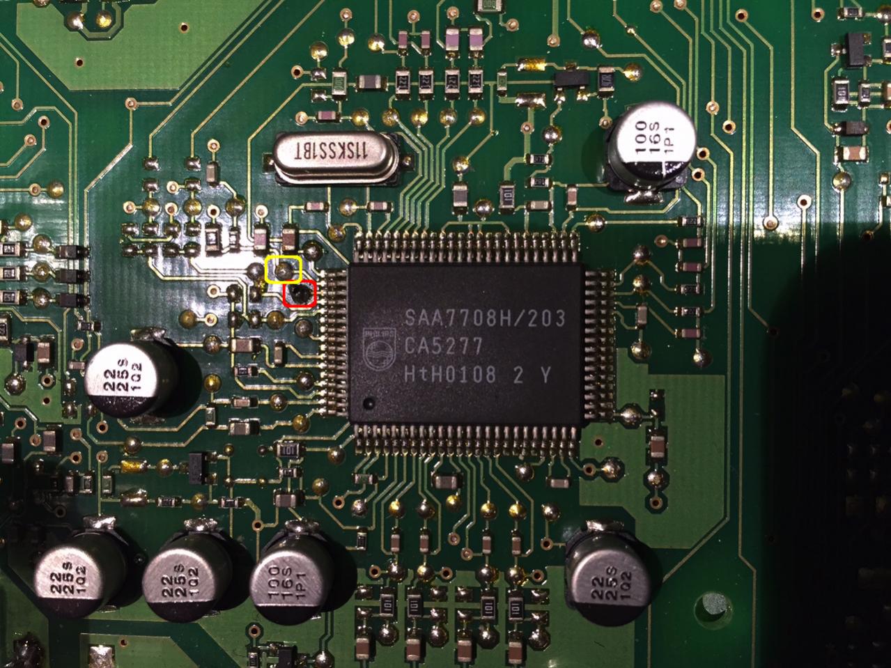

So because the unit talks to the cd-player or cd changer via serial to determine what's happnening, I can only use the two active inputs that are available always. AM and FM radio. I need FM but I don't need AM. So looking at the schematic, I noticed that AM audio signal goes into one pin, the Right Channel/Mono pin. The left channel is floating and is conveniently broke out into a small test pad.
I decided to make a test, and inject another signal on that pin. That way I figured that the DSP detects signal on that pin and starts a stereo output. But sadly that isn't the case. I couldn't get my test signal on either channel.
What else should I do? Is there something that sets the DSP on mono/stereo for AM input?
If my test worked, I could have cut the trace leading to the AM input pin and then inject left/right signal with a plain cable that would go out of the unit to my phone.
Any ideas?
On the picture, I circled with red the left channel (not connected one) and with yellow the active right/mono channel.
Is there another radio signal that tells something to the DSP about mono/stereo? If so, is that signal on the same line with the FM data? I see a line named Level, what does that do?

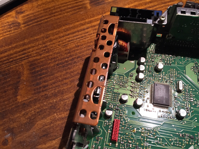

edit: I had a look on the other side of the board, it's two layers and those are not vias, they are indeed pads, or test pads or whatever. They are not going on the other side, so the Left channel AM input is indeed floating. Along with the other inputs.

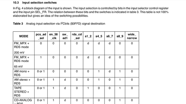

I just saw in the chip datasheet that the mono/stereo is controlled by IC, so no way of activating that.

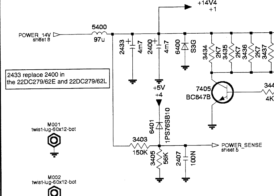

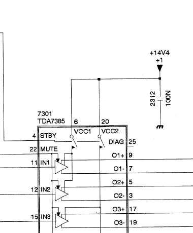

I was also thinking of replacing the amplifying chip to something better (tda7850 from tda7385) but the heatsink is really small.
I need to rethink this.
What bugs me is that a different head unit would kill my remote controls and dash display.
There are adaptors for the controls, and they are around 30$, there are also adapters for the display, but those are 130$.
Increasing the amplifier might destroy the PSU.
You could consider adding an aftermarket amplifier and adding in the aux input between the two.
There is nothing to be destroyed. Maybe the filtering inductor? But let's calculate:
TDA7385 is a 4x23W device at 14.4V (at 10% distortion, that's at max, and I wouldn't listen at that volume). So that translates into 4x1.6A = 6.4A.
TDA7850 is a 4x30W device at 14.4V (same 10% distortion) That is 4x2.1A=8.4A. At max volume with the more powerful chip I would have a total extra increase of 2A, that is continuous. I guess the inductor can handle it, especially as I'm not going to max it.

edit: Forgot to add the schematic
