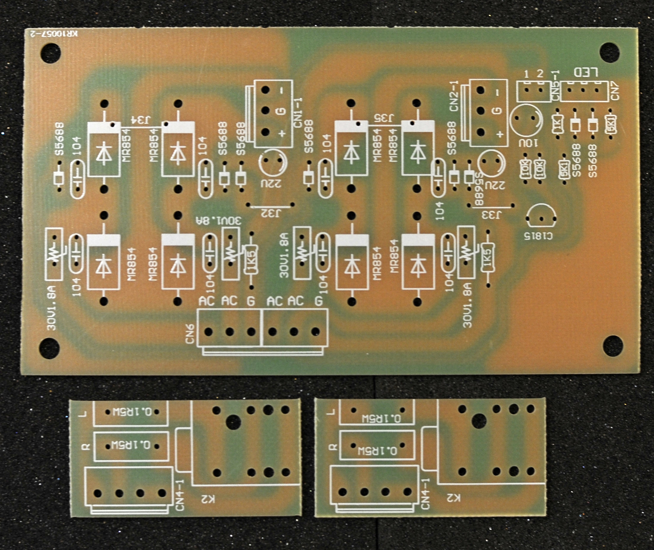

AT-HA5000 or HA2002 are headphone amp made by Audiotechnica, Japan.
They have a lot fans, and many clone project.
However, some of the data are lost and invalid for years, I think it's time to make a review and collect what we can find on the internet.
HA5000/2002 uses UHC(Ultra High Current)-MOSFET, Hitachi 2SK2955 and 2SJ554 complementary pair, which are rated 60V/45A.
HA5000/2002 are relatively easy and safe to build, as a headphone amplifier, they don't require huge power; actually, the supply rail volt is only +-18V and you can get very decent soundstage.
There is also a clone project in 2012-2013 in Hungary if I remember right. Just call it HA2012 project. The HA2012 project is basically the same as the "traditional" clone, but it uses uPC1237 as protection which greatly reduces the complexity compared to LM393 comparator solution that Audiotechnica adopted.

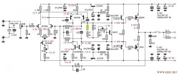

Many clones claim to be 1:1, but in my experience, I don't really like the LM393 comparator protection solution: more parts, more complex, more failure rate.
As 2SK2955/2SJ554 are hard to find spice models and hence simulate the HA5000, DIYAudio member EUVL shares his LTSpice files to simulate HA5000 with other MOSFET models.
EUVL also indicated that:

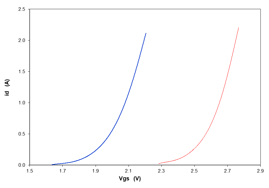

I finally found some time to measure my 20 pairs of 2SK2955 / 2SJ554 bought from Japan some 10 years ago.
As you can see they are not truely complementary.
The NMOS (in red) has higher Vgs but somewhat lower Yfs (at 1.2A).
But they more or less compensate with each other if you make allowance for that in circuit design.
Extremely thermal sensitive, just like 2SK3497 / 2SJ618 so some bias control is a must.
Transconductance at 1.2A is > 10S, almost double that of the Semisouths.
If you can tame them thermally, they will drive anything.

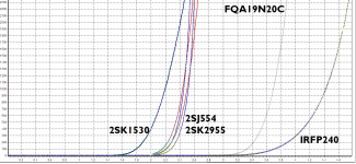

Member ripson shares his curve tracing results of desoldered 2sk2955 and the comparison with 2sk1530.

By the way, I also bought some cheap desoldered 2SK2955/J554 from China, and traced their curves, suprisingly they seem to be genuine K2955/J554, at least they can work normally and their curves are silimar to the genuine Japan ones.

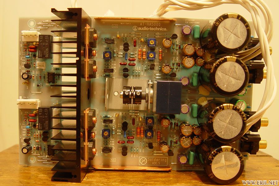

The thermistor is located under the PCB, near power MOS.
It's said to be 470R, really?

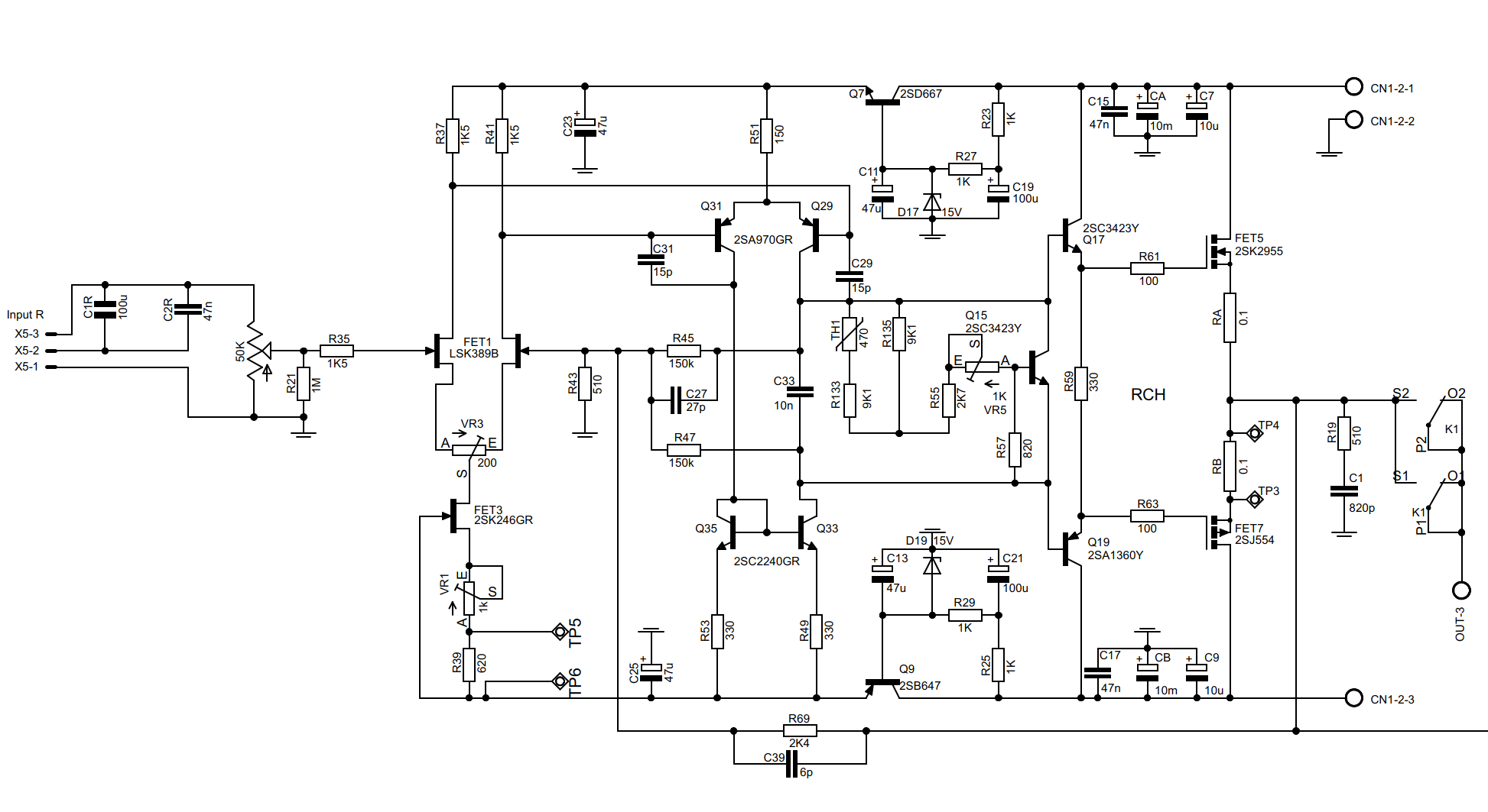

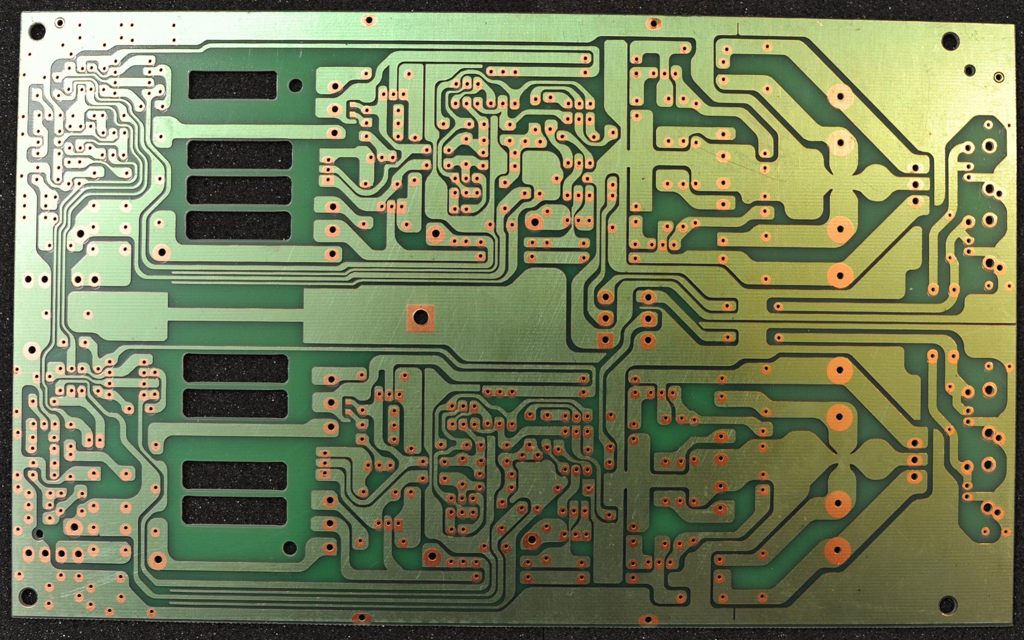

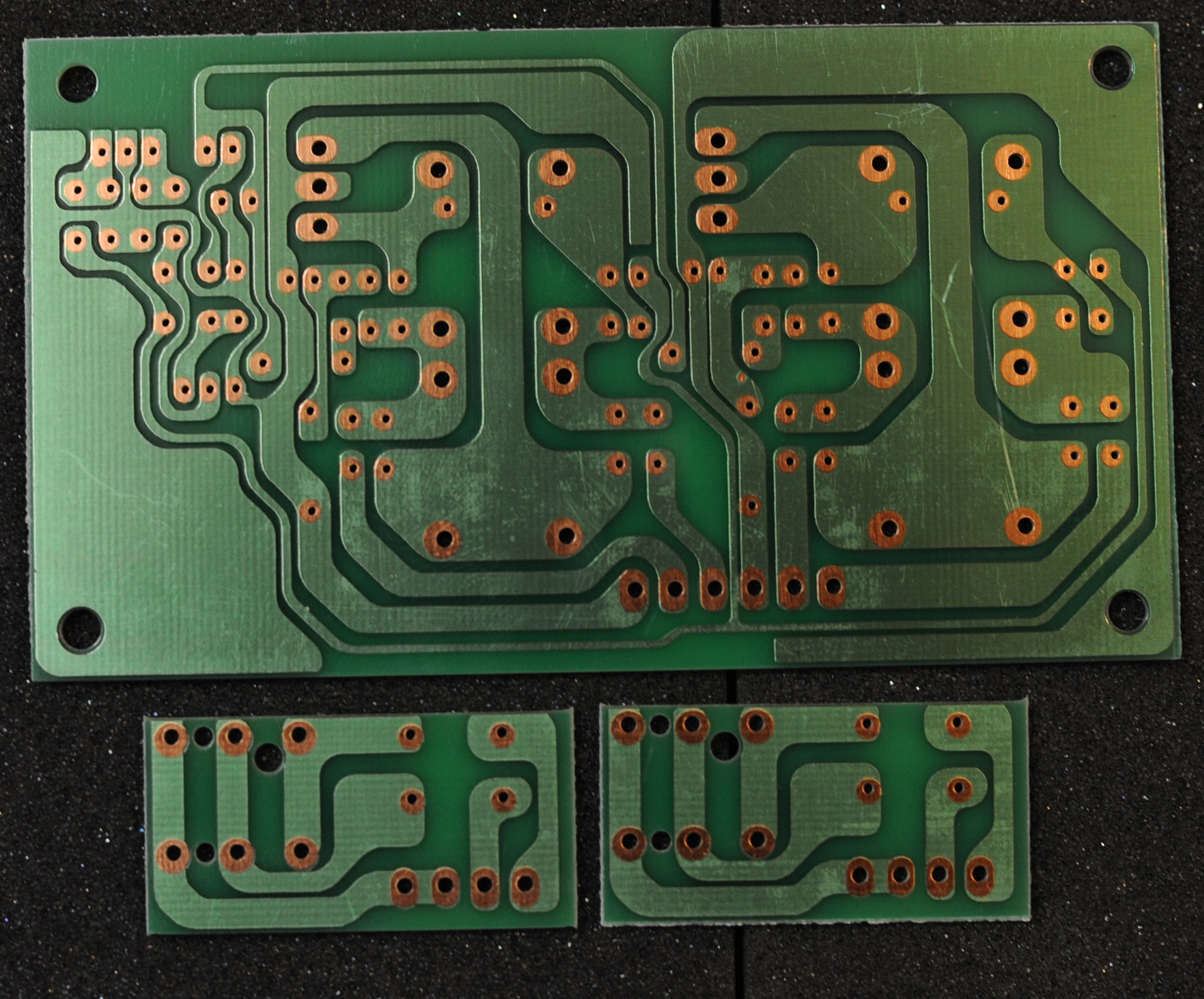

The schematic and board layout of HA2012.
Very nicely done.
A) Any way to convert it into GERBER file?
B) What is the exact model of 470R thermistor?
Since UHC-MOS is highly sensitive to temp, thermistor must have adequate temp co. to compensate the change in temperature. So, what is the coefficient of thermistor?

AT-HA-5000 schematic

i'm new here and i'm looking for a class a amp project to drive my 600ohm cans and i thought building the clone HA5000 is a better experience than buying pre assembled i hope i can attempt to build this thing
(also if there's a better headphone amp project please let me know )
What does "better" mean for you, what criteria to compare ?
For 600R phones, you do not need such power devices and high bias current.
You need higher rail voltage instead.
See for example Borbely EB602 with 24V rails with low bias :
https://audioxpress.com/article/a-battery-powered-class-a-headphone-amp
https://pearl-hifi.com/06_Lit_Archive/14_Books_Tech_Papers/Borbely_Erno/Borbely_on_Line_Amps.pdf
(EB797, which is a tube version of EB602)

Then HA5000 is definitely the wrong choice.
Component for this one is easier to source :
https://audiodesignguide.com/Headphone_amp/headphoneamp.html
Patrick
