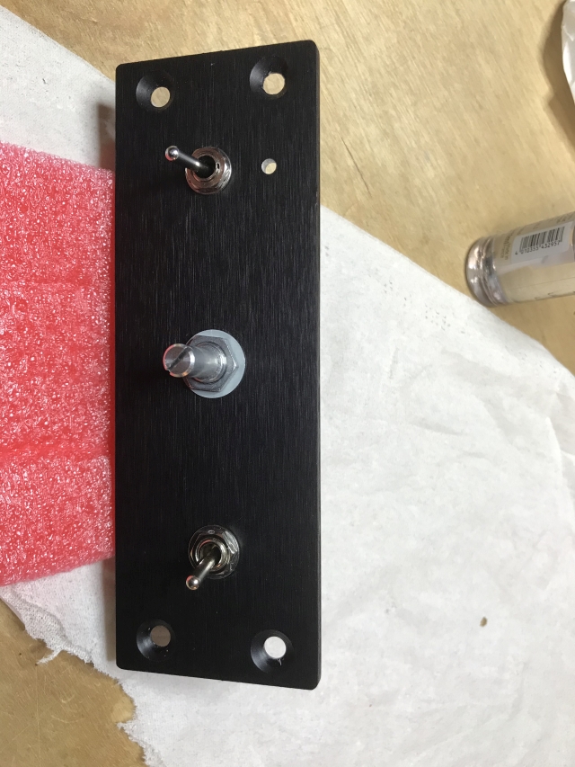

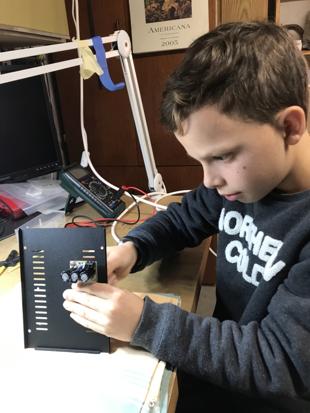

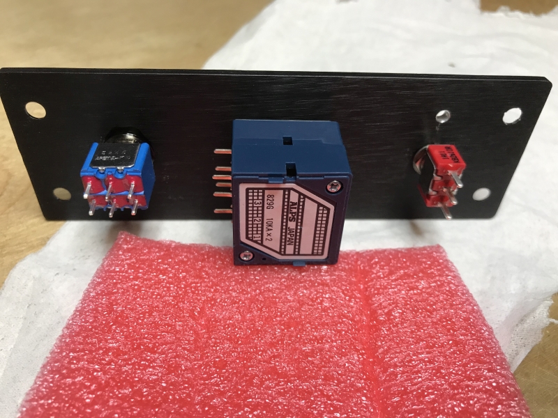

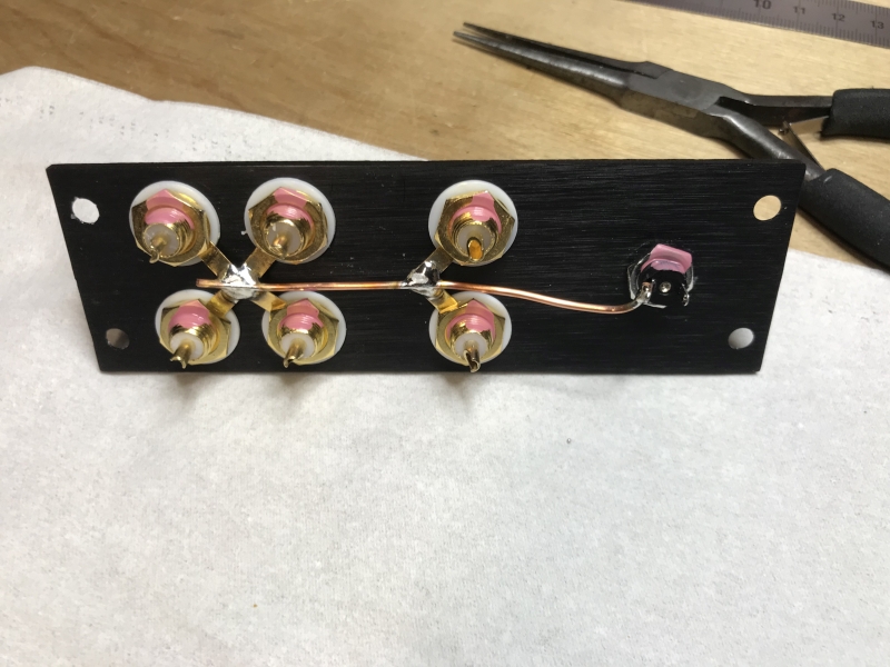

What follows is a pictorial documentation of the H2 preamp build. I bought a small Galaxy case from Modushop, a 10k ALPS pot, two switches, and a few RCA sockets.

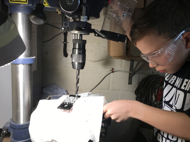

I guided my son mostly in layout and the steps of mechanical construction he hadn’t done before, but the actual construction has almost exclusively been his work. In the final assembly, basically the one thing I did was dressing and soldering the very fine signal wires between sockets, switches, and pot.

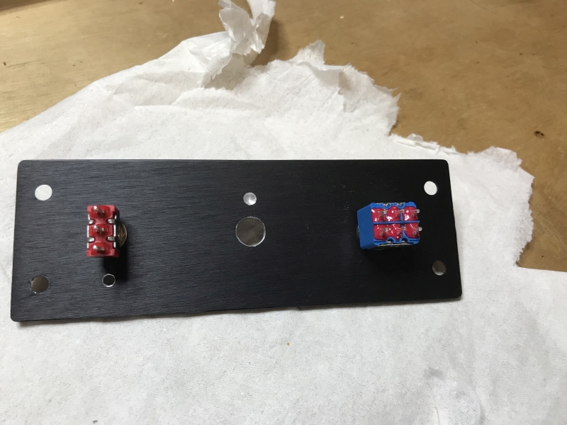

Here's the first step - marking, drilling and pre-assembling the chassis.

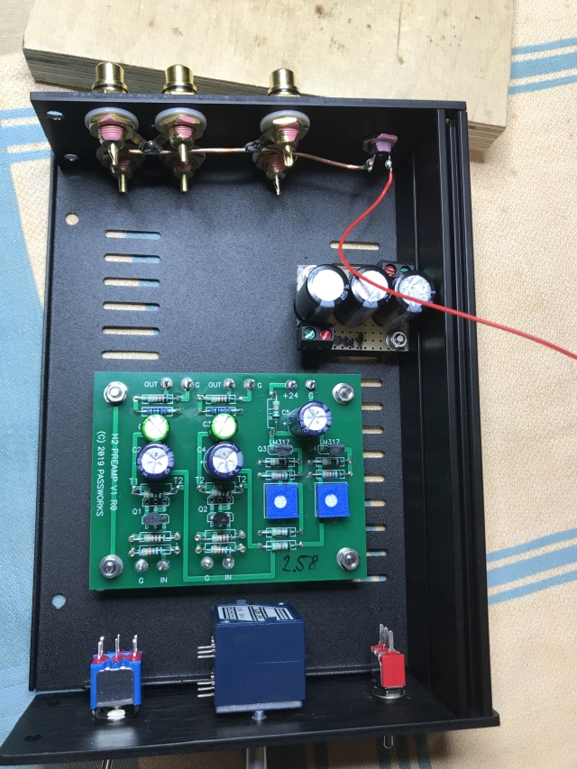

H2 as a preamp – build documentation – part 2 – the H2 board

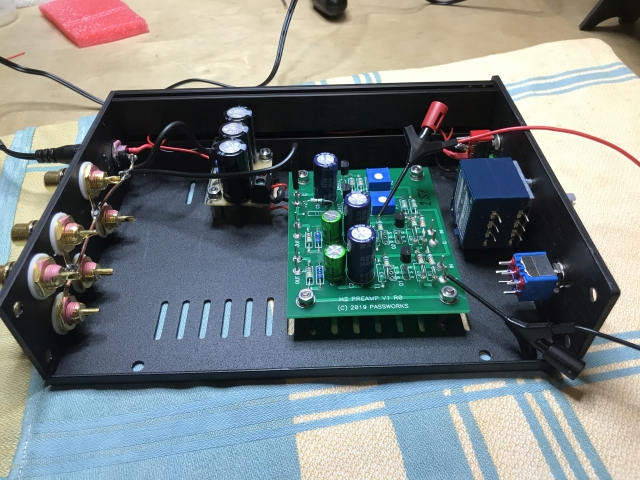

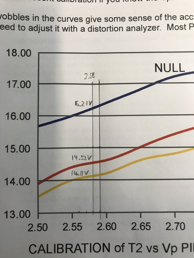

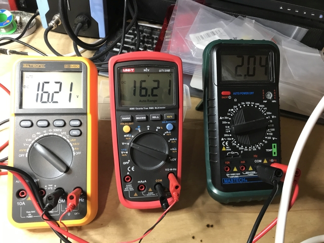

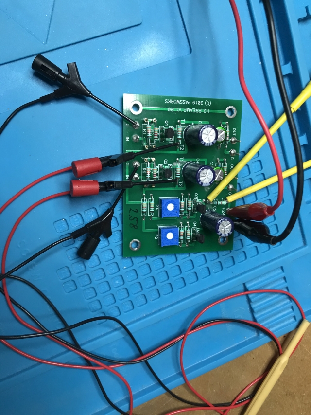

Besides soldering the H2 board, in this step we also set the voltages according to the calibration curves Nelson provided in his H2 article. Our set of JFETs was marked with Vp = 2.58V, so we set the rail voltages to 16.21V for minimum distortion to start with.
R11, R3, and R8 were raised up from the board, because a quick power dissipation calculation indicated they would get warm. (In use, R3 and R8 indeed get warm, as well as the JFETs to a lesser extent, but R11 not really)
Also, following a hint from Nelson in the H2 thread, we provided sockets for R1/R2 and R6/R7 to modify the gain of the H2 (operated now with inversed resistors, 33k for R1 and 3k3 for R2, to lower the gain).

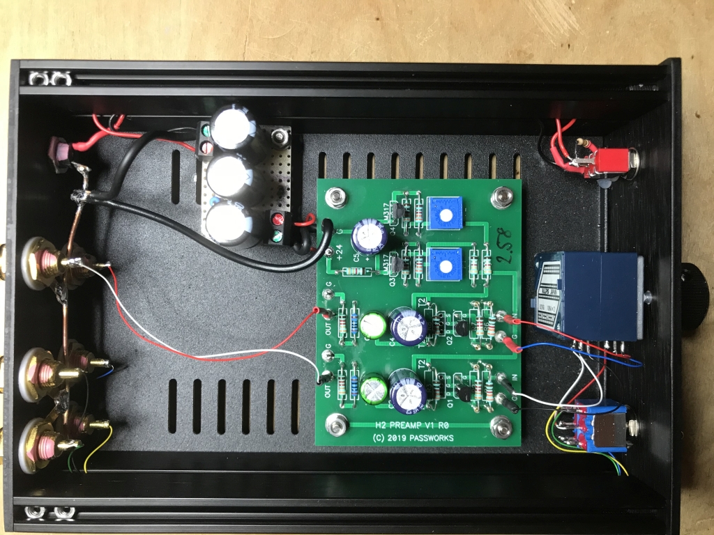

H2 as a preamp – build documentation – part 3 – assembly

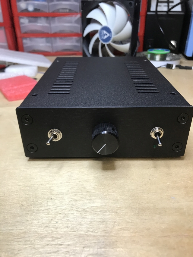

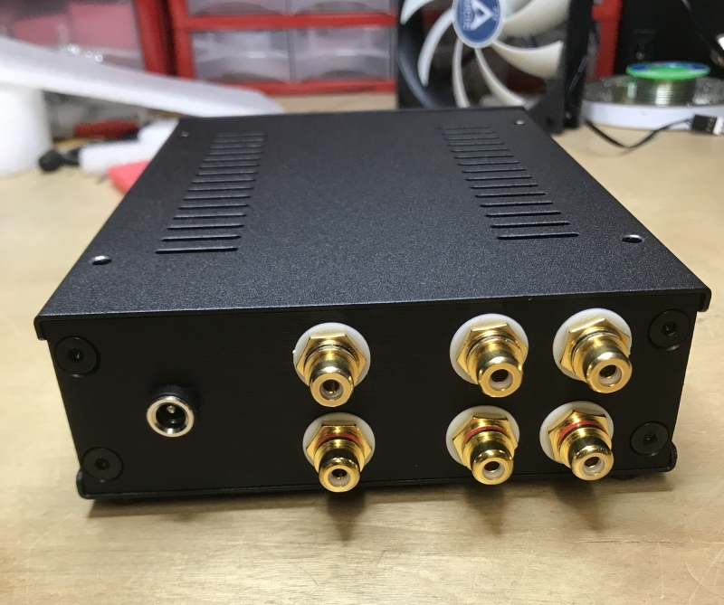

Here is the actual assembly of the boards into the chassis and wiring it all up.
As stated, the only task done by me was dressing and soldering the very fine signal wires (Kynar wire; a tip from Zen Mod) to the sockets and switches / pot, because those are somewhat sensitive to heat from the soldering iron ...

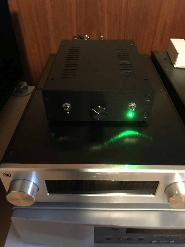

H2 as a preamp – build documentation – part 4 – first listening impressions
We have tried the H2 preamp in the "main system" for now, because the remainder of the hi-fi systems for the boys isn't built yet.
The H2 sounds absolutely fantastic, in our case we love it in the clean, lowest distortion setting ...
Great bass, too - my son comments that the bass is not only great, but sounds very realistic also ;-)
It seems to have a special synergy with my EL84PP amp, where it seems to provide more "swing" and "feeling" than my Wayne BAF 2018 preamp. Better bass than the BAF preamp, as well. Maybe a bit less transparency, but in this combination barely noticeable. I have set the H2 to lower gain by swapping R1 and R2 resp. R6 with R7 to better match with the high-gain tube amp. I have tried the H2 at the 1% distortion setting as well, but gone back to the "clean" setting, as with the enhanced THD setting the sound somehow lost its "magic". (tried with both polarities of speaker cables at the amp output) I find this interesting, probably needs more examination. The EL84PP at the power levels used is at 0.1% or less H2, and even less H3 ... 😛
