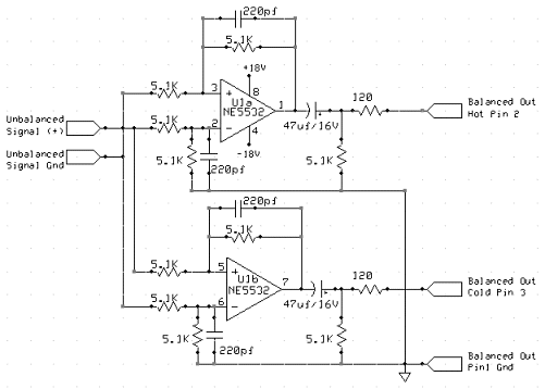

unbalanced preamp
I would like to convert the unbalanced signal from my preamp to an balanced one. What is the best schematic ?, are there better ones ? It is for the Aleph 5
Re: unbalanced preamp
You actually might like to consider building the BOSOZ preamp. It's an easy circuit and handles balanced/unbalanced conversions very nicely. There are also less components in the signal path.
The level of effort would be roughly comparable. With a little more work there are the other BOSOZ variants with X topology and CCS.
-David

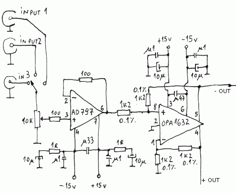

If you want to do it with OpAmps and DiffAmps here is the one that I used few times. This one might not be the best, but it won't be easy to find a better sounding one. 🙂
First chip is just a buffer and there's a plethora of good circuits to choose from, though it should be capable of driving a low Z input of diff. amp - OPA1632 - here you can also use the THS4131 (same pinout as OPA1632) or any discreet circuit you like - you'll find a lot of them on this forum.
