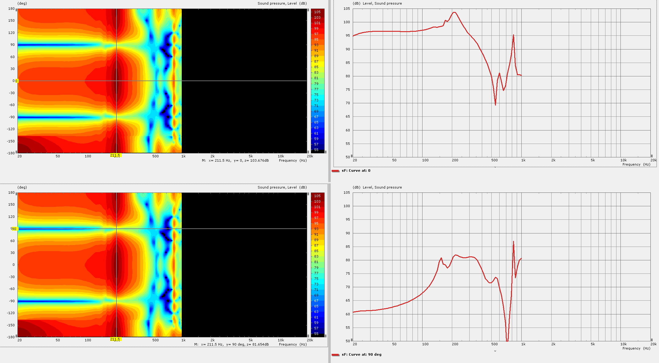

I made simulation of H-frame (https://www.hifizine.com/files/2012/03/H-frame.png) and W-frame (https://www.hifizine.com/files/2012/03/Linkwitz-W-frame.png) in Akabak 3.
Both had frame depth 30+30 cm, double SB34NRX75-16 speakers in push-pull configuration, equalized in same way but results are significantly different.
Is W-frame force cancellation and smaller height better than H-frame higher response level, better on axis and polar plot responses?
In H-frame push-pull configuration distortions are partially compensated.
I presume in W-frame distortions are not compensated as much as there are different volumes (and air mass) on front and on back side of the speaker cones and speakers had direct pressure influence on each other.
What you prefer to build?
Or better is something in between like M-frame push-pull: https://www.hifizine.com/files/2012/12/M-frame-pp.png

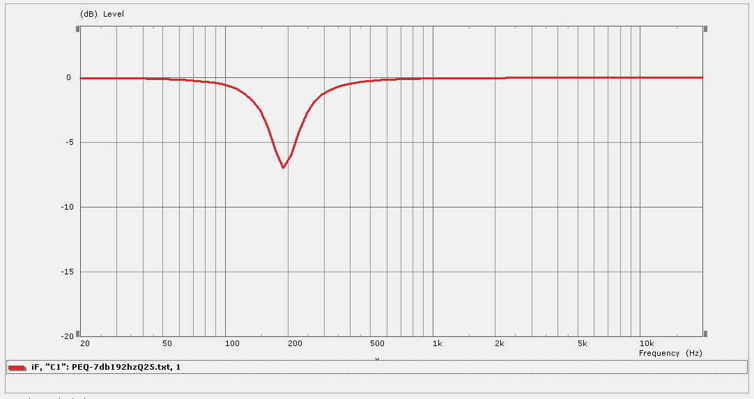

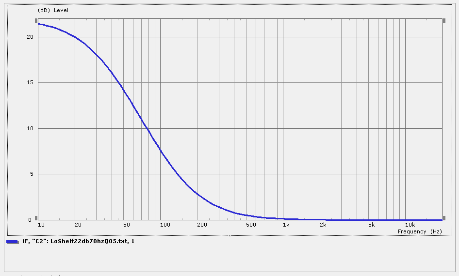

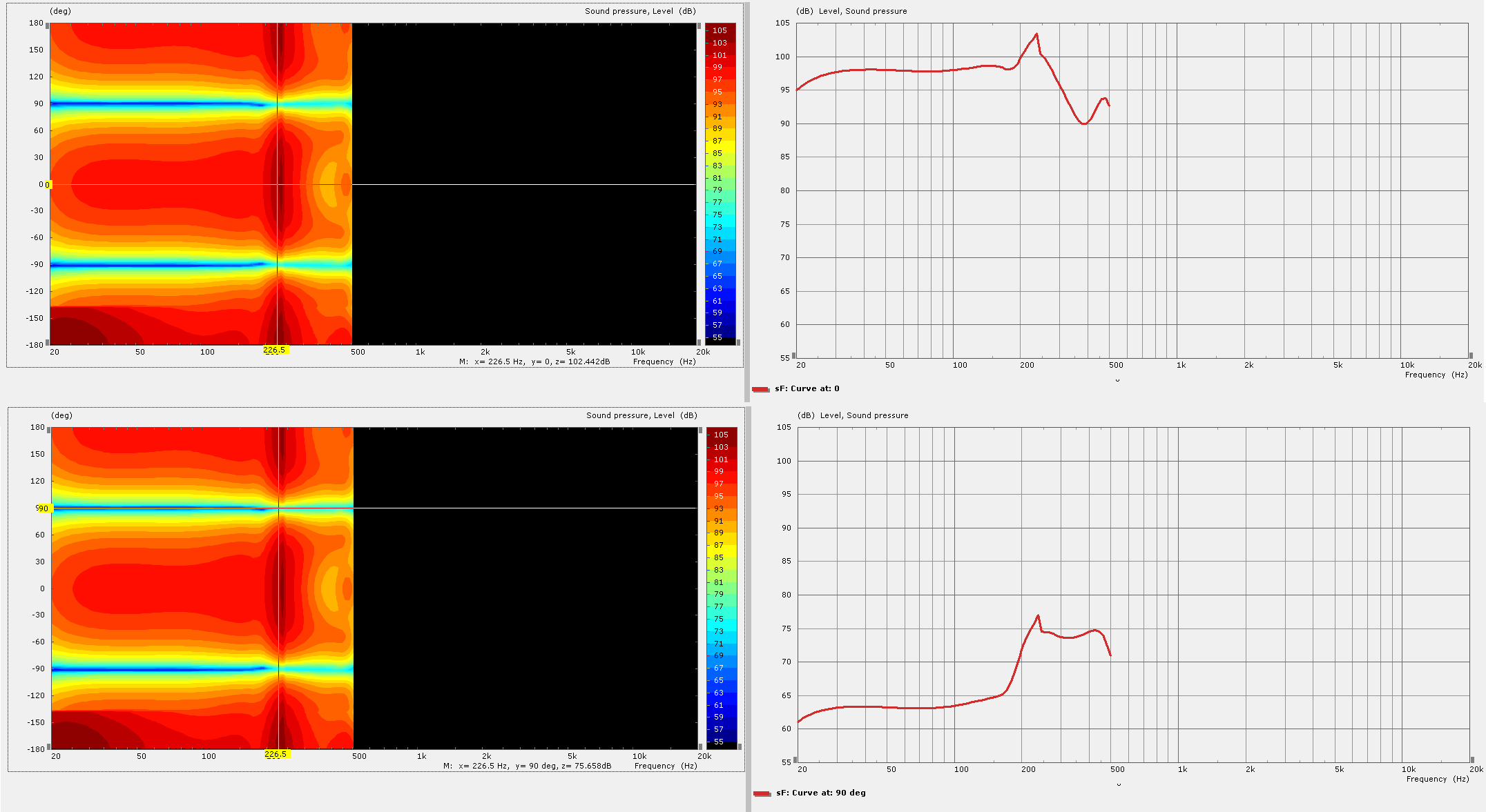

Images are: 1. Low shelf bass compensation, 2. Dipole peak EQ, 3. H-frame on axis and 90 degree responses and full polar plot (Akabak had some bug in polar plot in -150 - -180 region) 4. same for W-frame.

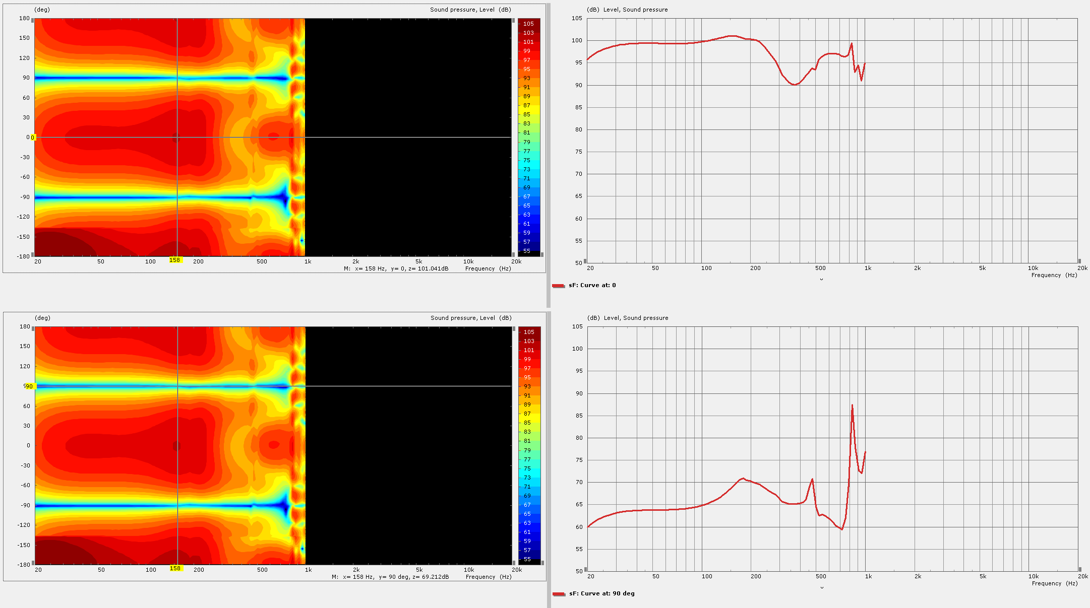

Here is M-frame, exactly same outside measurements as W-frame, speakers are on baffles with 90 degree angle, height is 66 cm. H-frame had height of 82 cm as speakers did not fit to smaller size.
Seems like different dipole peak shape can be caused by different cavity size.
But still question remains, how important is force cancellation and front-rear cavity symmetry for distortion cancellation?
For M-frame version is also not possible to get front-rear cavity symmetry as is possible for H-frame.
With simulations I noticed that for good polar plot is essential to place speakers precisely in the middle of frame. Even small inaccuracy give significantly not symmetrical rear/front patterns.
Very interesting sims. First to answer your questions:
M- or W-frame will not have very good vibration cancellation. Even order harmonic cancellation will only be approximate due to a variety of factors.
Both H-and M/W frame will have close to the same front and rear responses. This depends somewhat on the driver frame/magnet and how much larger the frame is compared to the driver.
I like to build large H-frames. By large I mean both with a large D (front to back distance) and a large mouth opening. My latest measures about D=1m and the mouth is about 0.6mx0.6m. It's size is like a modest table, and I locate it between the speakers and use it as the stand for a heavy multichannel amplifier, on top of a slab of granite. The added weight helps to anchor the unit and acts against vibration. The reason to choose this size is that the front and back tunnels form resonances (as your sims show) and the Q of these is dependent on the aspect ratio of the tunnel (width to depth ratio). A long, narrow tunnel will have a high Q resonance. In contrast as you made the tunnel wider/shallower the Q goes down. A ratio where the mouth width is about 0.5*D gives a relatively low Q that allows you to incorporate the resonance peak into the passband to some degree. This helps to extend the passband upwards as much as possible while at the same time minimizing dipole losses at low frequency. I choose D and then set the mouth opening following the rule I mentioned above. You can put any size driver into this H-frame as long as it will fit inside.
Getting back to your sims, I think these are interesting because they show the 90 degree response coming up near the resonance peak (above 100Hz) much more than I expected. This corresponds to what I have "heard" with my own H-frame as well as with Linkwitz's LS521 M-frame: they can be very "warm" in the midbass. Because you hear the power response of the bass for a dipole, if the 90 deg response comes up so will the power response compared to below the resonant peak. For the H-frame your sims show this rise to be about 6dB, and some EQ would need to be employed to reduce the power to that region to eliminate the coloration.
