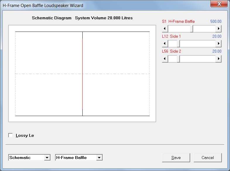

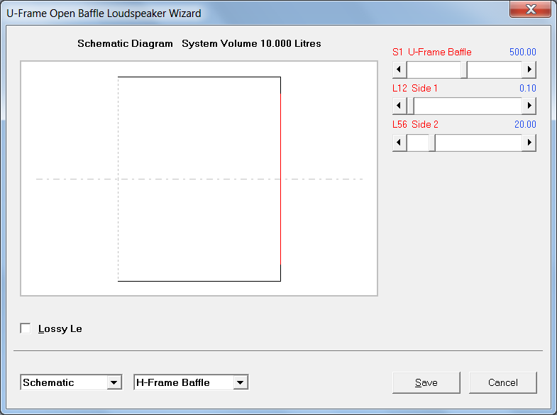

I am thinking of repurposing some vintage speaker cabinets that measure 25”h x 16”w x 12”d to make a couple of subs to go with my LXminis.
I already have 4 GRS 10” subwoofer drivers that perform pretty well in a W frame configuration which is the sub section of 3 way open baffle speakers I built some time ago.
I’ve already cut out the baffle of the vintage cabinets. Are the dimensions of the cabinet suitable for a U frame or H frame set up using the 4 GRS drivers?
Stay safe
Peter
See attachments - red is driver, black is baffle.
The first system looks like the letter H rotated through 90 degrees, and the second looks like the letter U, also similarly rotated.

H frames have the resonance occur at a higher frequency, which is good.
H frames have symmetrical front and rear output, which is good if a dipole dispersion pattern is what you are after.

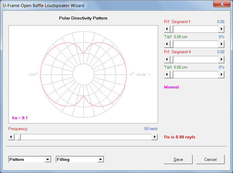

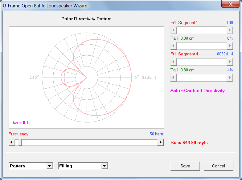

When the cavity is damped, U frames have up to 6 dB more sensitivity and the dispersion pattern is somewhat cardioid.
An undamped U frame is cardioid nor dipole. I guess it is closest to dipole.
As shown in Attachment 1.
As shown in Attachment 2.
As shown in Attachment 3.
