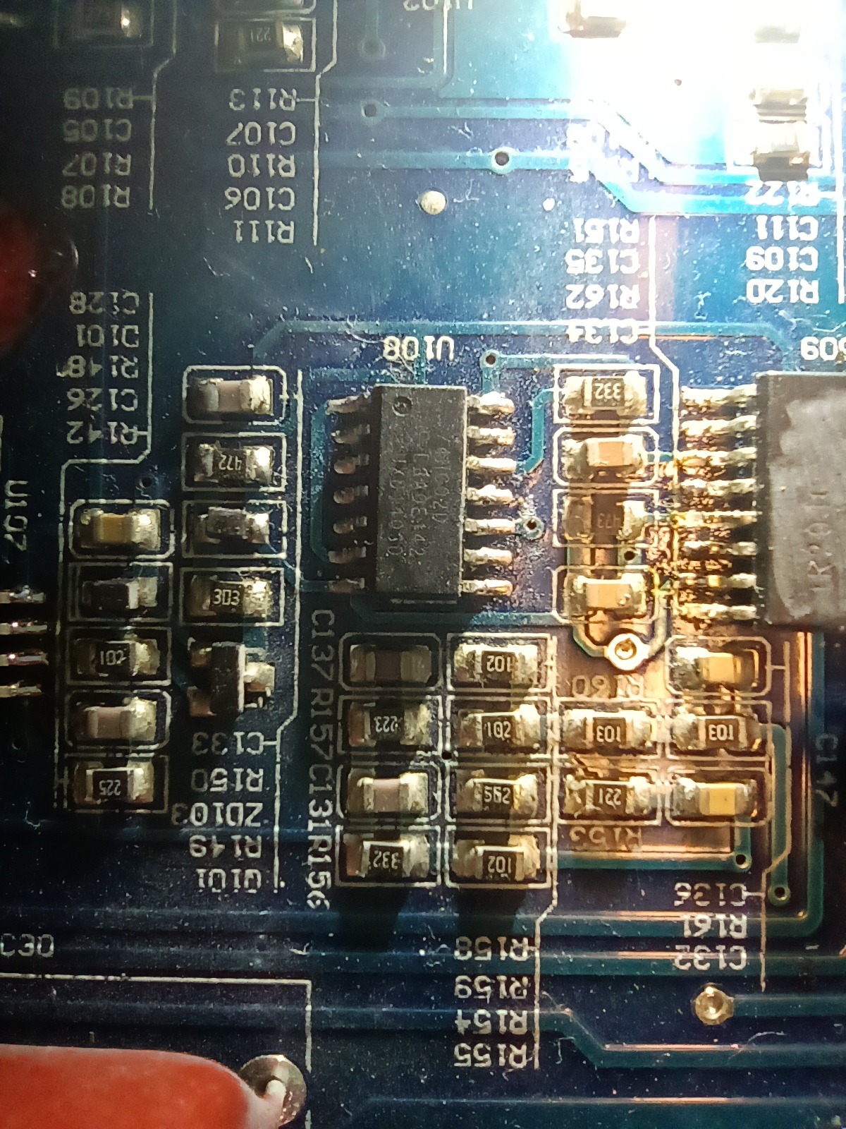

74HC02?
Voltage on all terminals, negaitve rail as the reference.

Pin 1: 0,00
Pin 2: 1,01
Pin 3: 1,01
Pin 4: 0,00
Pin 5: 0,00
Pin 6: 0,00
Pin 7: 0,00
Pin 8: 0,00
Pin 9: 0,00
Pin 10: 0,00
Pin 11: 0,17
Pin 12: 0,00
Pin 13: 0,00
Pin 14: 0,17
Pin 2: 1,01
Pin 3: 1,01
Pin 4: 0,00
Pin 5: 0,00
Pin 6: 0,00
Pin 7: 0,00
Pin 8: 0,00
Pin 9: 0,00
Pin 10: 0,00
Pin 11: 0,17
Pin 12: 0,00
Pin 13: 0,00
Pin 14: 0,17
It doesn't appear that the power supply is running. What's the DC measured across pins 4 (black) and 8 of U107?
Pin 14 of the 74hc02 should have supply voltage.
Measure the DC voltage on U107 pins 4 and 8 again, using the secondary ground as the reference.
How did you get only 14v across 4 and 8 when you read ±14v on those terminals?
Do you have 12v (referenced to the negative rail) on pin 11 of the driver IC?
