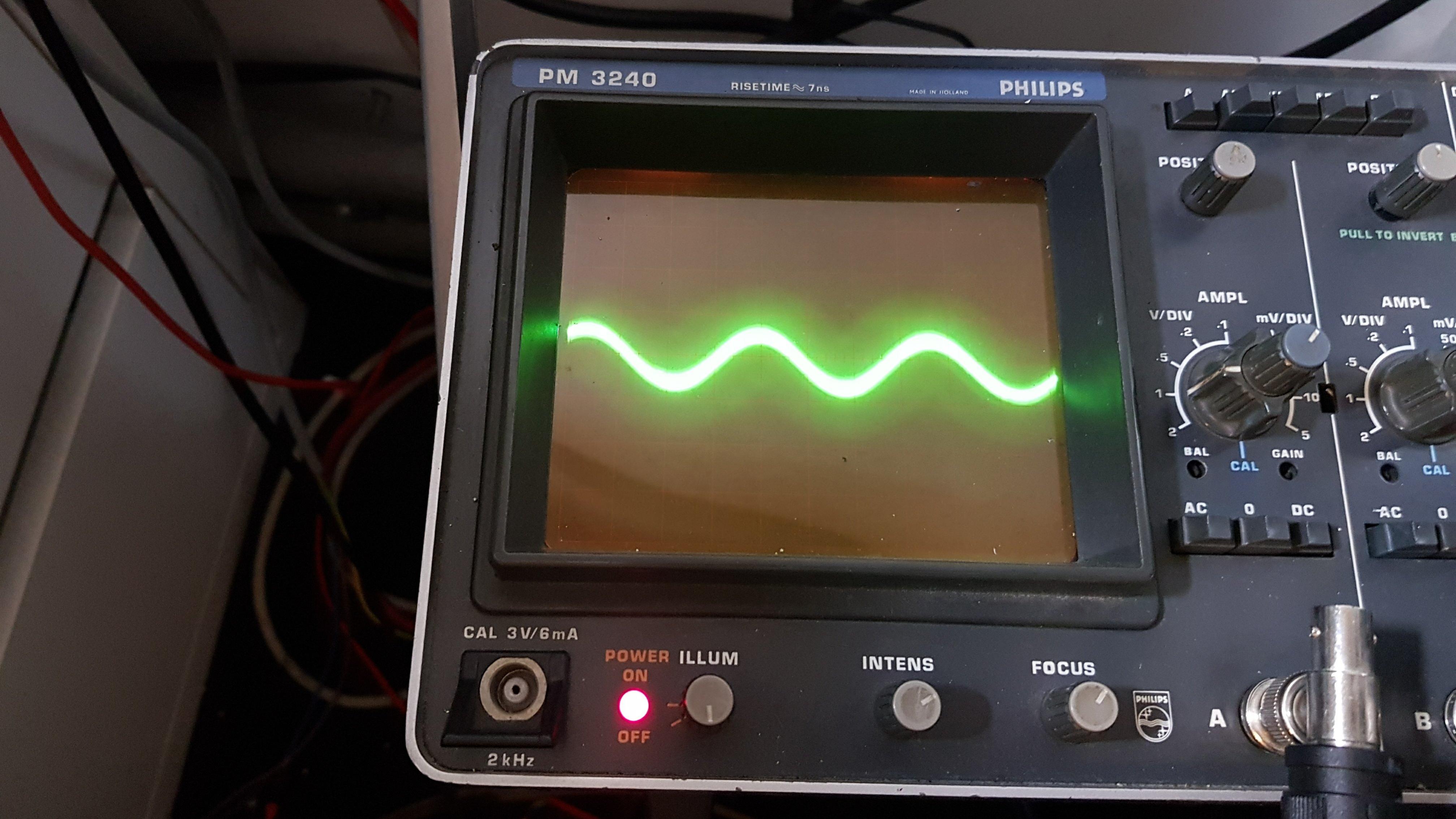

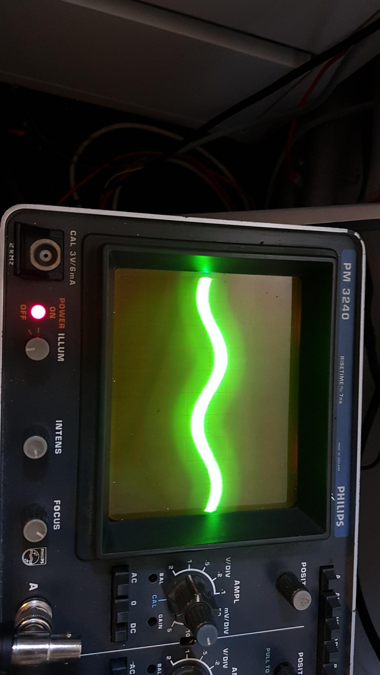

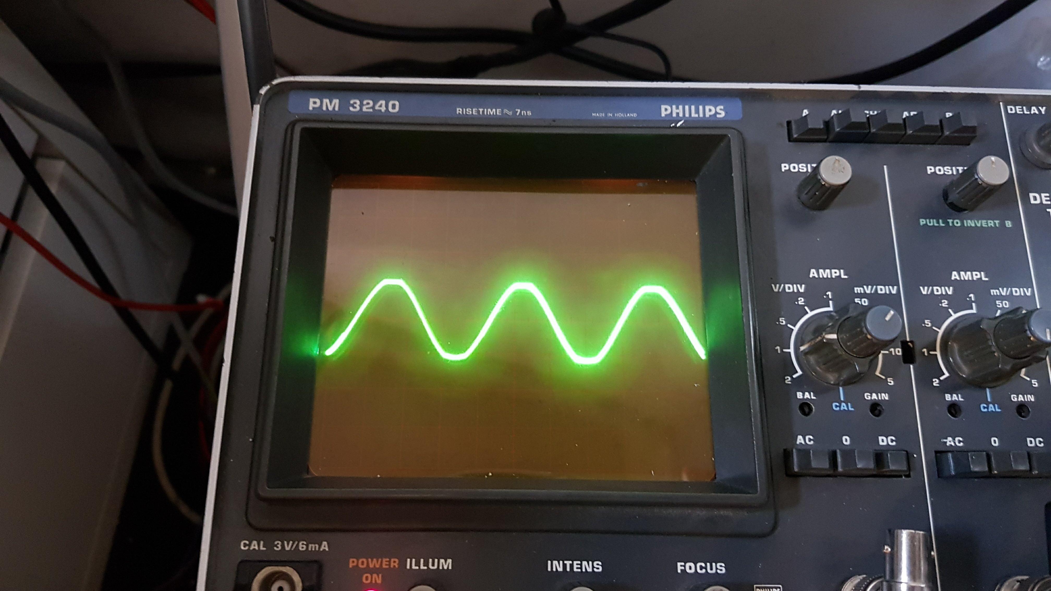

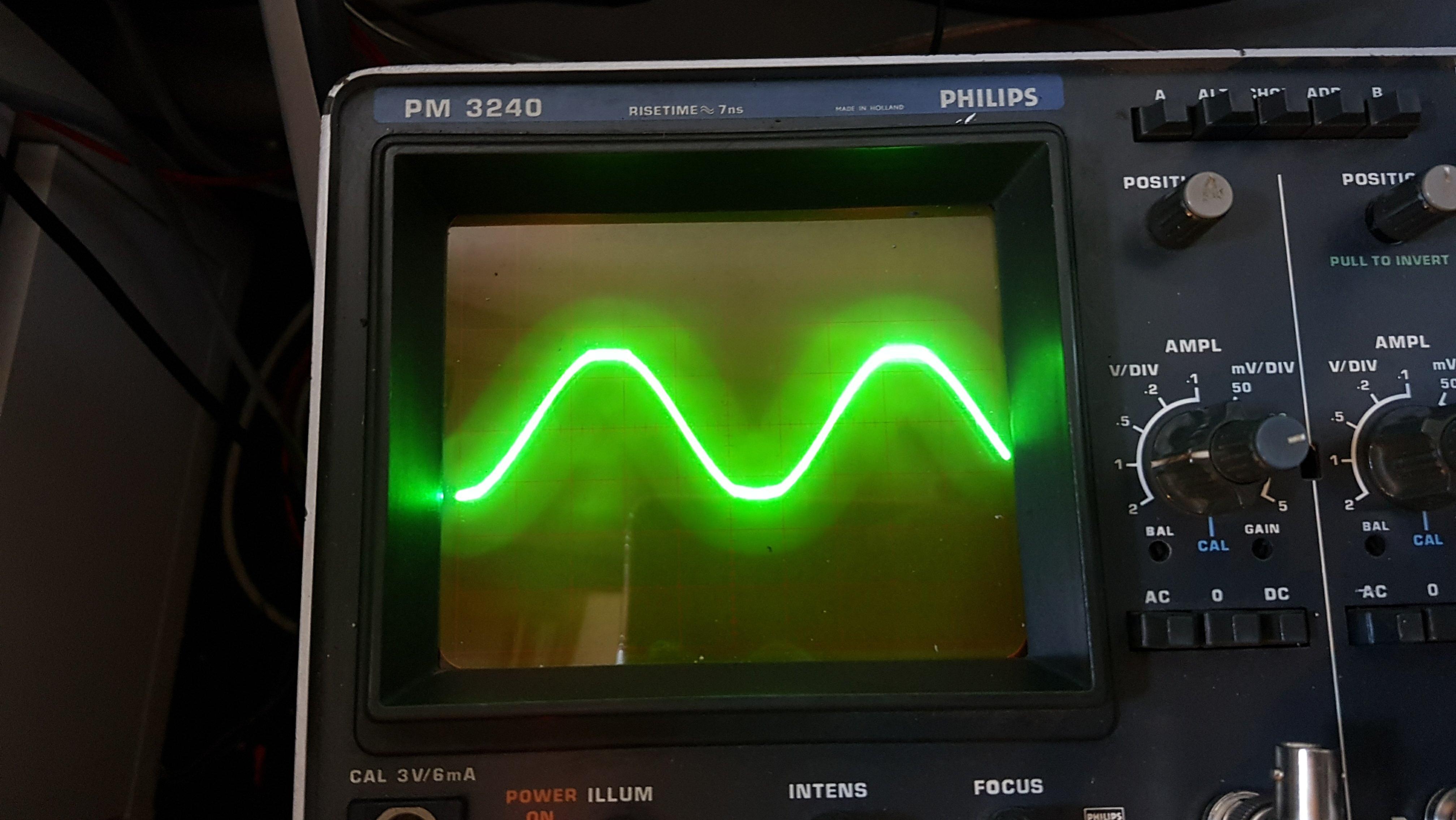

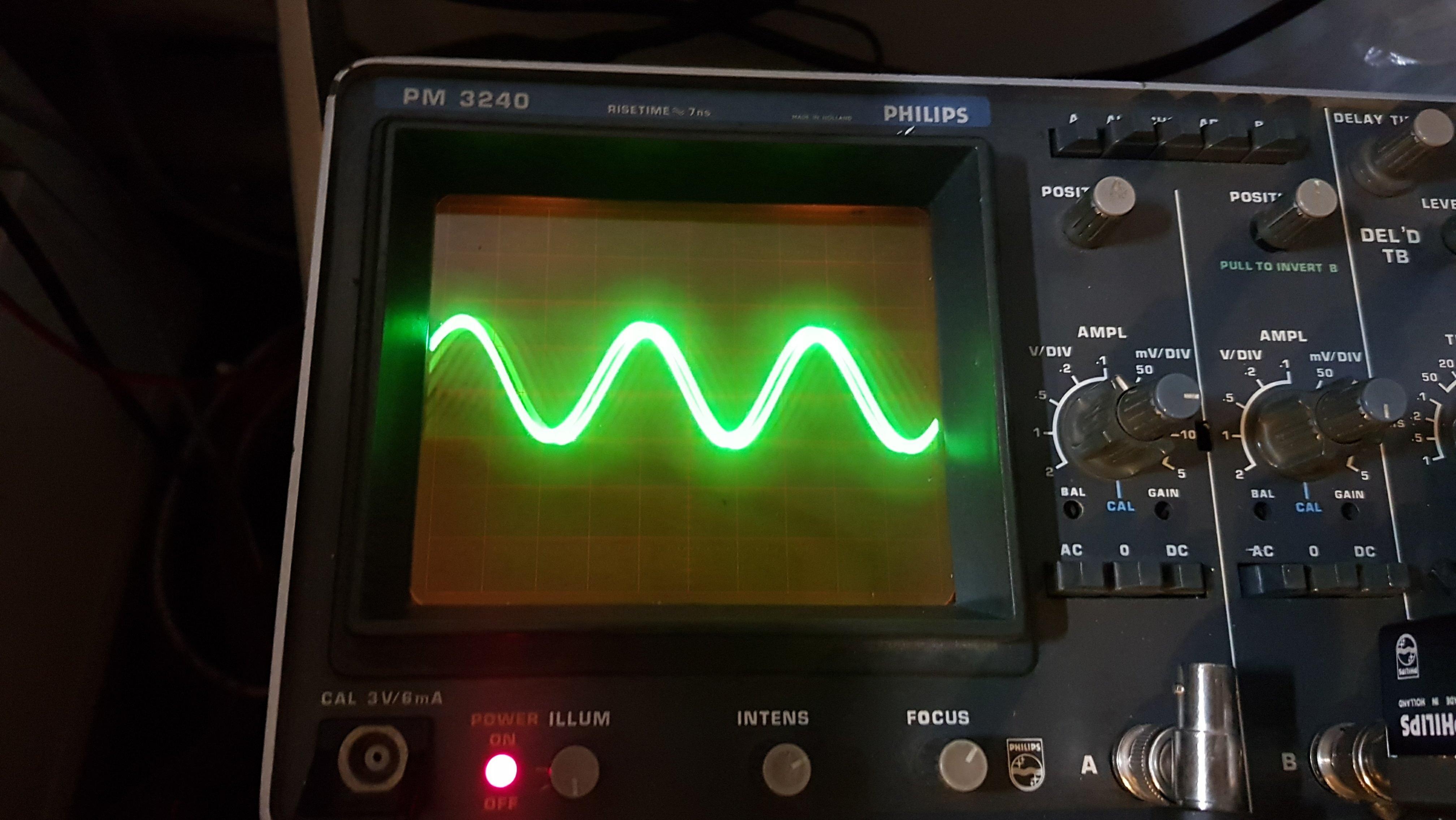

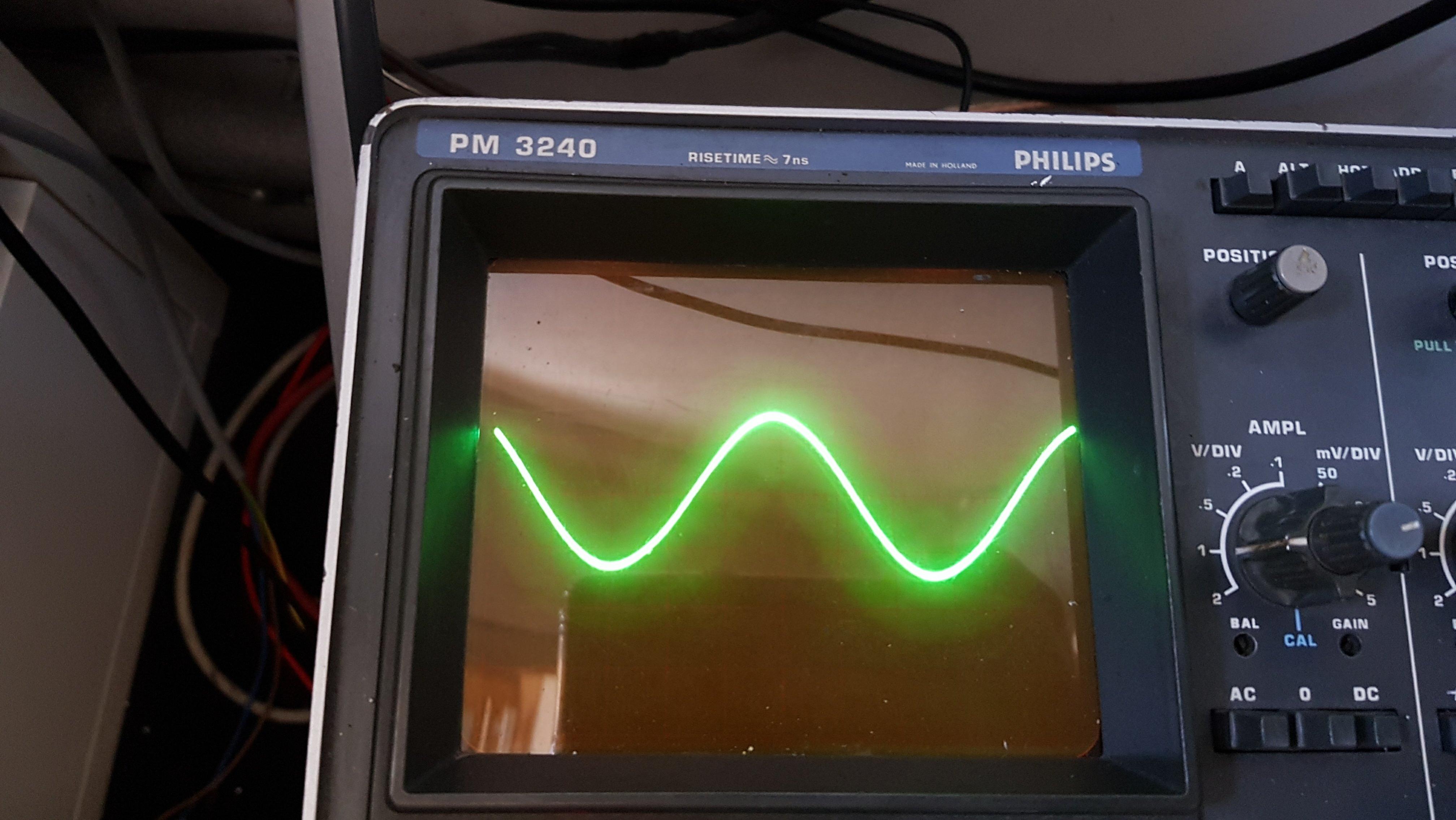

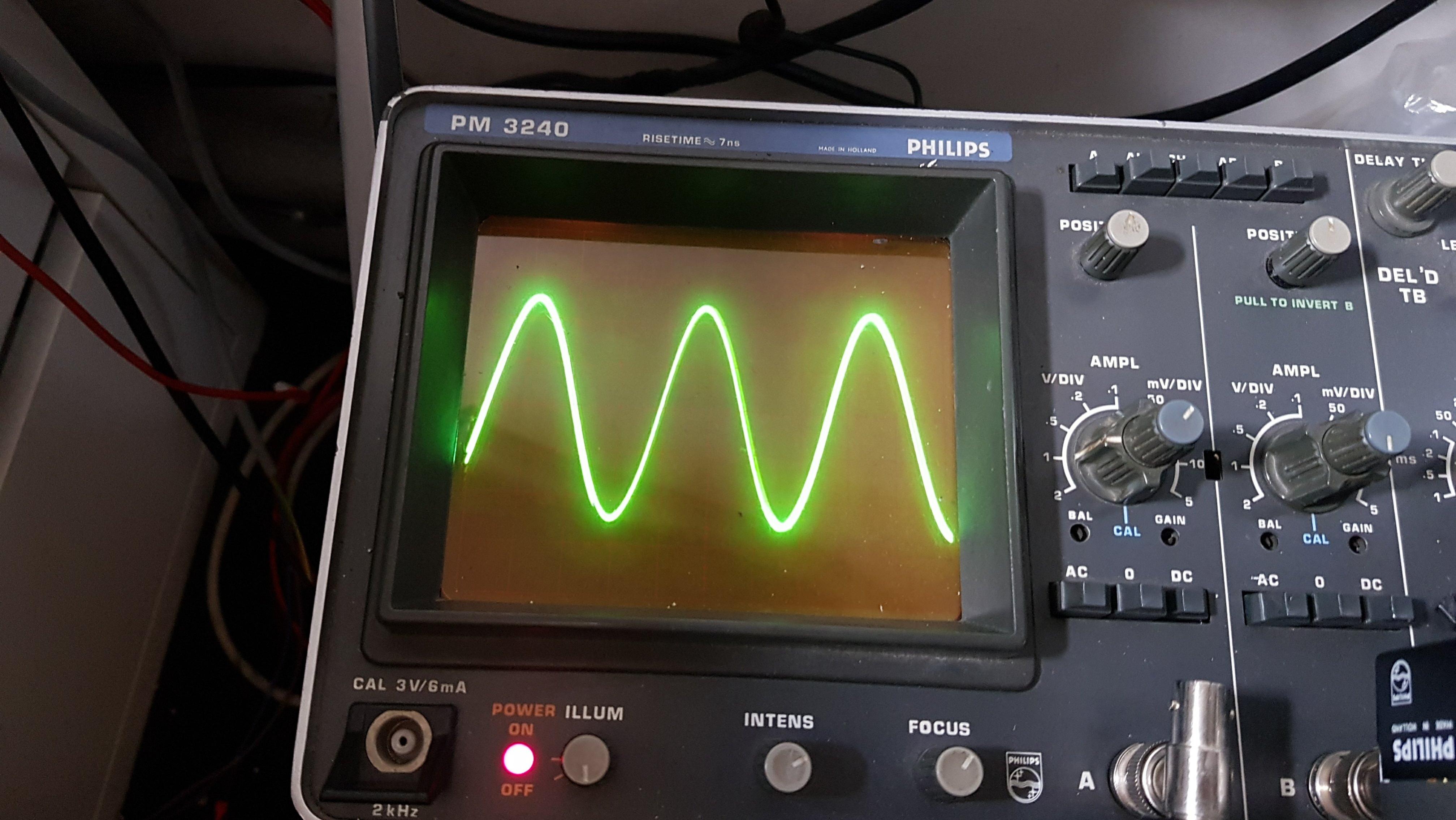

I tried a 5532 op-amp.
It easilly clips now with 0.30VAC RCA input. Even with bass boost turned off.
Looks like it's in good working order again, and the problem was a defect TL072C op-amp.
Thank you very much for your help ��
