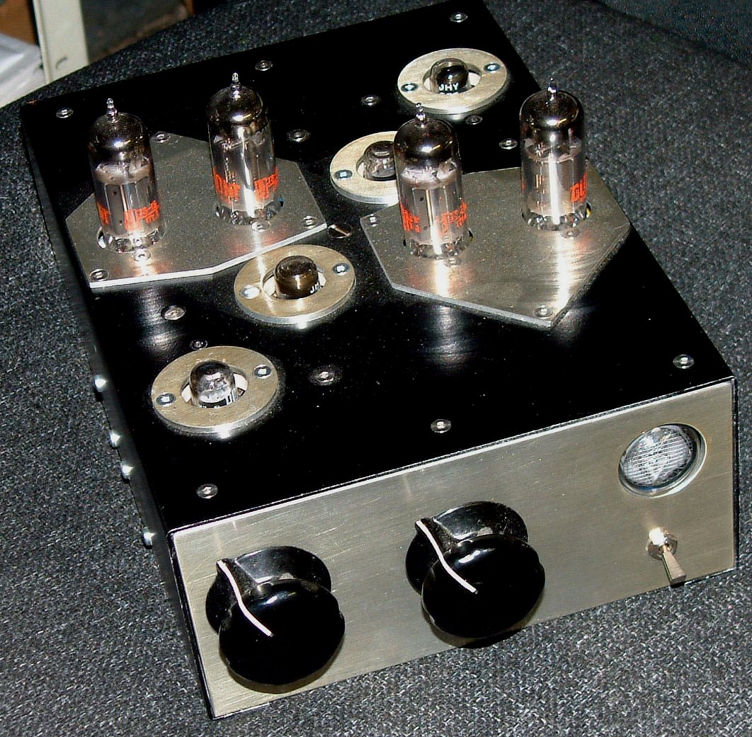

I am writing up the story and I will put it onto the forum with a full circuit diagram with voltages and currents etc. Meanwhile here's a snap!

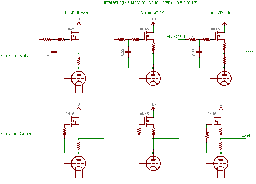

For constant voltage circuits or gyrators using the circuits below the voltage reference mat be either B+ based or ground based.
Constant voltage circuits use depletion mode devices. Constant voltage circuits may use depletion mode or enhancement mode devices.
Zout of the CCS/gyrator is equal to plate resistance in parallel with load.
Zout of anti triode is approximately 1/2 plate resistance in parallel with the load.
Zout of the mu follower is approximately 1/gfs of the MOSFET for relatively high resistor values.
Devices may be cascode to improve dynamic performance.

A gyrator has low impedance on DC to maintain a fixed DC voltage, and high impedance on AC signal voltage.
A gyrator acts like an inductor except for a using a relatively high DC voltage drop instead of storing energy like an inductor does.
Only the top center circuit in my diagram above is technically a gyrator.

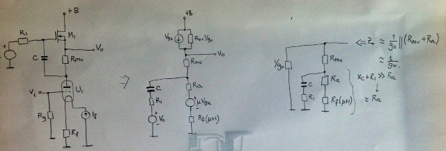

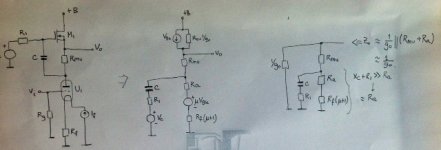

Thanks for the insight. Hope you can expand here. I may be a bit rusty with circuit analysis, so apologies if I make a mistake in my rationale (just trying to learn here!)
With only one MOSFET I think I can derive the output impedance to be close to 1/Go (see attached) Is this ok?
What would be the impact of the cascode pair in the output impedance?

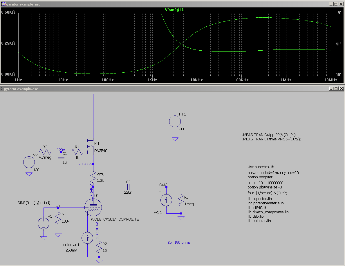

I simulated this simple gyrator at low Id (circa 3.5mA) to fit a 01a preamp and output impedance is about 190 ohms which implies that the Go=5mS at such low drain current. Looking at the DN2540 datasheet the Gfs graph is not that detailed at low currents but should be around 50mS @25mA. Is this correct?

Ale

The output impedance and plate impedance of the MOSFET mu-follower can be analyzed by considering that the MOSFET has an internal source resistance of 1/gfs, which is in circuit between the ideal zero-resistance source and the output source terminal.
Thus the internal source resistance and external source resistance form a voltage divider into, or out of, which the output current flows. This imparts a partial anti-triode like behavior (except 1/gfs is nonlinear) at smaller values of external resistance, as well as allowing the 1/gfs nonlinearity to swamp out desired anti triode behavior in extreme cases. I.e. there is some load current sharing between the tube and MOSFET.
The plate impedance is impacted by the finite gfs because changing output current necessitates a changing g-s voltage across the source resistor. Some fraction of the output signal current is thus "reflected" back to the plate at the ratio of 1/gfs to the external source resistance.
The output impedance is similarly affected because in order to change output current, the voltage across the external source resistor must change, causing a changing current that works into the finite plate resistance of the tube.
The larger the external source resistor, the smaller fraction of the output current reflected back to the tube plate, increasing the impedance seen by the plate and decreasing the output impedance seen at the MOSFET source terminal.
I leave it as an exercise to derive the precise relations... 😉

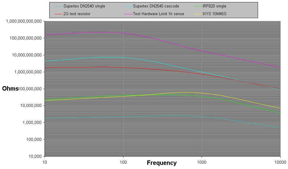

but you would probably get a CCS with 100Meg or more as the parasitic impedances of the MOSFETs start to contribute here decreasing the impedance of the CCS.
I'm not very knowledgable on this subject, but I think the above rationale is ok, please correct otherwise!
Looks right from the measurements by Gary Pimm.
CCS performance measurments
