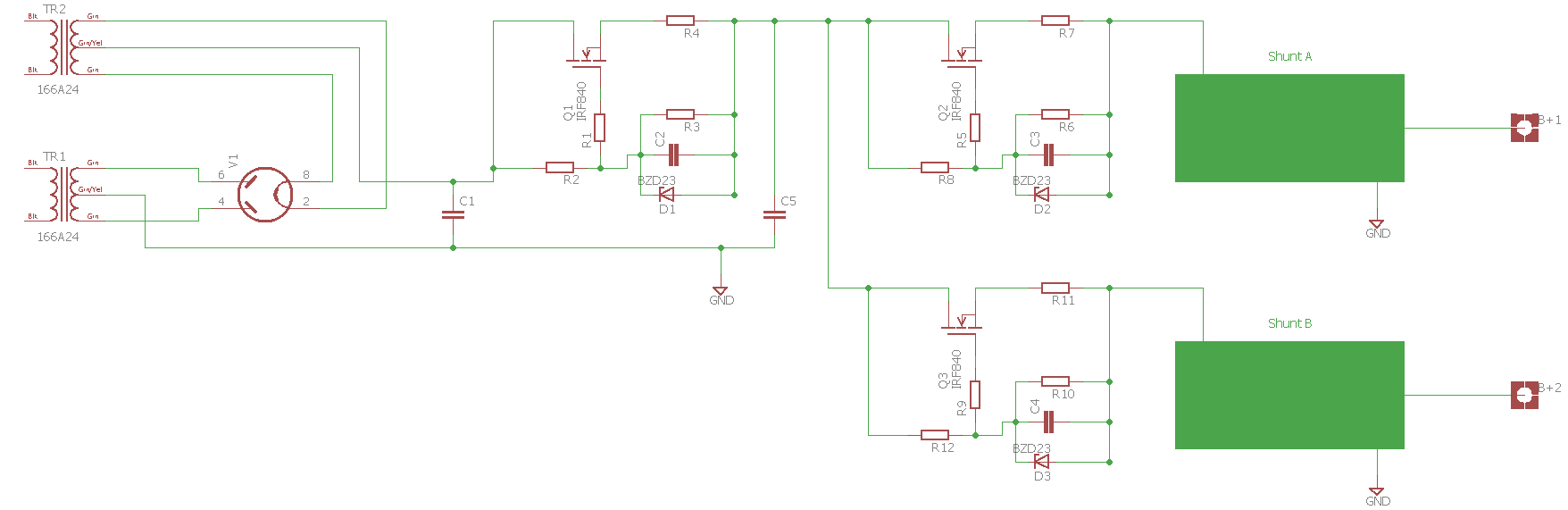

Much useful information thanks to all, This proposed scheme is what I would like to build for my pre Aikido, opinions?

My opinion is, it is absolute useless to use gyrators in DC filters as drawn. Unlike real inductance, gyrator does not save an energy. It is an active unit that uses energy of power supply and loses it. I would use the same components for better filtering, using simple RC filters that supply filtered DC to gates of source followers. This topic was discussed many times here on the forum.
This time, you and I agree. Back in the tube era, engineers used filter inductors, because they couldn't get electrolytics big enough, so sufficient series resistance to don the job ruined regulation. You can still use inductors (chokes) - they will usually cost less and be a lot more reliable than any power MOSFET circuit. But you can get large capacity HV electrolytics now, so any series resistor, if needed at all, can be small enough that regulation and energy wastage is not significantly degraded.

No. Look it up in any decent textbook. A Const Current Source is a circuit or device in which current does not change significantly with voltage. This IMPLIES a high slope resistance but DOES NOT imply the resistance changes with frequency. A true CCS can maintain its ability to keep current precisely constant at DC (zero frequency).
A practical CCS may well be designed to display a relative low, or even near zero, resistance at DC, as an additional feature in controlling DC operating conditions - that does not make it a gyrator.

A gyrator is not a gyrator from displaying inductance without actually having a physical inductance. That's just one of the many things it can do. Gyrators can, and are, used for lots of things, including making a small or even negative resistance controlled by a normal high resistance pot. As I said, a gyrator is a device or circuit that exchanges energy between two places, working in both directions simultaneously. Two gyrators in cascade make a transformer. Look it up. Bernard Tellegen's paper is a good place to start (Tellegen was the first to describe it, and invented a symbol for it, 1948).
