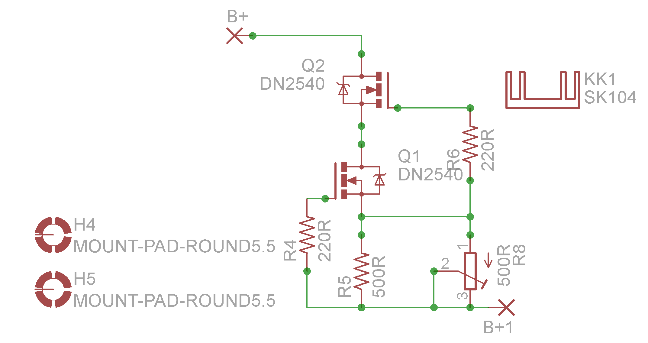

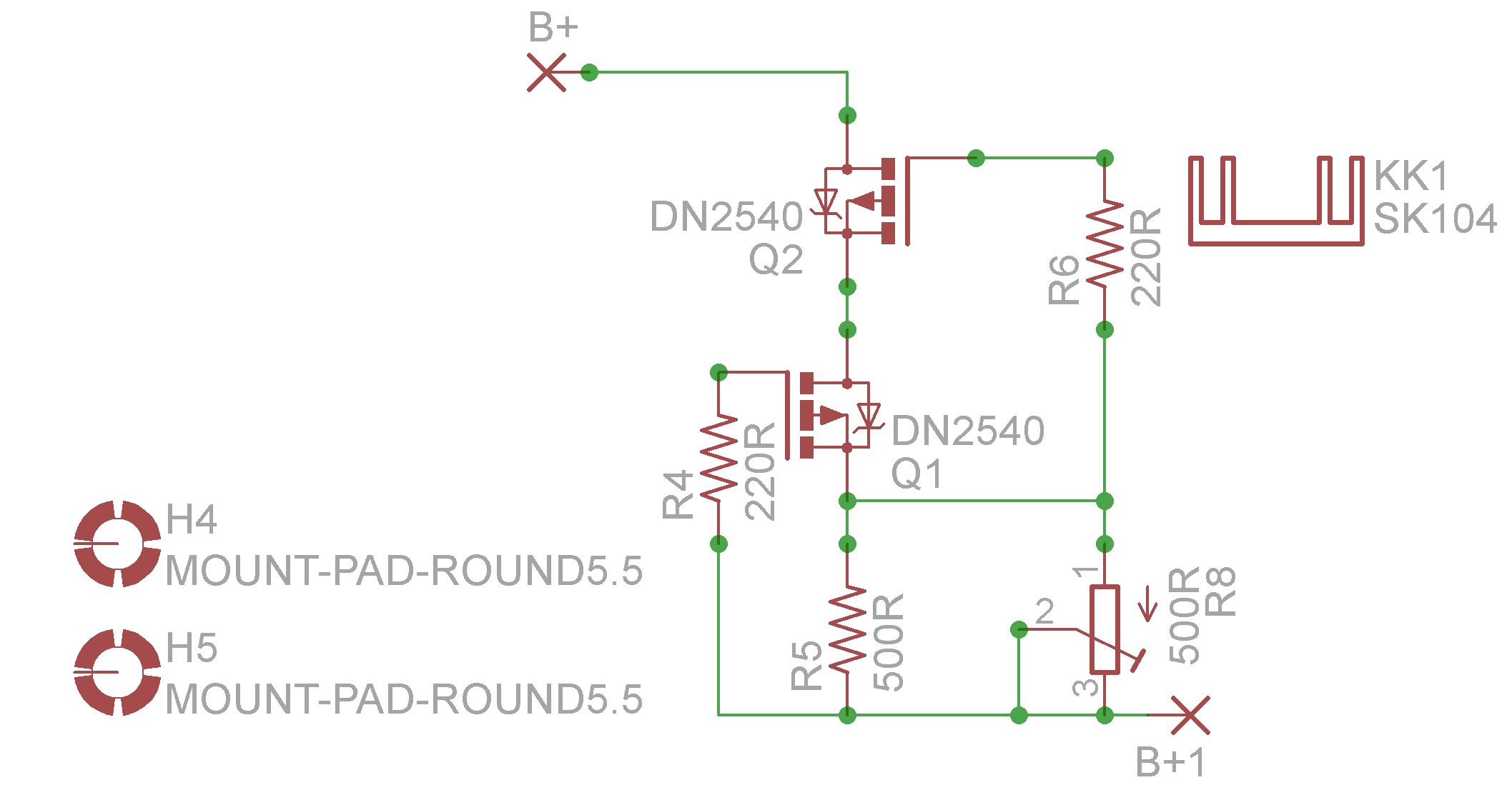

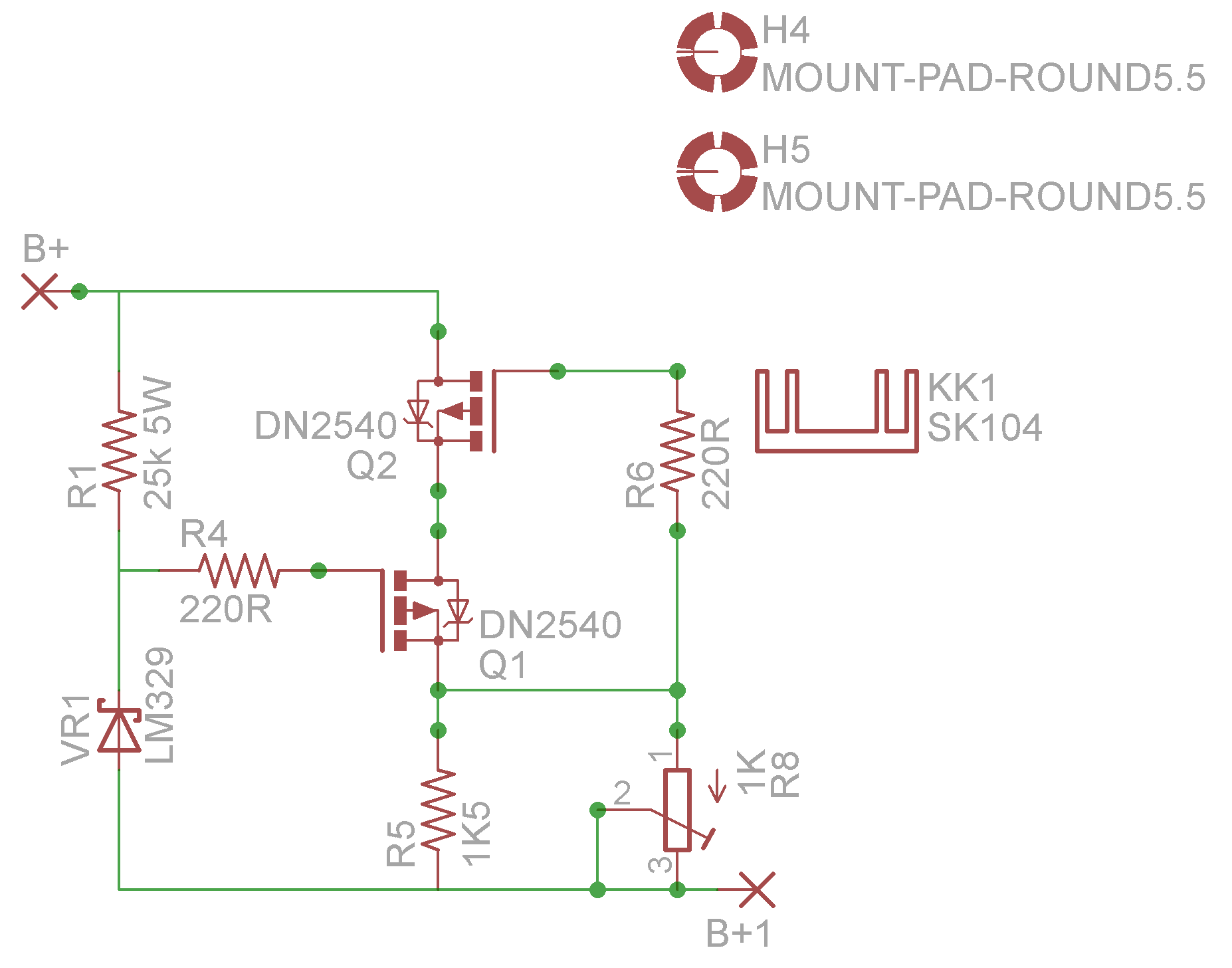

If I understand what was pointed out earlier, a decent CCS would be like that in the first schematic using depletion mode FETS DN2540. The second schematic would be a "improved version" by raising the gate voltage of the second FET, that would then require a larger sense resistor. In that case I chose a LM329 as an example which would require about 530R for the sense resistor for 15mA. I could use a LED which would have a lower required value. In either case, raising the gate voltage should result the output impedance increasing significantly by an order of magnitude if I understand the math.

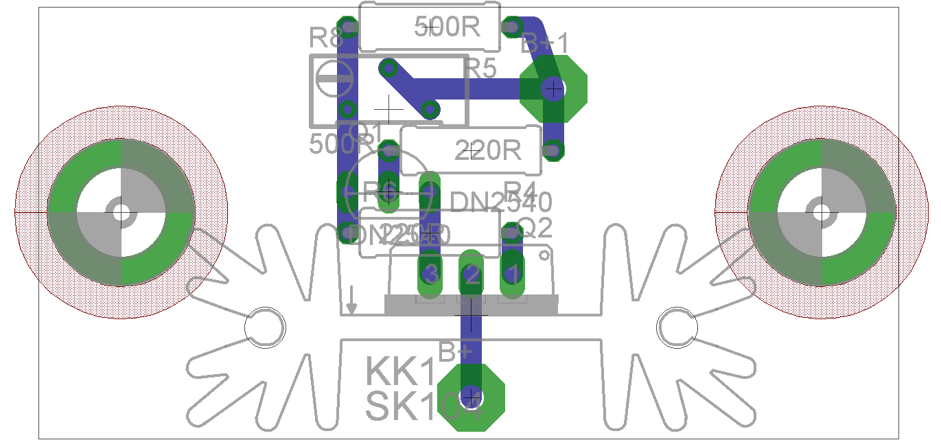

Ok, My math was off then as I calculated the first to have 10Meg and the second to be north of 100M. Will have to revist that. Here is a simple brd I came up with. I chose to use a small ohmite heatsink instead of the amp top plate with the idea of reducing capacitance. Not sure it makes a difference. I can actually keep the second FET off of the sink and possibly use a TO92 version if I could find one.

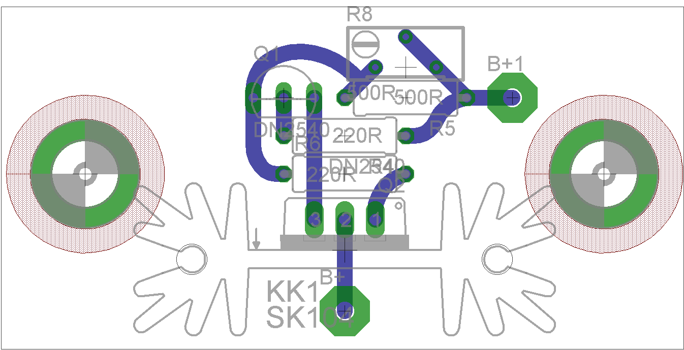

Here is a better version using the TO92 version for Q1. Q2 is stil TO220. Gate stoppers are now right on fet gates.
Symbol in schematic is now correct as well.
If it looks good then I will make a couple of these and test it. If it works as planned then I will redo the 12b4 board with this installed.
These little single boards will go in as the load for the input tube on my OPUS if they work.
DT, I will incorporate an easy means to isolate the load and install a load resistor in the CCS version so we can do your test. And not all of my 12b4's are that quiet.

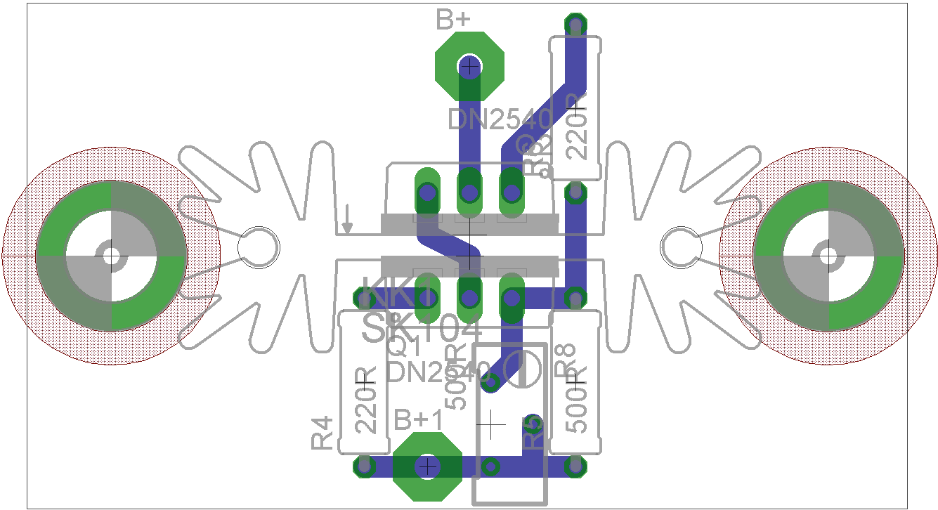

Circuit looks good. For thermal stability try for a little distance between Q1 and Q2. Not heating Q1 cuts down the drift a little.

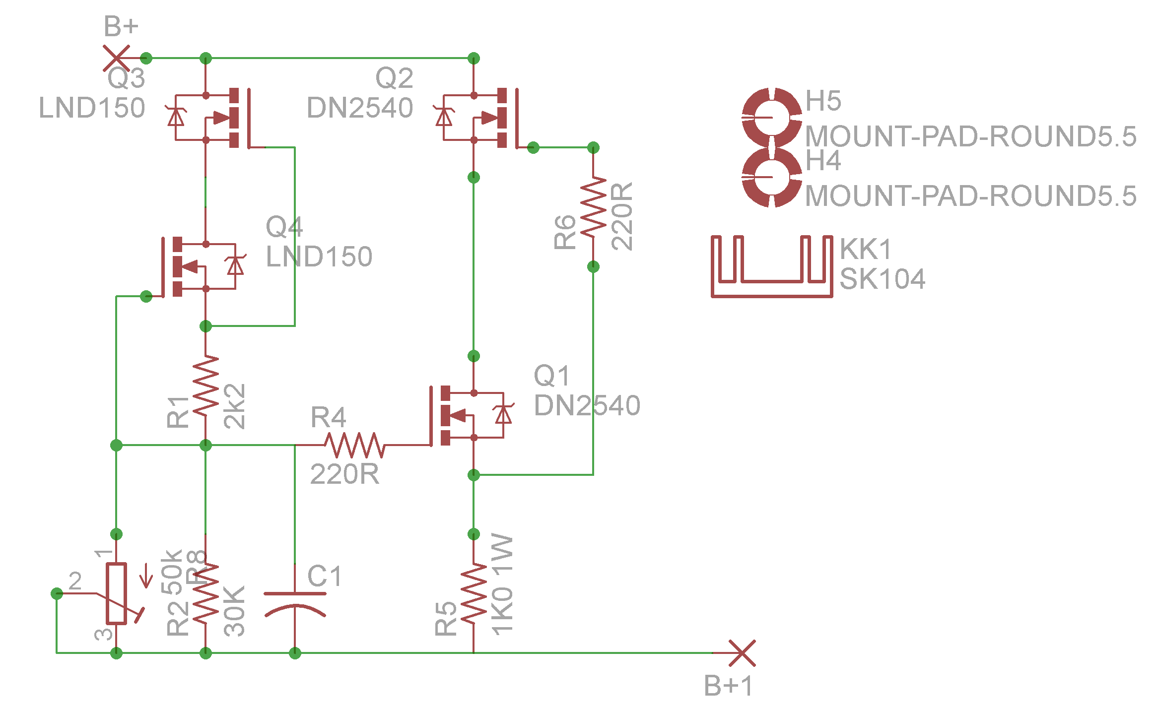

For increasing the bias on the Q1 the best bias supply I've found for use in CCS's is a cascode of LND150's feeding a resistor bypassed with a cap. In this instance the cascode is important for 2 reasons. First is minimizing the bypass leakage of the bias supply in parallel with the main CCS. Second is thermal isolation. A single LND150 program current with the power dissipated as the applied voltage changes. A cascode of LND150's does not show voltage dependent current changes. I use this circuit in the self bias CCS, the amplifier modules and the Swensen derived linear voltage regulator.

Here is a revised pcboard with better spacing for less thermal transfer to Q1.
For grins and giggles, I played with Gary's suggestion with the LND150's and attached the schematic. C1 should be somewhere around 47 to 100uF. Designed for 15mA of current I calculate a 20 fold increase in impedance. Is my math correct? I do like the slow turn on feature.

Could someone point me to a reference on how to calculate the impedance of the two circuits above. I have been searching and can't find the required info.
I certainly don't have my head around the math yet and would like to to understand the circuit better.
