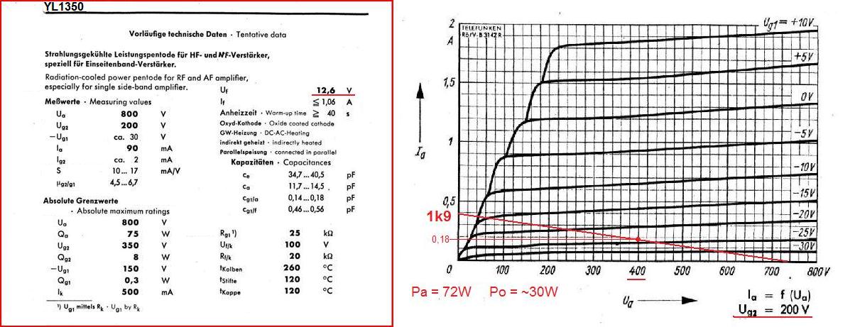

Oh oh oh that YL1350 miracle tube!The Pa of sweep tubes is rather low, you have to put minimum two or three in parallel.
This one can do it on it's one !
Mona
I suggest you'd better keep your hands off them, 'cause there were produced less than a thousand items. I know it from a former employee at the TELEFUNKEN Ulm plant who showed me the production lists he had salvaged. How many might have survived 'till today?
Best regards!
