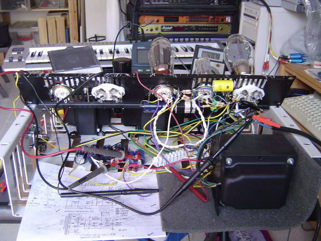

300B Guitar amplifier
I believe that a 300B guitar amp will have what I need: warm tone at very low volume, to play at home and mike the amp to record. I have a spare 300B and a old small valve amplifier crying to be reborn, so I will completely rebuild it with a new 300B design.
About the schematic, all i've seen so far is for hi-fi. Maybe I will start with the WALTON and then use a real guitar pre-amp schematic with tone control. Any sugestion?

I have reached my Guitar Amp Nirvana
I've finally made it! The Je-labs 300B schematic, with a Hammond 1627SE transformer... The sound is superb! I've been playing with a Stratocaster directly connected to the input, and it has all that I want: hot tone plenty of warm harmonics at low volume.
I have owned few expensive amps, pre-amps, speakers and simulators, but this is the first time I am satisfied with a "clean" tone that does not sound sterile. 😎
I agree with you Frank, maybe that's why it sounds so cool with the guitar. As the Chinese proverb says: "There is no fish in pure water"
Manuel
