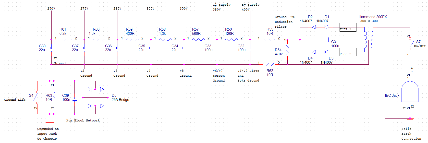

The 6.5V filament at 3.15A is too low. Plenty of HV current that is not necessary as guitar doesn't not produce continuous signal. But filament burns continuously. Also, 6.5V??!!
Or else, it's good price for no shipping. Maybe look for a small 6.3V transformer to supplement it.
I was somewhat banking on the idea of the slightly higher current draw dropping the supply voltage slightly, getting it closer to 6.3.
The next step up was 5A on the 6.3V winding, but much larger - rated 320-0-320 at 518mA.

You have to think about this as guitar amp, this one is for very high power like 100W+, it is going to be very stiff and very little sag. This is like using a PT from Twin Reverb and only use two 6L6. It's going to be heavy and might not sound as good.
Guitar amp is different from audiophile, in audiophile, we want as big a transformer as possible and the supply as stiff as possible for low distortion. In guitar amp, you want sag and distortion!!! Most of the things you learn here.....think opposite. Your main thing is to make sure the power transformer won't burn and don't over size it. this hold true in OT also.
I am surprised Hammond make it so imbalanced, so much current for B+ but not enough for filament. Don't think filament power is not important, it really can heat up the transformer. I remember back in the 70s when I first did a power scaling using a variac, I had to put the filament on separate 6.3V transformer so the voltage didn't vary with the variac. The transformer felt a lot cooler without the filament load.

I suspect the imbalance has to do with the fact that it's a replacement transformer for the 50W Bassman. My amplifier is around 40W - which is why it looked promising - but I have an extra preamp tube or two. I wasn't too keen on the 290FX because of its very high current rating. I want this amplifier to spend most of its time on the border between clean and slightly overdriven, so I don't want the power supply to be too stiff.
On paper, I'm only slightly exceeding the rated current on the heater windings. It might be worth seeing if it is a problem in practice. If it is, for about $10, I could get a 6.3V or 12.6V transformer that can run all of my 12AX7s instead of running them on the 290EX. I might pick one of those up as a precaution. A 12.6V transformer would also drop my preamp heater current and lead to less heater noise.
There's also a $20 upgrade - the 291EX. The datasheet for it is exactly the same as for the 290EX, so I'm not sure what the difference is.
I don't see any difference of the upgrade. From what I seen and heard, hammond over kill with big iron core, get the cheaper one. Buy the small filament transformer and it still be the cheapest for you. don't get the huge one, your back will thank you when you go gigging.

I'm planning on doing that once I see how much spare B+ I have, to see how much I can drop for sag. That'll come after I buy the transformers. Right now in my design I've got 10 Ohm resistors in series with the B+ and ground paths, connected by a bleeder, to get one extra filtering stage before my plates and minimize ground hum.
I've decided to go for a 4.25k:8 output transformer (Hammond 1750JA). It's about the best I can do locally within my budget, although I'd prefer something around 5k. I can always play with my screen voltage to change where the load line passes through the knee of the plate curves.
I hadn't planned on rectifying the heaters unless noise is a problem in the amp - I've got a humdinger creating an artificial center tap to reduce noise for now.
Thank you for considering sending your Weber over, I appreciate the thought. Getting things shipped from the U.S. to Canada is a big pain - especially something as heavy as a transformer. Hell, I haven't found somewhere in Canada that stocks reverb tanks - and the shipping on those from the U.S. is more expensive than the tanks themselves!
Off hand, I think 4.25k primary is what you want. You have 330V-0-330V, which gives you 466V after rectifiers. About 450 under idle. That's typical Fender 40W amps. Primary impedance of 4K is the most common for this type of amps.

You're confident that running the 3.45A @6.3V heater current in my amp off of a winding rated for 3.15A @6.5V is a bad idea? I could really use the extra space on the chassis without the 12.6V transformer to position the tubes better, and find room for a reverb tank.
The way that I'm thinking about this, one of two things will happen. I'm using far less current than the transformer is rated for on the B+ winding, and slightly more than it's rated for on the 6.5V filament winding. The VA rating of the transformer far exceeds my full signal demands. So either the transformer will run hot and potentially be damaged over time and introduce extra noise because I'm drawing more current than the winding is rated for, or the slightly higher voltage (6.5V) will get pulled down to around the 6.3V that I need because of the winding resistance, and it won't be much extra work for the transformer because it's rated overall much higher than what I need. It would be a gamble, and I'm not sure what to expect because this is my first build.

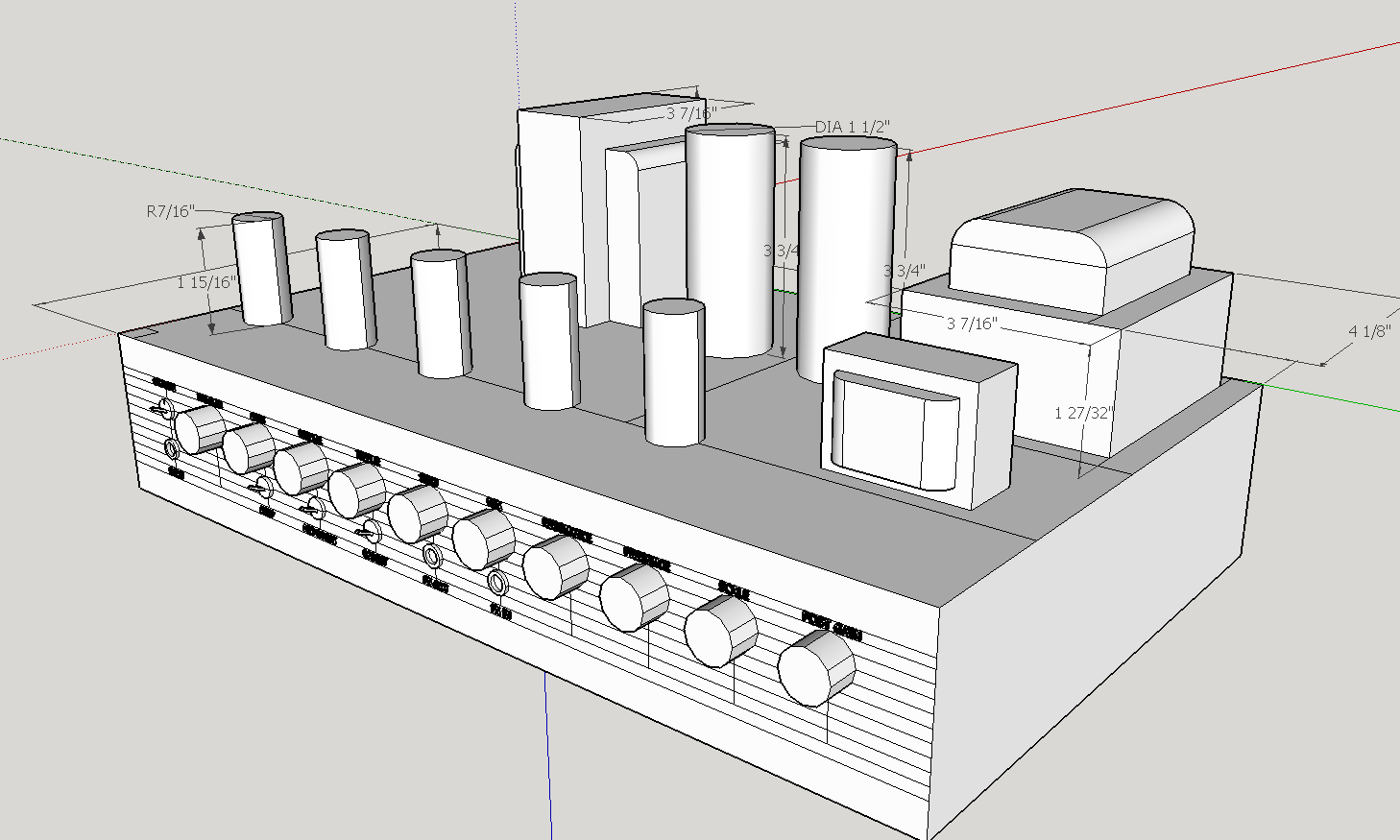

Also, since all of my controls are on the front, I might look at moving the tubes to the back so I can keep my heater wiring away from the signal.

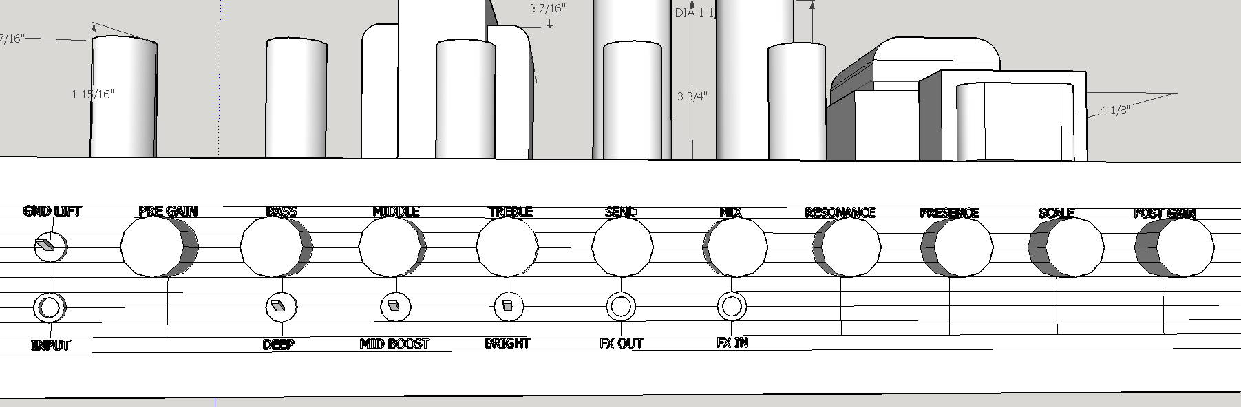

An idea what this might look like when done.
I want to put a MOD 8EB2C1B reverb tank inside the chassis, though, so I may need to go up another inch or two in width and move parts around.
