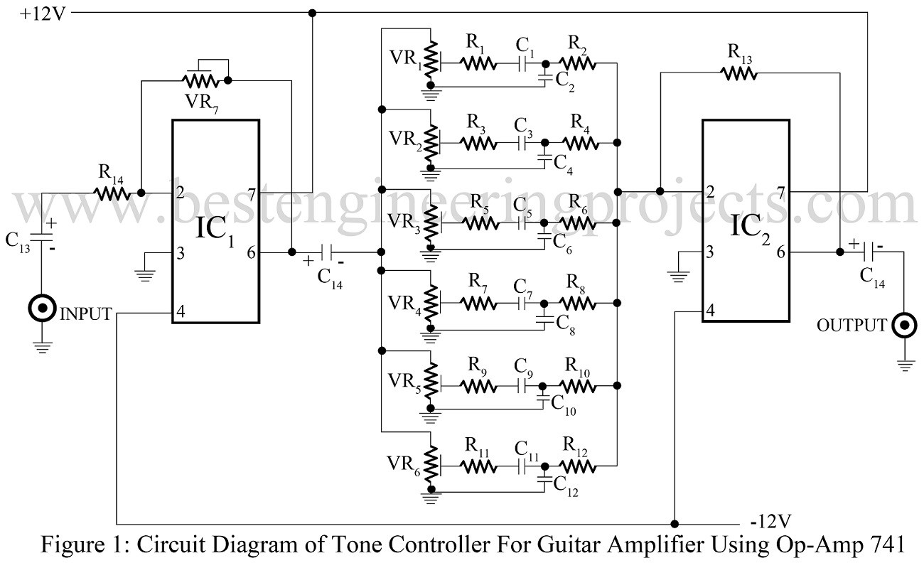

op amp as pre?
could this be adapted, not worked with sand much before. but hav inherited a stack of 741's and the 12 volt input is good for me
PARTS LIST OF TONE CONTROL FOR GUITAR AMPLIFIER USING 741
Resistor (all ¼-watt, ± 5% Carbon) R1 – R12 = 10 KΩ
R13 = 1.2 KΩ
R14 = 47 KΩ
VR1 – VR6 = 10 KΩ
VR7 = 250 KΩ
Capacitors C1, C2 = 0.39 µF
C3, C4 = 0.1 µF
C5, C6 = 0.025 µF
C7, C8 = 0.018 µF
C9, C10 = 3300 pF
C11, C12 = 1600 pF
C13, C14 = 5 µF/25V
Semiconductors IC1, IC2 = 741
IMO that's not a great way to go. Not only are 741's ridiculously noisy, they are not great at providing the very high input impedance you want for a guitar (1M or even higher).
The specific circuit you showed has far too low an input impedance, and also, it's unnecessarily complex.
You certainly can build a buffer around an opamp (a cheap TLO72 or TLO82 will be a far better choice than a 741). But I too think the simplest way is to use an off-the-shelf guitar pedal to provide buffering and gain.

Save those 741 to build a classic MXR Distortion+ or same era pedals 😉
You can build a simple 2 channel preamp/mixer with just a TL072.
9 to 12V powered, 2 high impedance / high gain or both inputs, 2 RCA outputs (your EBay amp seems to be stereo) , so he can accomodate a Piezo powered Guitar, and a conventional electric Guitar pickup *or* a non balanced (no need for it) low impedance microphone input or an active microphone input so he can use a cheap PC type earphone/microphone combination so he can sing and play and not need a microphone stand.

It's easy to make a simple op-amp buffer. The trouble is, an electric guitar through a 100% clean op-amp buffer into a clean (hi-fi) solid-state amp usually doesn't sound that good. Too clean, too sterile.
It really helps (guitar sounds much better) to get a few percent of 2nd harmonic distortion into the signal somehow. If you have any FETs, using one of these is an easy way to make a simple guitar buffer which also adds a little 2nd harmonic distortion.
