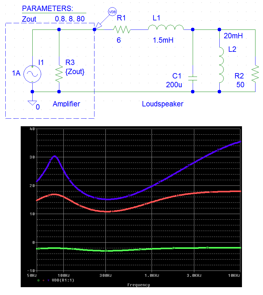

It tells you how much the bass and treble response of the loudspeaker gets modified by its interaction with the amplifier driving it. You can get more details at the link I posted earlier.

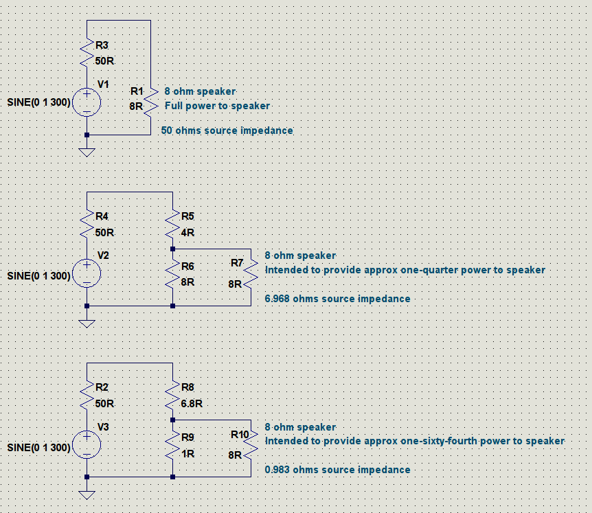

...tell me how you can change this impedance without swapping transformers or nfb?
By adding a speaker attenuator made from a couple of power resistors, as the OP (ggidzinski) mentions he did in post #34 of this thread.
The attached image shows three cases I drew up for you:
1) A guitar amp with 50 ohm source impedance connected directly to an 8 ohm speaker. This is what the amp manufacturer intended. The speaker will produce bass and treble boost due to the 50 ohm source impedance, and this will be the normal sound of the amplifier.
2) A quarter-power attenuator has been added. The attenuator has been mistakenly designed by an engineer, technician, or hobbyist who assumed the amplifier will act as though it has zero source impedance. (This is correct for 99% of today's solid-state amps, but not for valve guitar amps with little or no overall NFB.)
The unintended result: the speaker is now fed by a source impedance of only about 7 ohms, instead of 50 ohms. The speaker will produce less bass and treble. The amp will be 6 dB quieter, but may also sound a bit "blah" because of the reduced bass and treble.
3) A one-sixty-fourth power attenuator has been added. The attenuator has been mistakenly designed by an engineer, technician, or hobbyist who assumed the amplifier will act as though it has zero source impedance.
The unintended result: the speaker is now fed by a source impedance of about 1 ohm, instead of 50 ohms. The speaker will produce less bass and treble. The amp will be 18 dB quieter, but may also sound quite "blah" because of the much reduced bass and treble.
I suspect that at least some of the blame that speaker attenuators get for "tone sucking" comes from this effect. As I mentioned earlier, I have used a dummy 8 ohm load, a resistive voltage divider across it, and then a graphic EQ pedal to derive a line-level signal from a guitar amp speaker signal, which is then fed to a flat-response powered speaker for low-volume home guitar playing. I found that using the graphic EQ to filter out highs above 5 kHz, and to boost bass and low treble a bit, helped me fix some of the "blah" from the reduced speaker volume.
So according to this, the output is responsible for the bass and treble response of the speaker.
The output impedance affects the bass and treble response of the speaker, yes.
If you are familiar with any of the software used to design speaker cabs using the Thiele-Small parameters, try adding 50 ohms to the speaker voice coil resistance (Re), and plotting the frequency response with and without the added 50 ohms. You'll see the bass hump up, and if that particular speaker has appreciable voice coil inductance (Le), you'll see the treble response start to climb as well.

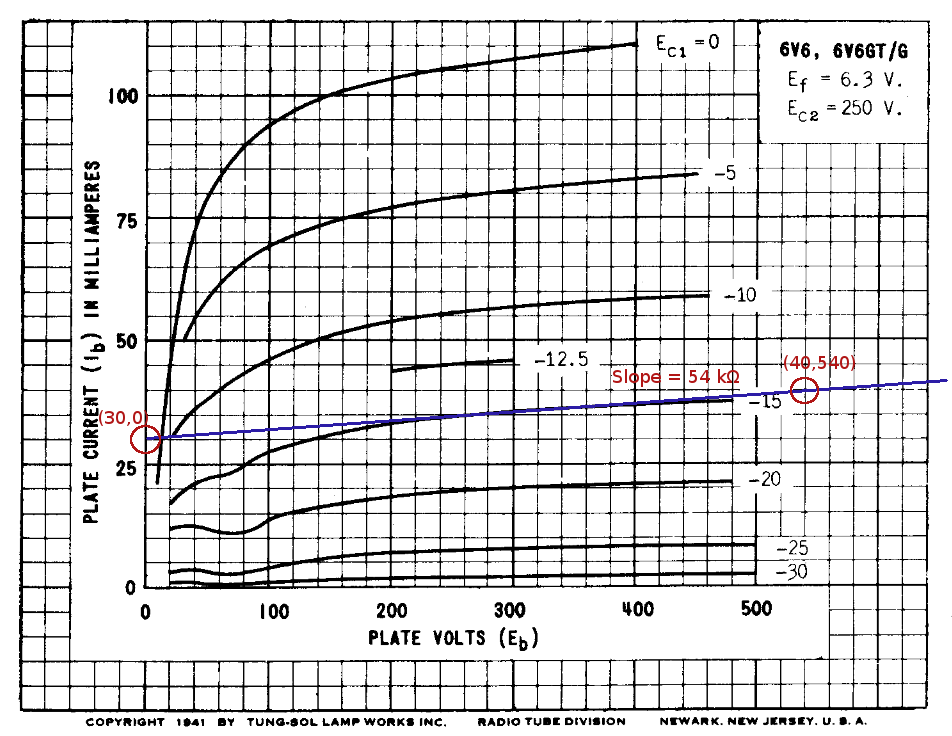

...was surprised to find out that guitar amps were so much higher...
Having grown up with transistor electronics, it never entered my head until a year or so ago, that valve guitar amps have high output impedances.
Once I realized that, it occurred to me that I could take the anode impedance of the output valves, step that down through the output transformer, and so get an idea of the amp's output impedance.
So I drew straight lines on a set of 6V6 characteristic curves, and from the slope, estimated 54 kilo-ohms anode resistance, with the valve operating at fairly typical guitar-amp conditions (350 - 400 volts, around 30 mA). Pic attached.
Taking an 8 k: 8 ohm push-pull output transformer as typical, that's a 1000:1 impedance stepdown ratio. But one valve sees only half the primary, so that's a 250:1 impedance ratio (impedance ratio is turns ratio squared, half the winding equals one-quarter the impedance.)
So if we now take 54k and divide by 250, we get an estimated output impedance of 216 ohms. 😱
If we remember there is a second 6V6 on the other end of that OT primary, and both 6V6s are operating for small signal swings (class AB), that drops to 108 ohms. Still shockingly high. 😱
It turns out that my quick-n-dirty calculation is still off by a factor of two, and the real output resistance is around half of what I calculated. Printer2 measured about 50 ohms on two smallish guitar amps, and so did you.
I don't know why there is a factor of two error (actual guitar amp screen voltage much higher than screen voltage on the characteristic curves I used?), but I'm happy the quick estimate at least got to the correct order of magnitude. 🙂
There's losses in the iron. This may amount to a shunt like 10X the nominal impedance, varying muchly with frequency, level, and construction details.
So 108r || 80r makes 46r, in sight of the numbers seen in experiments.
