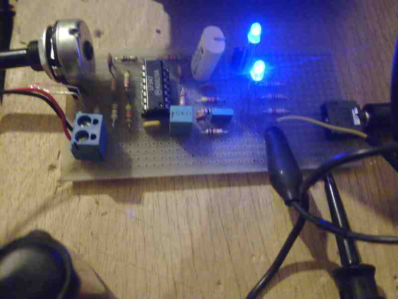

Thanks to all for the kind answers.
Some small improvements.
I added a poor man limiter (or soft clipping) using blue LEDs. They should start to act around 3Vpp , that is almost the value that saturates my boombox.
We'll see if it works.

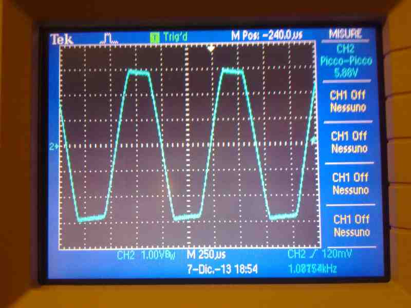

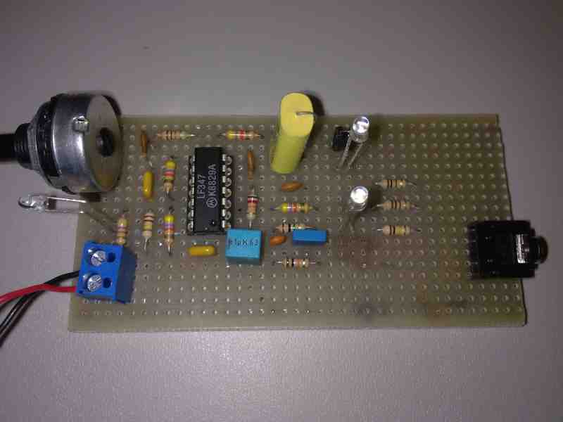

Prototype done!: ):):)

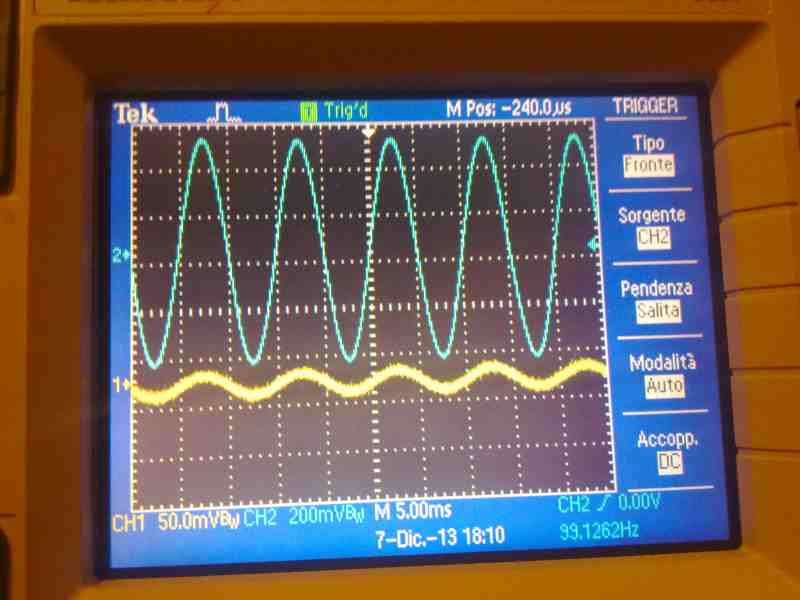

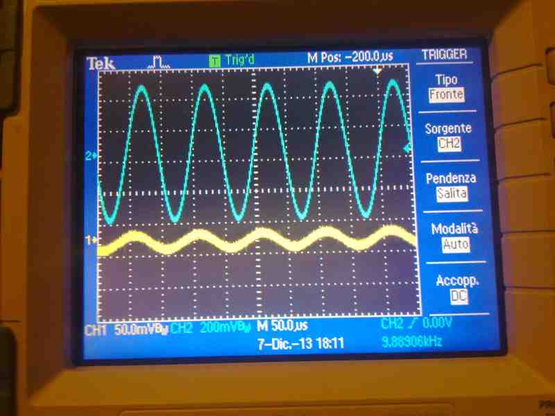

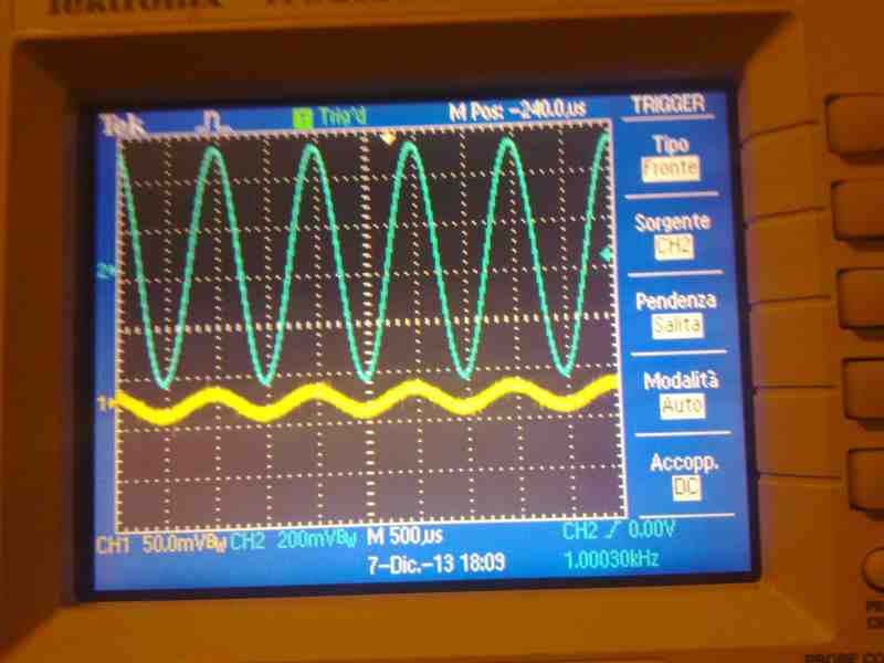

And tested with generator and scope:
The input is correctly amplified about 50x starting from about 15 hz to well after 10K, no instability or problems shown.
Clipping with the diodes happens at about 5.5 Vpp, when the diodes are fully bright.
Also I have done a test connecting it to my subwoofer amplifier, and using a small speaker driver as input ( I do not have an actual guitar by myself).
The thinghy is unbeliavely stable, and the noise floor is fair even with the cheap LF347 of the test setup... Consider the usual test setup, no shield/box, cables everywhere.
Even with a 100K series to the input speaker-microphone, it works very fine as a voice amplifier, just the hiss raises, of course.
So, it is time to close it in a nice box and give it to the rockers!
