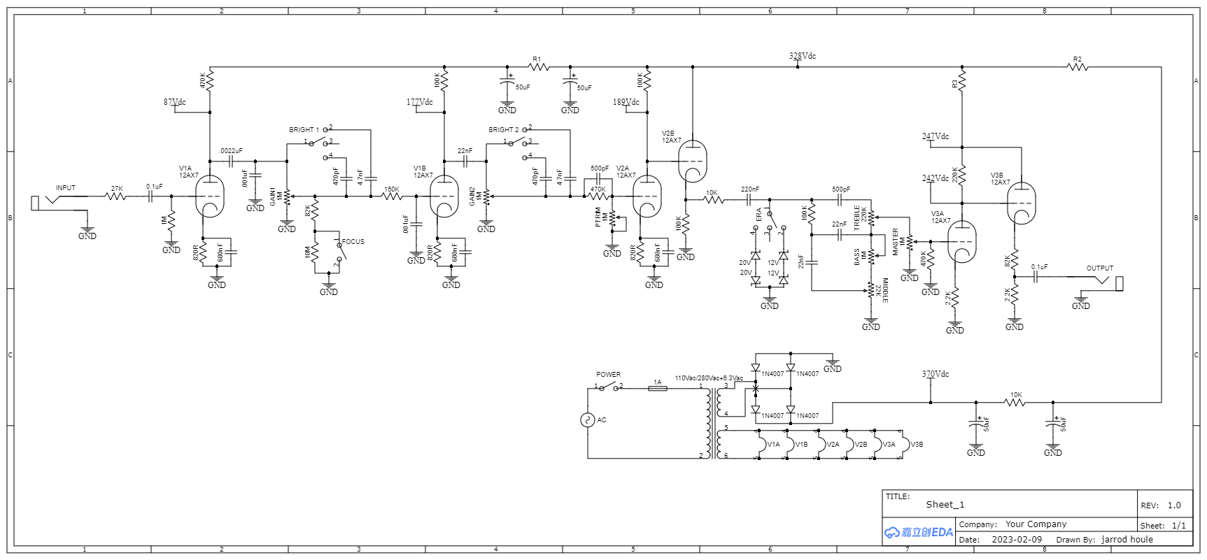

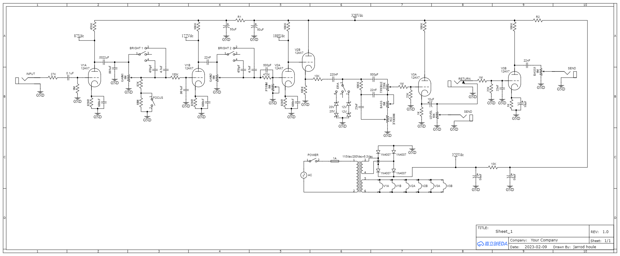

Hi all. First time posting on this forum, I have gotten alot of help over at el34world but I am looking for any more advice where I might find it. I am almost done designing a standalone preamp based on ceriatone chupacabra 50 for my friend. I currently am using valvewizard universal effects loop circuit as the effects loop/output but I am told that this will have significant distortion and impedance issues. I need V3B to output line level to an unbalanced input of a power amp (Like peavey classic 50/50). I have been reading the cathode follower sections at valvewizard but I am really struggling with the theory. I have built a few JCM800s but designing tube stages from scratch is a skill I am trying to learn.
Does anyone perhaps have a circuit I can use for an effects loop and output driver for this application? I do not mind adding more tubes or stages. Any advice really on how I can go about calculating component values? I really appreciate ANY advice, please let me know if I did not post enough information.

The output impedance is kind of high, and a function of pot position - driving any length of cable would probably result in a lot of HF roll off. Perhaps a cathode follower output or similar would be a good idea. I would probably use a self biased follower based on a 12AT7A if the PSU can handle the required current. Others with more MI experience than me will likely weigh in.
leadbelly that is absolutely perfect. I am just wondering for clarification: the output of a soldano x88r is line level so should be 1v peak to peak? meaning I dont need to add an effects loop to the preamp i can just run effects pedals between the preamp and the power amp units?
If all your effects pedals accept a line level input that'd work fine.
If you want to keep the effects loop, you could add a high voltage MOSFET source follower to gain low output impedance without requiring another tube. The LND150 is a common choice for this sort of thing, but that particular part doesn't seem to be available from any authorized distributor at the moment.
Either way, the maximum output level is a fair bit above typical line level as shown, so you might want to cut the output voltage a bit.
Many do, some don't. Strictly speaking, 'line level' is ambiguous, but many (probably most) pedals will deal with at least a 1V RMS (2.83V pk-pk) signal without issue. Keep in mind that a pedal's supply voltage is usually only 9V, though some use internal boost converters, negative rail generators or other tricks.
Some pedals have a rather high output impedance or otherwise have trouble driving lower impedance (<100k ohm) line inputs.
You can certainly use a cathode follower rather than a source follower, it's just that in this particular application there should be zero audible difference.
