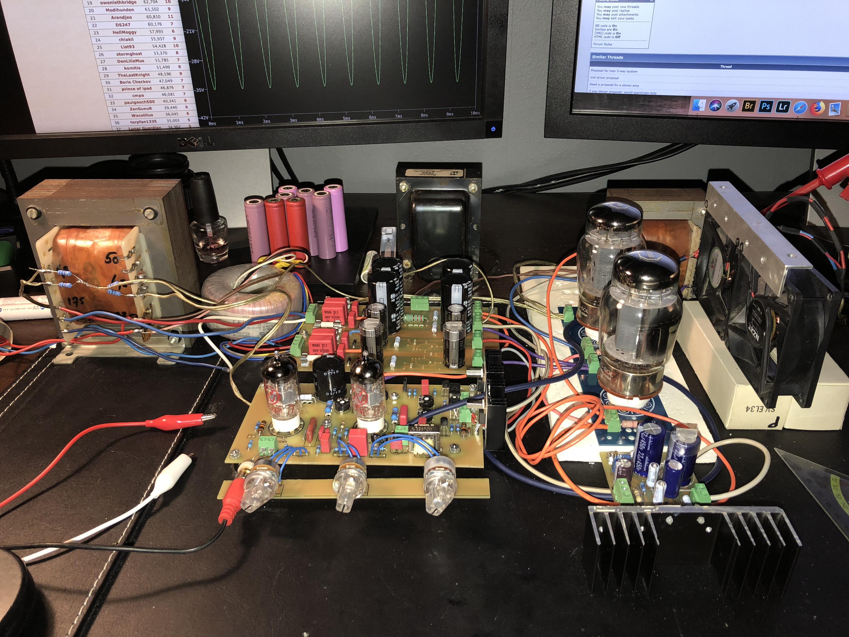

Last week I made some PCB’s and put the whole amp together. There were some alterations made to the schematic:
- Quasimodo filters in the PSU. For the high voltage 10n || 100n-470r, for boas and MOSFETs 10n || 100n-220r. All secondaries are snubbed. All rectifiers UF4007. On the scope I observed some ringing on both power supplies, around 2 V p-p without the rc snubbed in place. After snubbing all ringing (which wasn’t much to begin with) is gone. The PSU is clean now, as far as I can see.
- no snubbers on the OPT yet. Don’t have a 100x probe yet, so can’t really measure the primaries safely. Could probably measure through a high voltage cap though.
- Volume control is placed after the first parallel triode and in front of the phase splitter. Input is now a 10k grid stopper with a switchable 470k or 1k grid leak after. Input impedance/sensitivity is this switchable without much effect on the high frequencies.
- added a 220r resistor after the choke in series with the rest of the PSU. No more low frequency ringing/overshoot in the screen supply.
Stability of the amp is pretty good. I observed some oscillations when testing different cap values in the negative feedback path. There’s a small 100pF cap over the 22k feedback resistor. Leaving long leads on that cap for testing purposes caused the oscillations. Short leads😛roblem gone.
With some old el34’s biased at 60% I tested numerous times at full output. I observed somewhere between 26 and 27 Vrms in a 7.8r load at around +20V peak grids of the EL34’s. Output shows some flat topping, but no hard clipping. Good! 90W at full tilt, not bad.
Now the bad news: screen grids are just holding up. With some winged C’s the were already glowing at idle. Some old Marshall’s were fine, but started to faintly glow when approaching grid conduction. I’d like to be able to lower the screen voltage. Would a Maida regulator work?

Maida Reg for screens will work but you might like to try 2K2 or 3K3 screen resistors first.
The maida Reg will make it HiFi'ish, The bigger screen resistors will impart some compression.

Thanks Ian, but what if I’d like to use some 6550’s. 460V on the screen seems right on the edge...
21st Century Maida Regulator
6550 should be OK with 460V on the screens but use the Maida if at all concerned.
With lower screen voltage you could drop the screen resistors as low as 47R but I would start with your "standard" 1K.

Actually, I do use a Maida Regulator now. Next up is regulating the bias too with a simple 2 transistor regulator. Provisions have already been made on the psi pcb.
The screens are now at 310V so bias voltage went up a bit. There lies the new limitation: as I use 1k grid stoppers on the output tubes I can barely push to class AB2 and thus have safe running tubes delivering less power than before (still around 60W at clipping). Need to do some more measurements to see if the grid stoppers are actually the culprit. Probably they are. If so, could I use an anode stopper of 10 turns 18 AWG wire // to a 100 Ohm resistor? Or is there a better way?

Here's my 'safe' work bench with the amp in it's current form.

The output Tube current is largely set by the screen voltage and not the anode voltage so when you reduced the screen voltage the required bias voltage for the same idle current should have reduced too.
Lower screen resistors will impart "tighter"/"punchier" sound (less compression).
The 47R is the minimum "screen grid stopper" resistor for its grid stop function, that is to supress parasitic oscillation, larger screen resistors are for tube protection
The 1K (control grid) gridstops will reduce drive when grid current is drawn (the Class AB2 condition) but I would hesitate to drop them much below that 1K value.

Oh, those screens can glow pretty badly in EL34's and EL84's, especially when they are at B+ and there are just 1k screen resistors. Old Marshalls and Vox amps just have one way of producing distortion: turning up the volume of the whole amp and make the PI and output tubes clip. Did just that last week with a 1973 Super Bass. Grids start glowing red/orange at heavy clipping.No wonder service life of output tubes was/is rather short when used that way. High voltage sagged from 460 to 360V during clipping. Quite some compression, but that's the nature of the beast.
Now, this amp is a different beast altogether. PSU is capable of 450mA @ 350Vct. MOSFETs driving the grids. There shouldn't be much sagging or compression at all.
The goal of grid stoppers is clear to me. I'm looking for a way to achieve that same goal while ditching or considerably lowering the grid stoppers. There is a way to do that, I just don't know it yet. I probably could make something to limit the drive capability of the MOSFETs.
