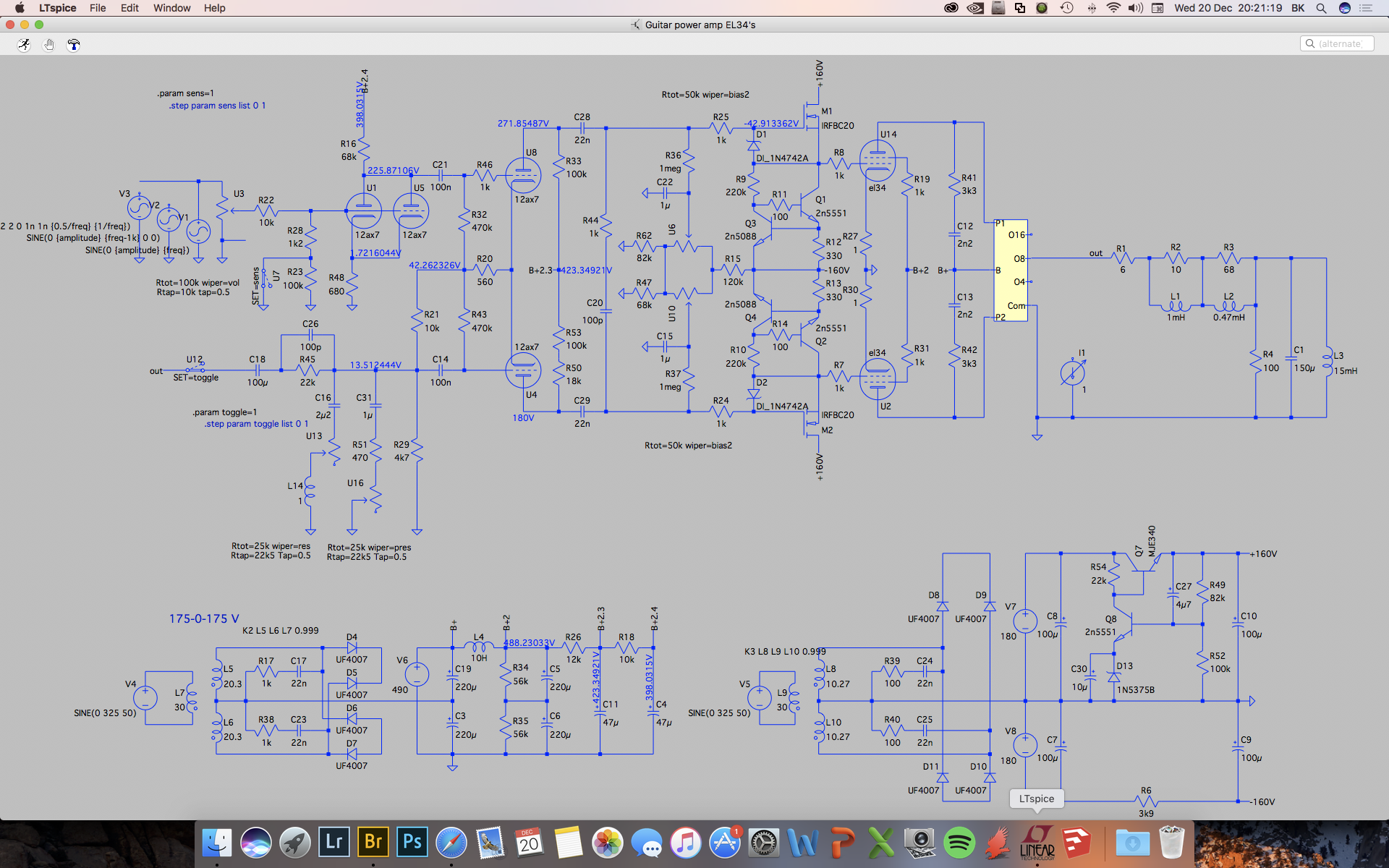

From a project I did a long time ago I've got some transformers left. A PT with 350 Vct @ 400mA + filament and bias taps and an OT of around 4k to 8 Ohm. They were initially intended for a push pull EL34 guitar amp and I plan on using them that way again, in a very different this time though.
Design goes were:
- Use what you have: Transformers, bread and butter tubes, etc. to keep the costs down;
- switchable input levels so the amp can be used with pedals in front (essentially effects return) or with line level (guitar preamp out);
- Modern flavour ala Diezel power amps: inductor based resonance control and wide band presence.
I'll be using MOSFET source followers to drive the power tubes. I've got very good experience with that in HIFI amps and the total absence of blocking distortion is a plus for this kind of amp (this will not be a bedroom practice amp).
Below is the schematic of the proposed amp. I can't spot any mistakes, but I usually make them though. I'm currently designing the PCB's needed and am also powering on the power supply.

That looks nice. Thanks for sharing. I have more questions than answers...
1) The current mirror sourcing for the MOSFET followers is fancy enough I would presume comes from the hifi world. How does that benefit a guitar amp? (I’m not suggesting it doesn’t; I’d just like to learn).
2) The +160 looks regulated. The -160 does not. Am I missing something, or is that an alternative to unbalanced phase-splitter resistors?
3) I am probably not agile in reading LTSpice models and transposing in my head to a physical connection...but I’m scratching my head at where I expect an output transformer...well, since you’re simulating it, I get that you need a model...it looks kind of like a solid state amp output (Zobel?) network...so I went back to look some more...a little confused. Your 50 Hz signal sources cued me into your distant geographical location...
The source followers directly driving the output tube grids eliminate blocking distortion (AKA farting out). Using a CCS (chip or BJT pair) instead of a simple resistor on the source offers some advantages, the main one being elimination of the filtering / regulation requirements on the negative mosfet supply.
Actually the positive supply doesn't need regulation either since the PSRR of a follower is very high. In the HiFi world, one would regulate the grid bias supply AND the output screen grid supply, or neither. In the guitar amp world, active regulation is rare....unless you count the VVR's used for power reduction, most of which are not really regulators.
We don't know what's inside the yellow box, I assume a real OPT model (I just use coupled inductors like shown for the power transformers). The stuff on the right of the yellow box is a speaker emulation model.
Thanks George for answering the questions. I'd like to add a bit more to the points you made.
1) The followers are a low load to the preceding phase inverter. The high local feedback of a CCS'd source follower keeps capacitances in the MOSFETs down, so the 12AX7 phase splitter can take a walk in the park on a Sunday morning driving the output tubes to clipping and beyond. Add to that the very low output impedance of the MOSFETs and low reverse transfer capacitance and you indeed have a HIFI worthy driver stage (IMHO).
Keep in mind, HIFI is essentially a goal. I don't want the output stage to behave like a typical Fender or Marshall output stage would.
2) The bias voltage is not regulated. I'd have to regulate the screens of the output tubes too if I would, otherwise bias would drift considerably when the mains voltage is varying.
The + line is regulated not because I need low ripple perse (although it doesn't hurt). The - line has highish impedance, but there will not be much current draw in any condition I could imagine. The + line however needs to deliver some current in instances where the is grid current in the output tubes. The goal of regulation was to provide a low impedance supply to the MOSFETs in that case so the voltage keeps constant and the voltage over the MOSFETs stays high enough to keep capacitances of them down to low levels.
I must admit: probably over-engineered. Other than complexity I see no big flaw in regulating. Unless I'm missing something, my knowledge is certainly not endless.
3) The yellow box is a generic 4k output transformer. The model contains data for the inductors, resistance of the inductors and coupling factor between the inductors. The data is not shown in this picture: all data was stripped in this screen shot.
Now that I'm thinking about the inherently good PSRR of a CCS'd source follower. Do you think I could get away with something simple like a bridge rectifier and just one filtering cap per side for the +/- 160V lines George? Doesn't save a lot of money, but everything helps.

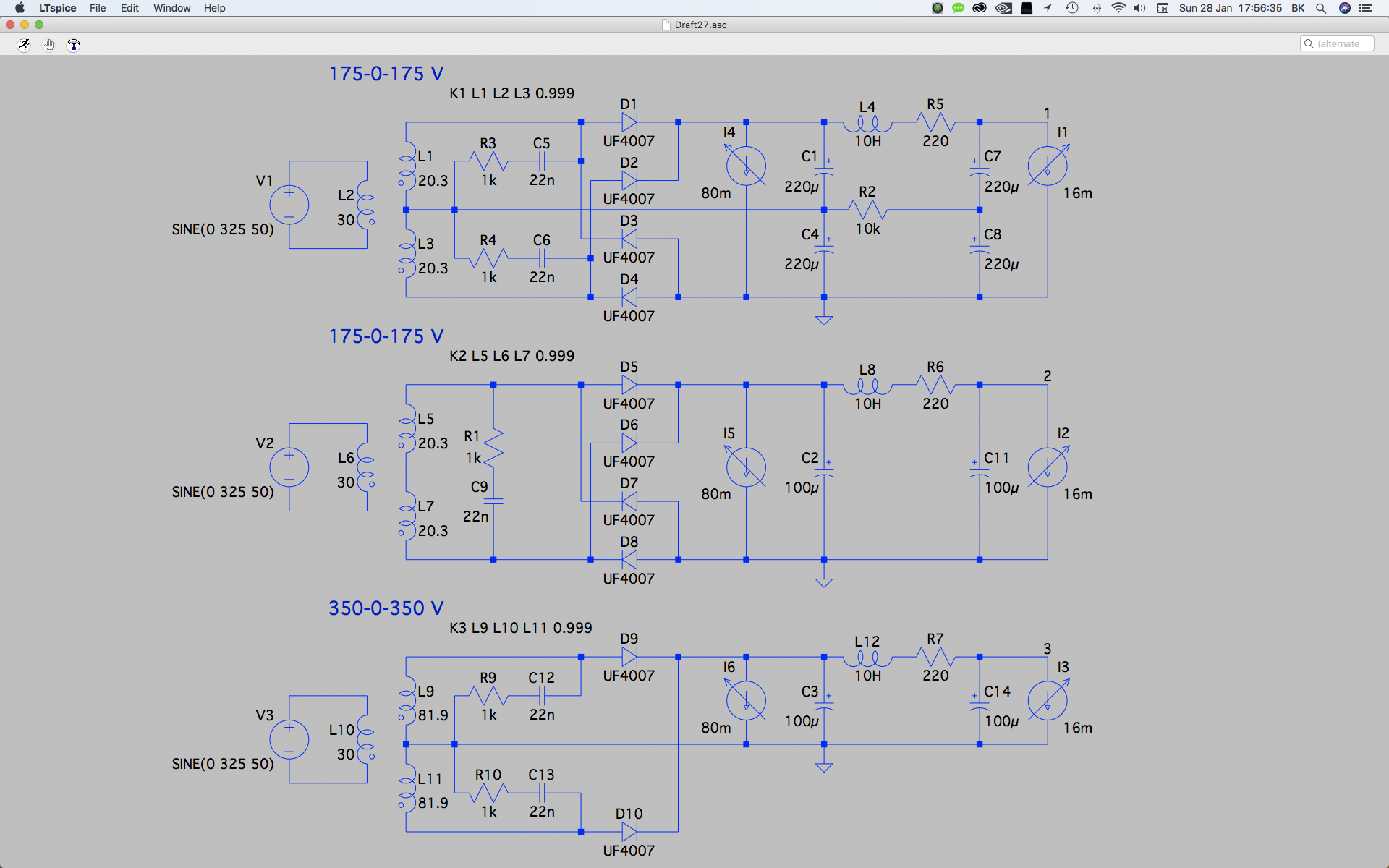

I've got another question. I'm planning to use a small Icon transformer as an inductor for the resonance network. The 42TM013-RC (1k to 8 Ohm) is sometimes used in wahwah pedals because the primary side has about 500mH inductance. IIRC that translates to 1k Ohm at 300 Hz. Am I right to assume that a transformer with a 2k secondary would then measure 1H? The 42TM002-RC is a different set of inductors at the same size. More inductance would certainly be welcome to keep the impedance peak of the resonance network narrow.
Guys, can you please help me with these questions:
1) Can I power the MOSFETS and bias with a simple C-filter supply? So no CRC, just one capacitor.
2) Can I use a 2k->10k transformer (Xicon 42TM002-RC) primary as a 1H inductor for the resonance circuit?
2) It's a three-dollar experiment. No simple prediction. Buy it, try it. Me, I'd get several models different Zs; if one misses, another may hit your mark.
1) Probably; but it isn't a big current and another R-C is not a big expense until you put this in mass production. Anyway, isn't the *point* "overkill"? You sure don't need to MOSFETs to make a hellufa guitar amp. So why stop there?
The goal of regulation was to provide a low impedance supply.... the voltage over the MOSFETs stays high enough to keep capacitances....down.

I'm planning to use an isolation transformer for the bias and MOSFETS. The last drawing I made is essentially the setup you talk about. I think 700uV will not be a problem, even through a 4x12 cabinet with 100dB/m speakers. Simulation suggests that there is much more to be gained by properly matching the output tubes, a well made OT and careful symmetric bias adjustment.

Hi Rootz, is there any design reason for:
- the lowish 100k input grid leak
- the R44/C20
- the R41/C12 and R42/C13
- the high screen voltage (488V ?)
- the R17/C17 and R38/C23 (have you done quasimodo like testing to get those values?)
- are you using a standard full-wave rectifier for the 350-0-350 main winding? You may need 2x UF4007 in series for each rectifier to give some margin.
- how damped is your plate-screen supply inductor?
- are you going to try and roll off the bass end below instrument fundamental frequency, or let all the bumps and thumps pass through for your OT and speakers to enjoy ?
- are you planning to run the EL34's at max design idle power on that pcb, and with its nearby parts?

- You mean the potmeter? I try to keep series grid resistance as low as I can to keep the Miller effect low. -3 dB at 20kHz or even 10kHz is fine of course;
- High frequency stability. Might not use it, but measurements have to tell;
- Idem for the snubber on the OT;
- Screen voltage should be fine with EL34's, but I'd like to be able to lower the screen voltage to switch to e.g. 6550's. Not sure actually how to do that. Will draw some ideas up;
- R17/C17 not tested, but a rough guesstimate. Haven't worked with the quasimodo test jig before. Just did some reading about it. Looks like I've got some more learning to do about power supplies (in general really);
- Grabbed the first model I could find in ltspice for the diodes. Been using BYV26e's (1000V/1A) in an amp with a 300-0-300 V supply. That's in a full wave rectifier. I thought that was not needed in a voltage doubler bridge??;

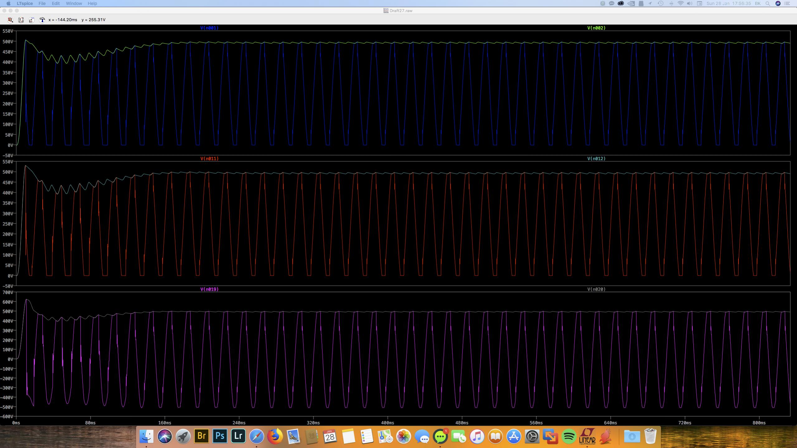

- Plate screen supply doesn't look well damped. Not critically damped if you ask me. Swings up and down a couple of times. How to improve?;
- Not sure if I need to roll of bass in the power amp. The pre amp will have some considerable roll off. It is easy enough though. I can lower the first cap to 1nF for example and raise the -3dB point a lot;

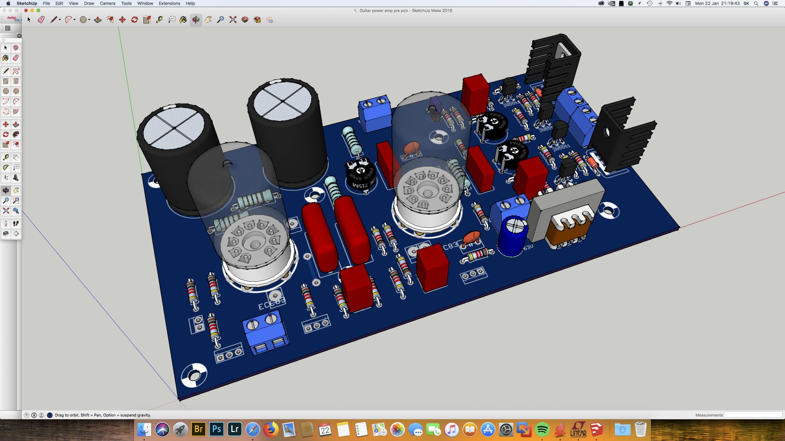

- The power tubes will not be on the PCB where the other components reside. If I'm going to use a PCB for the power tube sockets, it will be just for them and the gris and screen resistors. I happen to have three PCB's for just that and some PCB sockets lying around here. Why not use em (and hope for the best)?

Sorry for confusion about the pcb, I missed the ECC83 markings.
Above about 280-300VAC for a full-wave capacitor input filter configuration, the margin for a single 1kV PIV diode starts to get thin, and using 2x in series is an easy way to make bullet-proof.

Will investigate those diodes further. See what calculation reveals.
I could keep the input impedance on the first tube much higher by relocating the volume control after the first stage. Mesa does something like that in their 2:90. It would make the amp a bit more versatile at the cost of an extra coupling cap (outside the feedback path).
I've got some amps that sag, a JTM45 and JTM50. Currently a 1973 Super Bass on the work bench. That one doesn't sag nearly as much. Very different power supplies on all of them. This new power amp will be used with a preamp or pedals that provide all the compression I could ever use if needed. No need for a sagging PSU.
Some simulations I promised, representing the voltage over D1, D5 and D9. In both bridge rectifiers the diodes see max the peak voltage of the full secondary, so 500V. Full wave is essentially the same, but as the secondary puts out double the voltage compared to the top two transformers, they will see 700*sqrt2 when loaded and even more unloaded. That's over 1kV, so there is a need to double the diodes.
FWIW: Marshall uses a 1n4007 bridge in their 100W 1959 super lead. Single diodes. Voltages are roughly the same.
The margin get really thin with a full wave rectifier indeed. Marshall used triple series diodes in the JTM45/100 IIRC.
If I'm failing to see the point in doubling, correct me (again) please. In the mean time I'll post some proposals for the screen supply.
