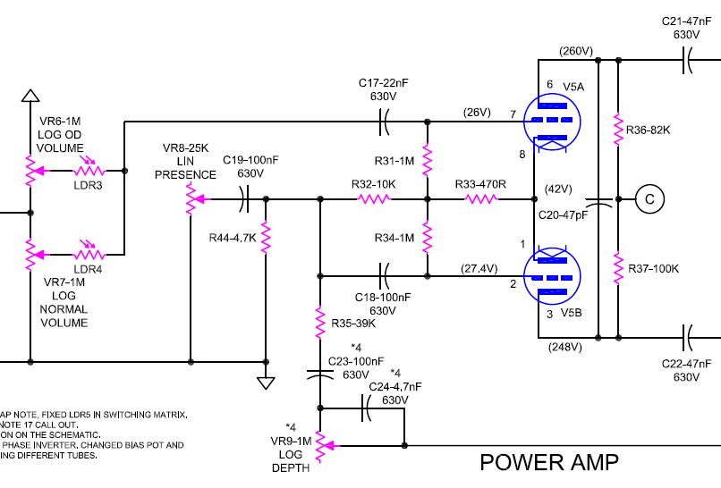

Why is this first/driver stage really needed? Reviewing the entire SLO schematic, the FX return goes directly into a cathode follower with approximately unity gain and low impedance to drive the tone stack. From there it goes to the master volume and into the phase splitter. Am I assuming wrong that the signal a stand alone power amp would receive is the same to what is coming through an FX loop? If there is unity gain in this stage and no tone stack to drive in the power amp, then why is it needed?
From there I started reviewing other power amp schematics (AX84 & Mesa 50:50) and see that they as well have a driver stage before the phase splitter. Most of which are single gain stages, and the same with any hifi amp. Any insight will be great to what I can calculate out and figure what is required of this stage. I've been reading some intro's to tube design, but I'm just getting started and need a little direction.

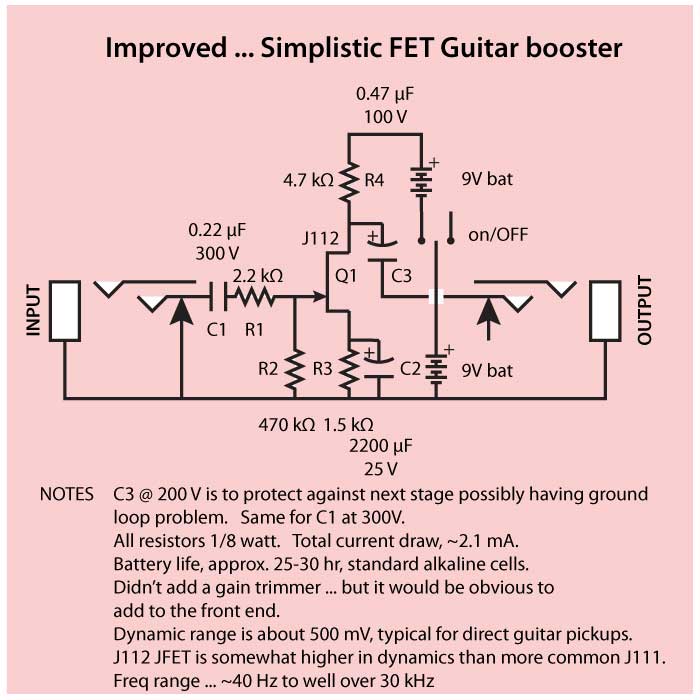

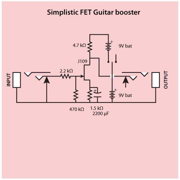

For the absolute least-trouble, you also could settle on a single FET powered by an 18 V battery (2 9V cells in series). Or, for that matter, you could purchase an EFX soap-bar box and feed the guitar straight into that. The output will definitely be 'strong enough' for input-to-the-amplifier.
The FET amp approach results in a NOT-distorted amplification of the guitar output, normally.
And it is compact.
And very, very low power.
A set of batteries will last maybe 50 hours.

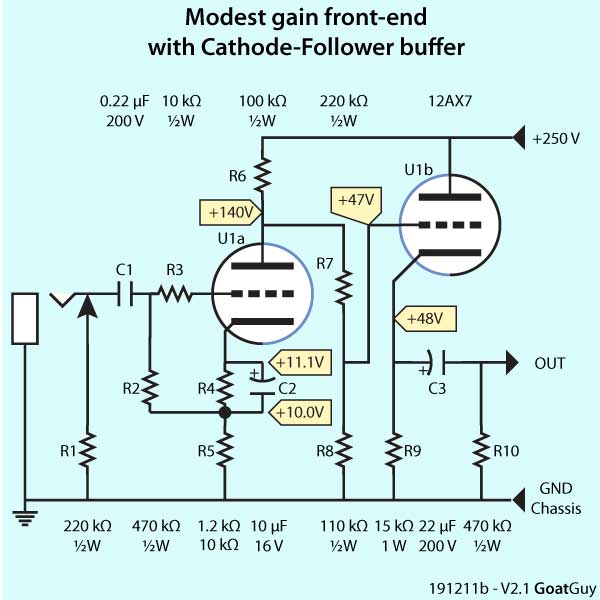

Reading your first comment again, and the one you just posted, I think I got it: you are trying to recreate the right-half of the SLO amplifier you already enjoy, to place in a standalone crate, for home use. And you're continuing to wonder why you also probably need a front-end amplification stage before the phase-inverter/splitter section.
Right?
If that's right, it is simple: one cannot expect that of the very wide possibilities of sources (instruments, etc) that will be plugged into the amplifier, that they'll all dutifully stay within the “sweet spot” of input voltage levels. I, being a musician-cum-EECS-cum-physics goat, have seen VRMS (kind of 'average') guitar pickups from below 50 millivolts to well over 1,000 millivolts. More modern guitar kit often have internal preamplifiers (often called 'direct boxes') which kick up dozens-of-millivolts of pickup output to well over 2,500 mVRMS. Likewise, I've encountered EFX boxen that suppress relatively large input signals down to handfuls of millivolts at output, or exactly the opposite: way up in the 1,000 to 4,000 mV output range.
Thing is, a long-term-generally-useful amplifier needs to handle all these ranges. It also needs to offer high input impedance to the device clicked into the input jack. It might be a conventional unadorned magnetic pickup (low impedance, but also low output), or it might be something exotic like a piezo pickup (very high impedance, but often decent output). Who knows?
The front end stage, especially when designed to acceptably take 3,000+ mV input without distorting its amplified output signal … followed by a audio-taper pot to 'tame' the amplification to something more appropriate for the rest of the amplifier's internal design, is the bog standard way to get the job done.
For this reason, I think your desire to implement a bit of a franken-amp is … a wee bit misguided. However, if the power supply for your franken-amp has a modest voltage output (i.e. somewhere between 20 and 30 V DC, well regulated and filtered!), then you could implement the JFET 'front end' internally, as shown in diagram № 2 above. Or, if you just have 'hundreds of volts', then use a 12AX7 or similar as the gain element. Larger anode resistor than the JFET, but surprisingly, the same cathode/source resistor and capacitor.

You nailed it, I have my assignment now to design the first 12ax7 stage to simply handle a 3,000 mV input cleanly. Then feed it into the master volume and copy the rest of the power section. Thank you for the help.

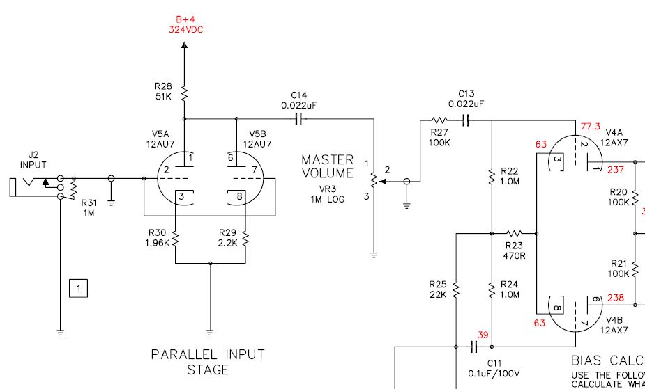

Addition, is it worth my while to look into a parallel input stage? I've read where it thickens the sound a little bit, but have never heard one before. Curious if it's worth the effort since the spare side of the 12ax7 will be sitting there unused.

...a guitar stand alone power amp to keep around the house. ...
A power amp won't play guitar.
I would NOT! want an SLO100 power stage as a house pet. (Even living here in the woods, it is TOO DARN LOUD.)
What you want is the *preamp* from guitar jack to that last jack before the power stage.
Then I would steal the last bit of an AA Champ or Epi Jr: 1/2 12AX7 and a 6V6/EL84. You can flog a 5-Watt amp in the home without cracking teeth or plaster. The SLO's complex *preamp* does most of the sound-shaping.
BTW, the SLO FX return has significant gain before the cathode follower.
That's impossible with a grounded cathode 12 AX7, unless you provide NFB to the 1st stage cathode!

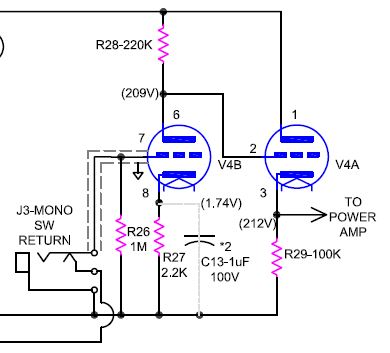

The SLO power section needs about 2V to reach full output. Since not all preamp or pedals can provide that, a extra gain stage is convinient.
I would use a large cathode resistor to withstand large input signals. E. g. 2k2 // 47uF, and a 100k anode. Add a 10K grid resistor and you are good to go 😀

Thanks for this schematics, GoatGuy!
But this ain't no real grounded cathode design, and my objections weren't against the possible gain.

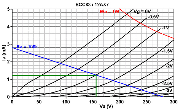

Rk = 15k, 48 V on the cathode, ergo roughly 3 mA through a half-12AX7 with only 200 volts between anode and cathode. That puts Vgk at about (-0.6 V), well into grid current.Perhaps as this, answering the ''can't do that much gain with a 12AX7 stage!'' objection. GoatGuy
The output signal can swing negative by up to 50 volts more or less, but can barely swing positive at all. Positive signal peaks will be heavily clipped and rounded-off. There will be lots of harmonic distortion in the output.
Did you intend the 12AX7 to be biased into extremely non-linear operation, a la Leo Fender's accidental Bassman design?
While this (Goatguy's) approach keeps heater-cathode voltage down to about 50V rather than 200 V, which is good for the heater insulation, it also increases anode dissipation of the cathode-follower stage considerably. Vak = 200V and Ik = 3 mA means 600 mW of quiescent anode dissipation, which is pushing a half-12AX7 much harder than usual, about three times as hard as the typical Fender/RCA gain stage with Ik=1mA and Vak=200V or so.

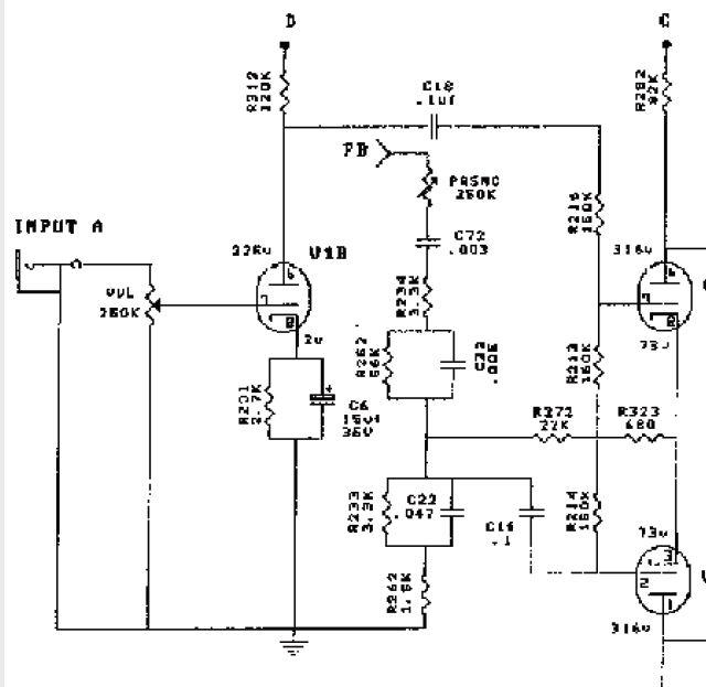

R9 is 15k in Goatguy's schematic. Not Leo's 100k (the value you showed in your image), but nearly seven times smaller.
Try drawing a 15k load-line on the 12AX7 curves, with B+=250V and Vak=200V, and you'll see what I mean! 🙂
-Gnobuddy

R9 is 15k in Goatguy's schematic. Not Leo's 100k (the value you showed in your image), but nearly seven times smaller. Try drawing a 15k load-line on the 12AX7 curves, with B+ = 250V and VAK = 200V, and you'll see what I mean! 🙂
and…There will be lots of harmonic distortion in the output.
-Gnobuddy
😉 it is, after all, a guitar amplifier … -= GoatGuy ✓ =-
That's why I asked if it was intentional on your part. 🙂😉 it is, after all, a guitar amplifier … -= GoatGuy ✓ =-
Have you listened to your circuit? I'm curious if the huge reduction in cathode-follower load changes the timbre (harmonic spectrum) of the distortion significantly, as compared to the Bassman and its derivatives.
