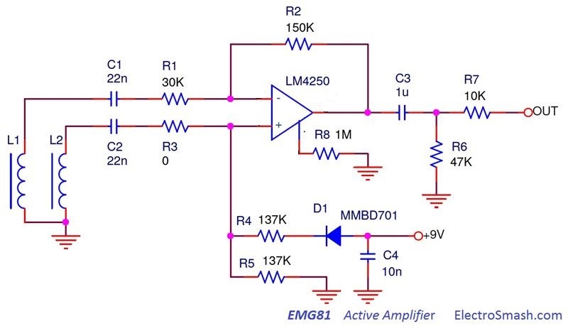

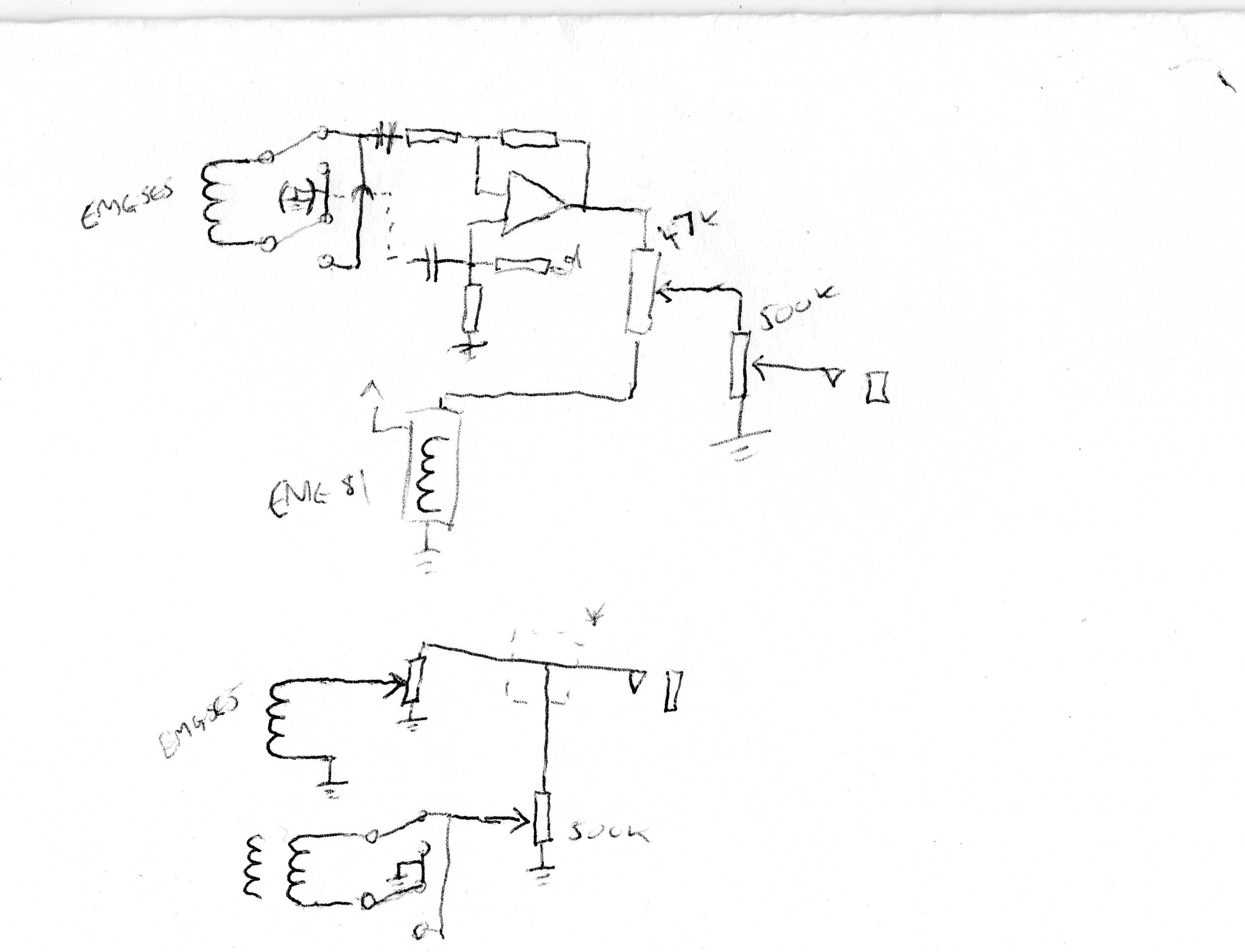

I'm re-wiring an old strat copy with 1 bridge humbucker and a slanted single coil in the neck. The single coil is passive, im not sure on using an active or passive humbucker. if i use an EMG81, I'll want a preamp on the EMGSES. I want to be able to blend the 2 pickups with a phase switch on one of them. Ive attached the ideas i came up with but im not sure on,
A) For a preamp on the single coil, should it have a ground connection, or would connecting it to the + on a differential op amp be enough? (i found an EMG81 diagram to go by, is the ground on the center tap necessary?)
B) What would be the best way to do this, and has anyone seen anything similar?

For anyone interested i went with design 1, but with a passive single coil (disguised as a humbucker) in the bridge, EMG ses in the neck, both with an ne5532p preamp. i put the phase switch on the humbucker. the blend control can act like a crude wah and can get quite a range of sounds, from metal to funk.

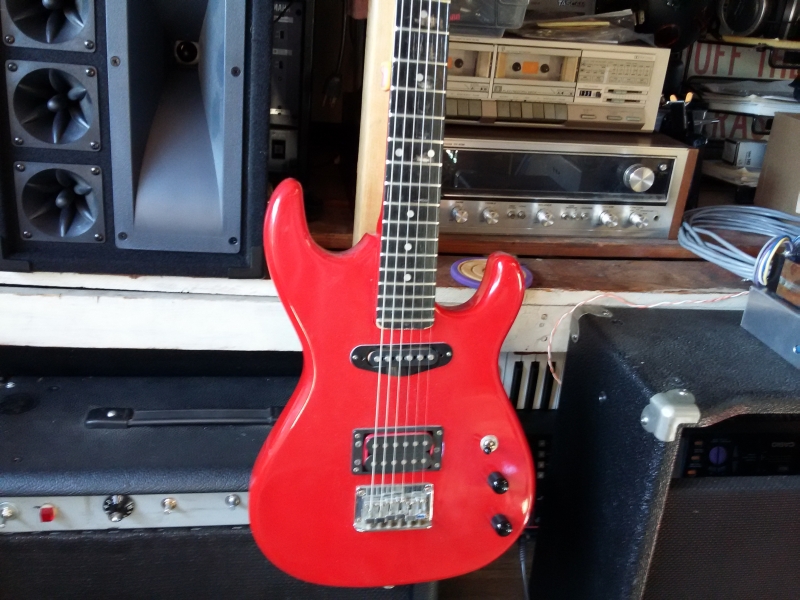

Sounds like a good setup. I was wondering how you were gonna wire them together when only one was preamp'd.... amping both (with different gain settings I presume) keeps impedances much more matched. Pic below is a cheapo (but nice playing) axe that I added a single coil to, and a Les Paul switch (I call it the Fender/Gibson switch).
It's like having two guitars in one! Have fun.
