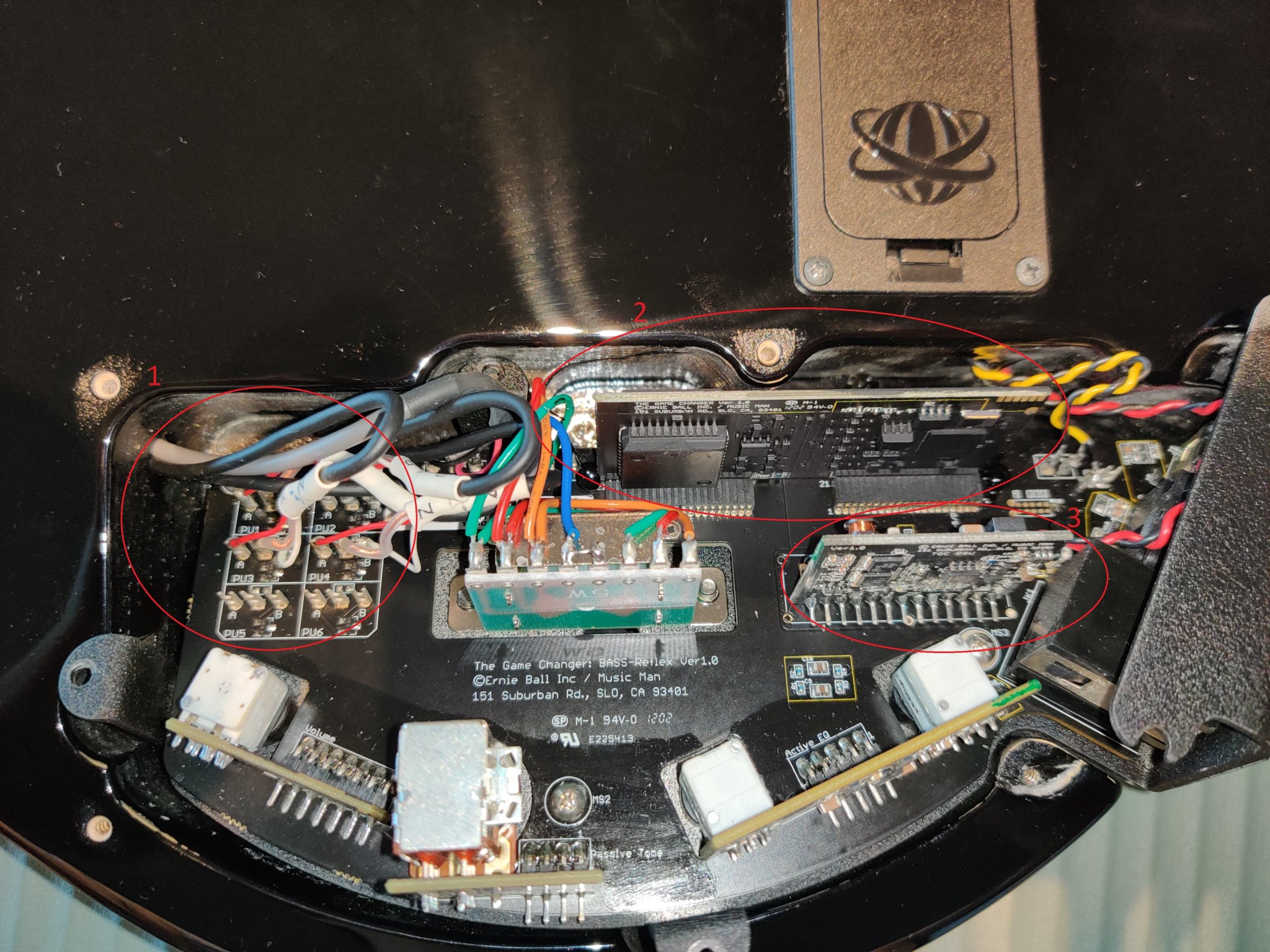

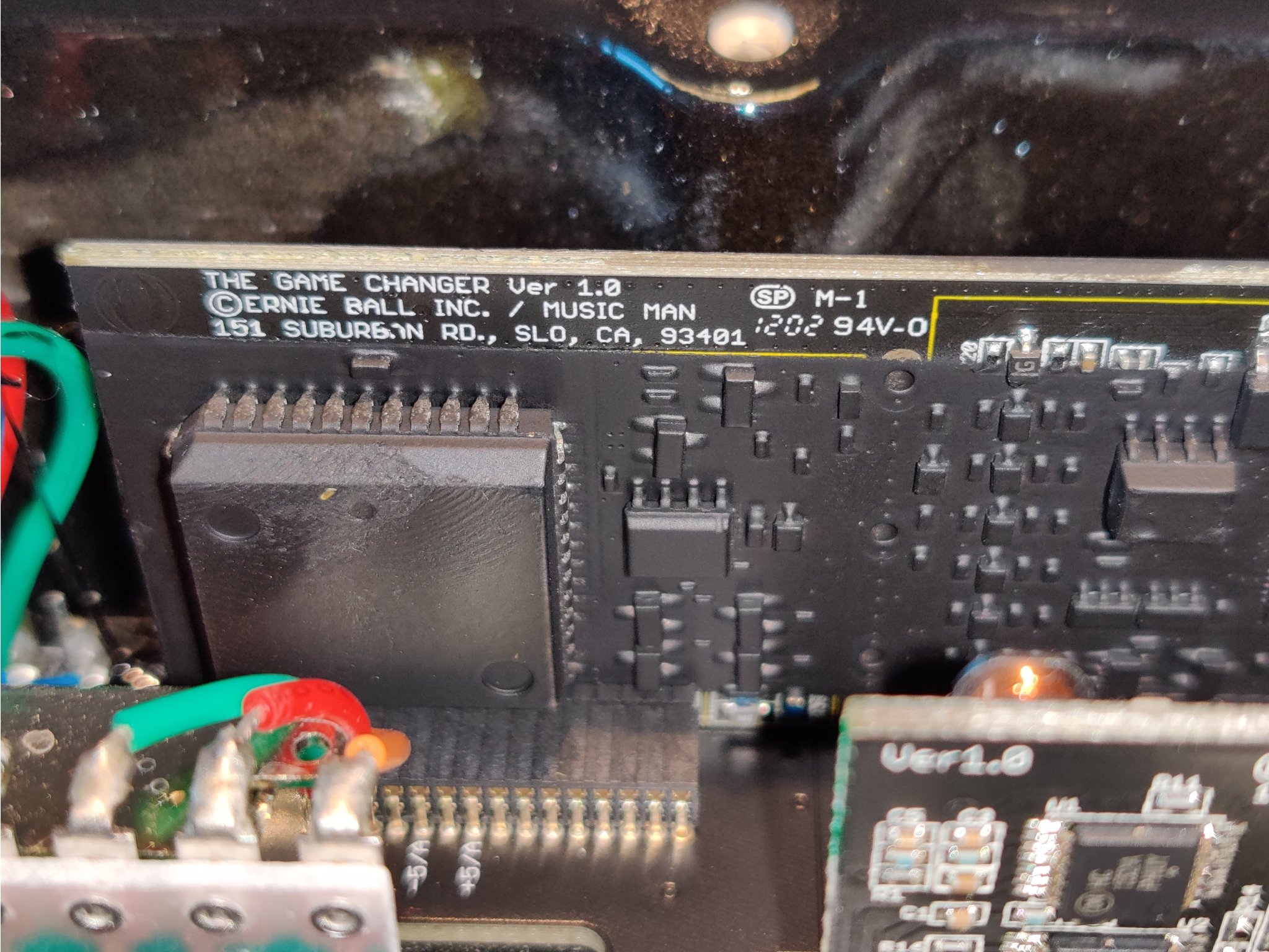

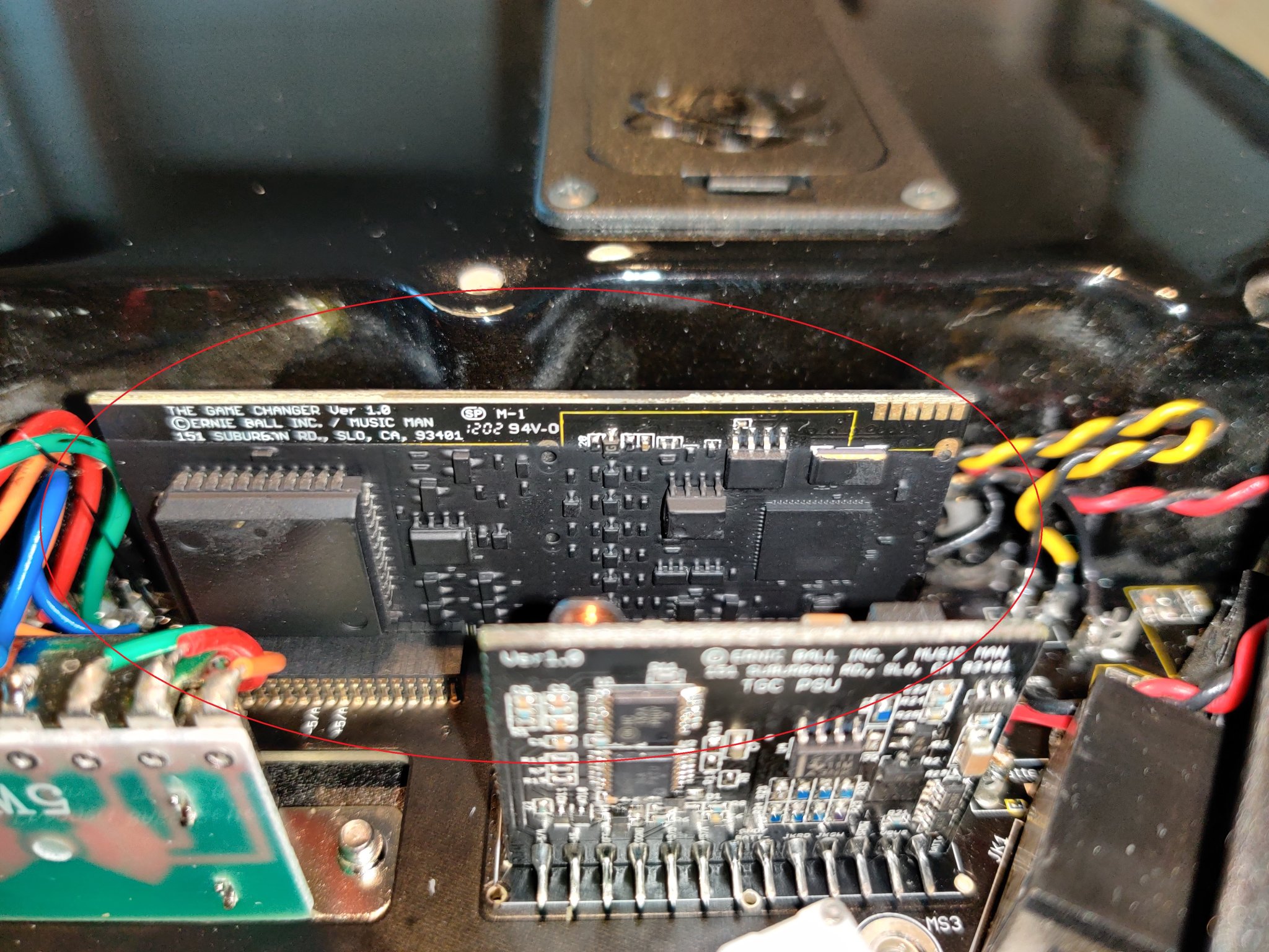

What are these HC 132A PHUY and HC 14A PXTU?
CMOS gates 74HC132A and 74HC14A - but hey - this will not help you in any way.
I would not even try to reverse-engineer this piece of electronics - no way.

Thanks! I will definitely do a reading these weekend. I hope Google translator is good for German to English 🙂

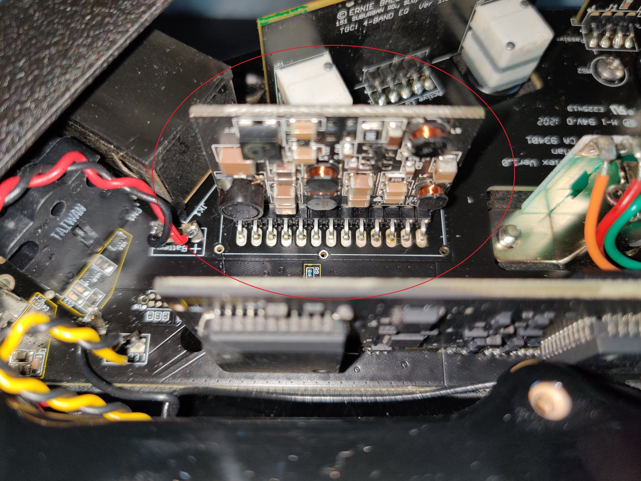

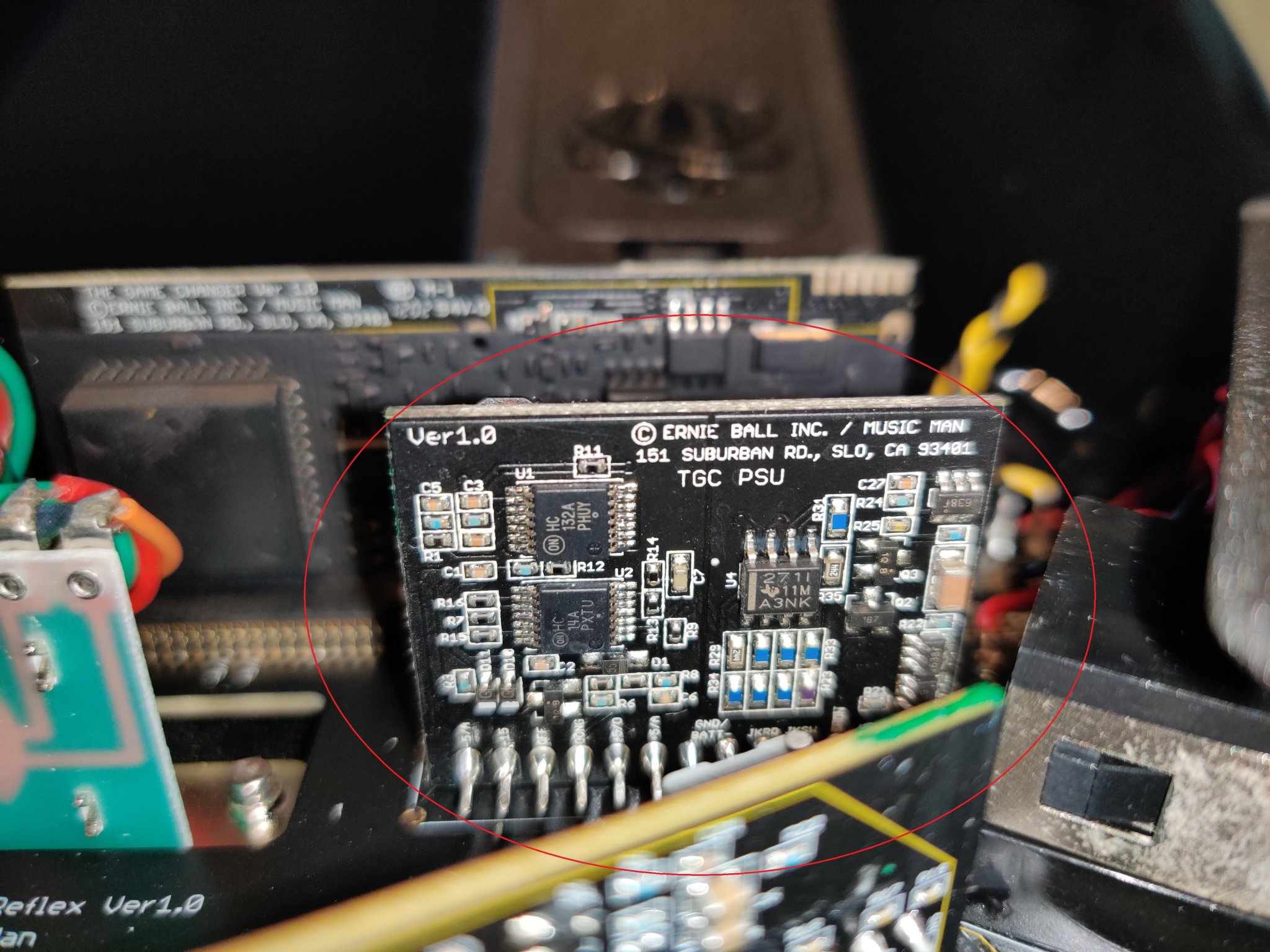

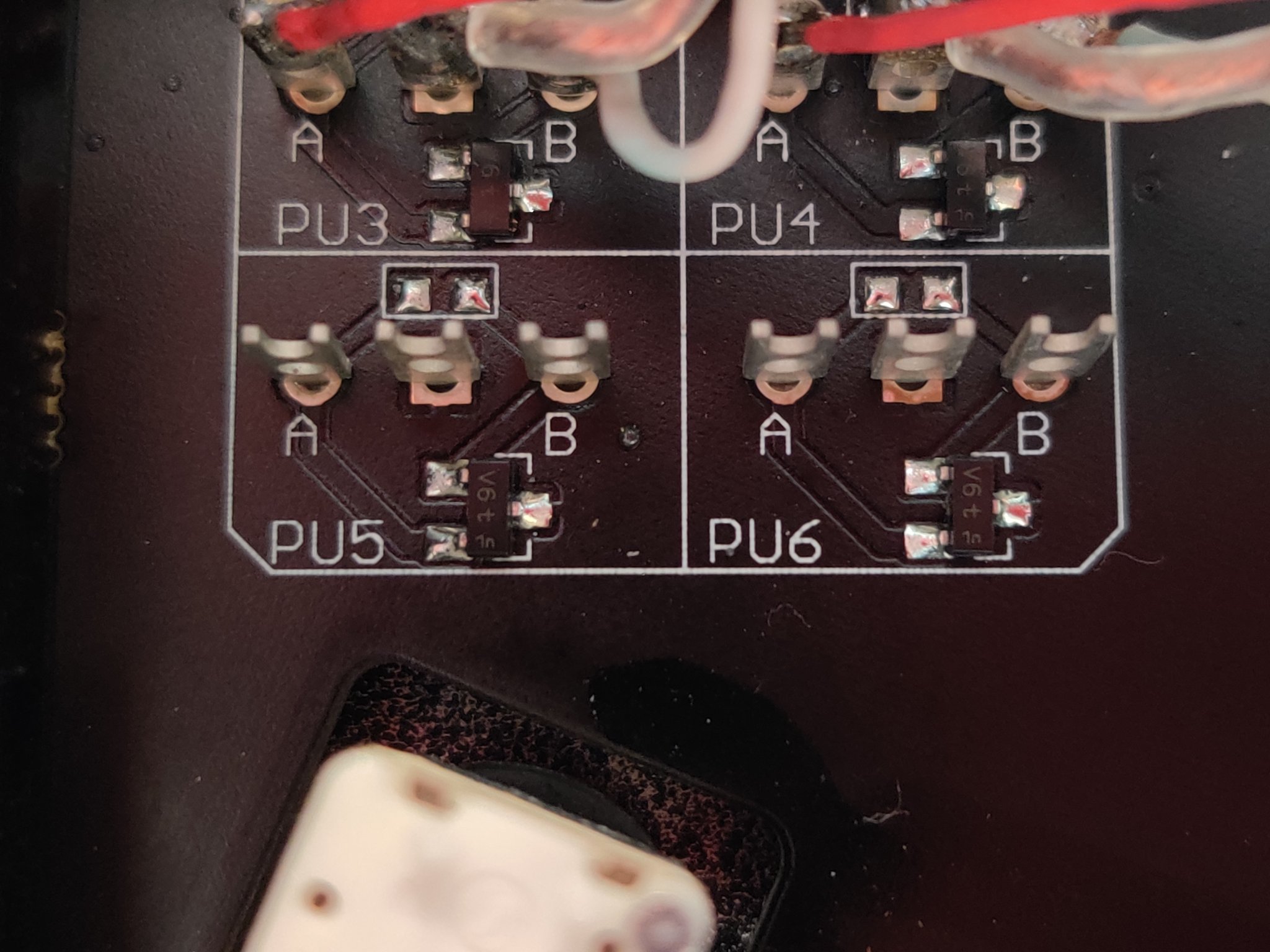

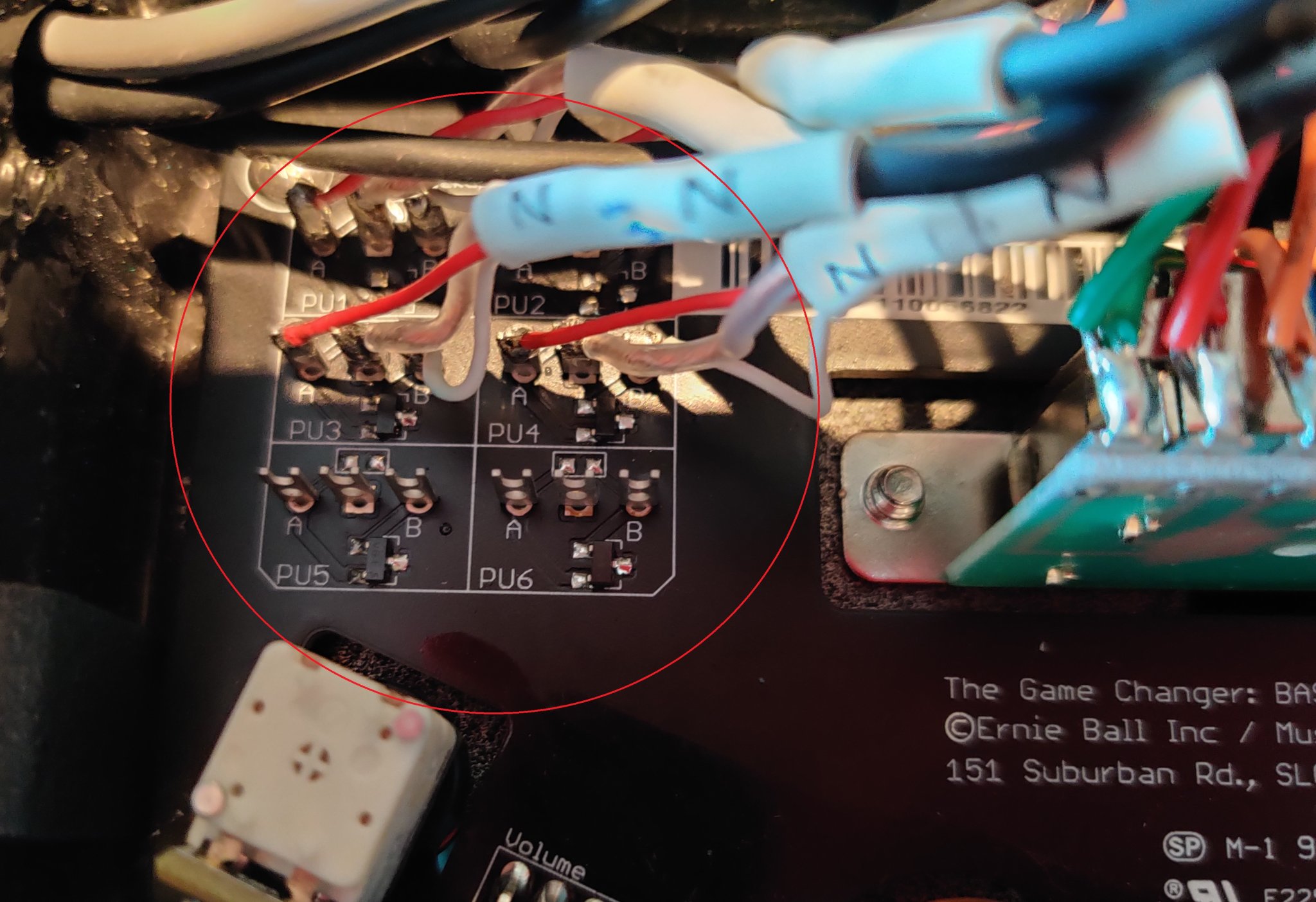

I agree, reverse engineering doesn't make sense here. Rather, I was curious to get some hints from the circuit to at least find a direction to go. E.g., the pickup connection and transistors attached to it may very well give a hint to someone who understands these things a little bit better, than me. If Music Man guys did buffer the pickups, then it means they went the road of "emulating" wiring. If not, then they do real high-impedance connection. Which means, they most probably don't use the matrices and switches.
Stupid question: does a connection of two pickups in series via the transistor makes similar sense as just two pickups in series without it? I am trying to understand, whether anything apart from a "wire" makes a genuine connection between two pickups, so they act as a "single" coil.

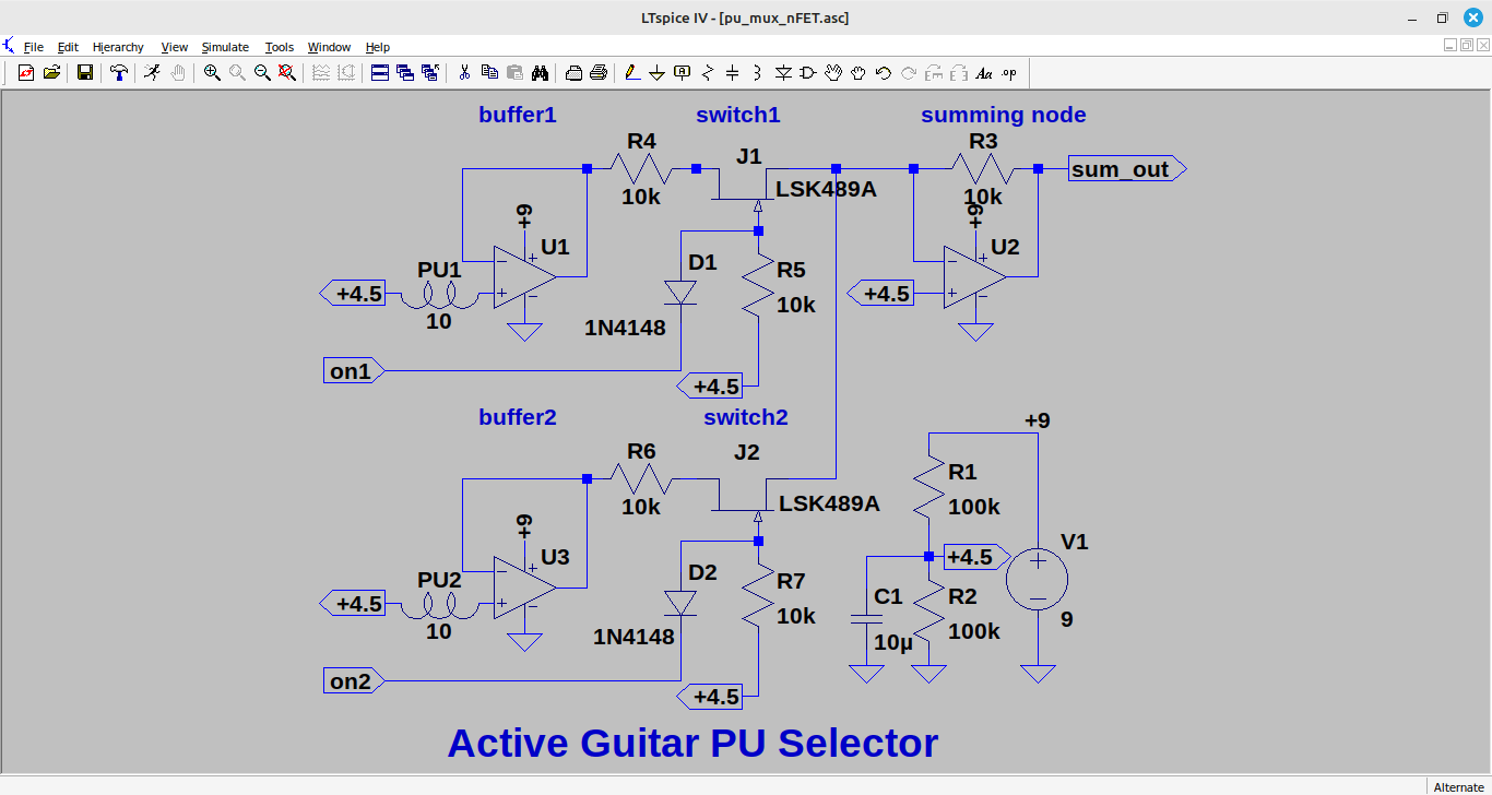

I want to raise a topic of a Guitar pickup system, where it is possible to connect them in any possible way (parallel, series, out of phase) with the help of a microcontroller onboard.
I am a little confused why you need to use a whole ucontroller system for this with analog switches?

Btw, I did not mention all issues with CMOS switches/mulitplexers:
They distort signals that come close to voltage supply rails.
They are prone to catastrophic failure due to latch-up.
There are better alternatives nowadays.
TI has a decent paper on getting rid of distortion from analog switches by putting them into the feedback path of a opamp.
Since we have buffers here anyway, that could be a nice solution.

Yeah, I saw a lot of guitar projects with dozens of switches and "kilometers" of wire inside, for all the possible options as well. But the most intriguing part for me, is to understand, whether it is possible to achieve the same with controlling everything digitally. I first had a feeling a matrix will do most of the job here, as one matrix will replace number of real circuits you would build trying to achieve the same in a conventional way. However, the more I read their specs, the more I understand they are not good for High Impedance environment and even maybe for that project at all. The inside circuit of the IC is built on transistors. And two coils connected together, are not the same as two of them connected together via the transistor legs, I believe. I don't want to put the verdict "impossible", as Music Man did it somehow, however, it looks to be trickier, than seemed originally.

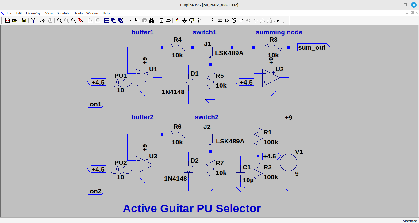

I think if I am able to find a cross-point switch array with really ultra low R-on, I will be able to deal without the need of the buffers. The one which was proposed in my original post has quite a big R-on ~35 Ohm. I saw some switch multiplexers with 0.X ohm R-on, which is good, but it means, that I still have to form a matrix from them. The only Matrix I was able to find with really low R-on has the inputs buffered, which again spoils everything, as it brings me the same problem as if the p.u.p-s were buffered.
