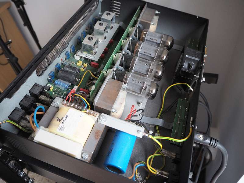

I'm new to the whole tube story, but I just wanted to give it a try. While I was researching all around, discovering the abyss of output transformers and their costs I stumpled over power guitar amplifiers.
To be specific the Engl Tube Poweramp 840/50.
It's using 6L6 as PP in the output, all composed in a 2HU 19" case.
All that for €500 in good used condition.
To the ones who know: To me the OTPs seem a little small for 50Watts of output power and above all, simple EI cores.
What is to expect from them? Are those instrument amplifiers even specified for (almost) Hifi, so roughly 20Hz to 16Khz?
Could that be a good basis over all the chinese amplifier kits?
Or are the OTPs not up to the HiFi job?
BR, Markus

Looks like a bad idea to me. Who wants a guitar amp working linearly from 20Hz ~ 20kHz? Nobody.
HiFi-amplification != guitar amplification.
And, btw, this is a mono amp as well.

I understand guitar amps are designed to have a limited freq response range, a non-flat freq response and to generate distortion. The OPT is usually undersized to reduce weight, reduce cost and help produce some distortion to boot. The premise of a modern guitar amp is the antithesis to a hi fi amp. It’s mayb3 possible to mangle a hi fi amp into a guitar amp but there’s no sensible path the other way around.

Low note on guitar is 82Hz. And distortion IS allowed: a guitar speaker won't project 82Hz nearly as well as its harmonics. Harmonics add music emphasis to the dull tone of a naked steel string. The Engl player would surely work with a bassist, who dominates the tone up to ~~250Hz. So the guitar OTs can be much smaller and lighter than a "hi-fi" claimed to be "perfect" to 20Hz (more likely 45hz).

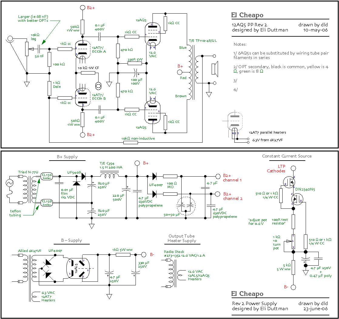

Markus,
You can employ the "tricks" we relied on, at the start of the "El Cheapo" project to squeeze OK, if unspectacular, performance out of the O/P "iron". The provided graphic shows Fender "Deluxe" replacement stuff.
Triode wire the O/P tubes and bandwidth limit bass extension at the I/P of the circuitry.
Those O/P tubes are probably 6L6GC or KT66 specimens. If they test strong, they can be sold for a few €. Passing less power into the O/P "iron" to improve its bass performance is necessary and moving down in the 6L6 family to Russian 6Π3C-E (6p3s-e) stock, a 5881 equivalent, seems good to me.
Tried and very true Mullard style topology would fill the small signal circuitry requirement, while exploiting the 3 Noval sockets.
The Engl output transformers are tiny even in guitar amplifier terms. My younger son has got a Fireball 60. When I opened it by chance, I stumbled over it's OT that is small even if it were for a pair of EL84's in hifi use.
But there are/were guitar amps as well with OT's that were apt for hifi use as well. Hiwatt bought their Partridge transformers right from the manufacturer's hifi and studio equipment line. The early DR103 OT's even featured a 100 V line secondary.

Definitely use triode wired 6Π3C-E "finals", to obtain reasonable bass extension. FWIW, the lowest note a "standard" double bass makes is 41 Hz.
Engl have the smallest OPTs in that range.
It is also true that the cut alot on lows to give definition to the amount if gain they have.

Well, thanks for all your thoughts. Its a pity that a decent OPT would probably not fit inside a 2HU case.
I wouldn't mind the factory input stage, that I'd probably replace by some kind of aikido + phase inverter.

Toroid OPT’s could well fit inside a 2HU case (88 mm). Look for example at Toroidy’s toroids.

Look here. Toroidy's offerings seem to be a fixed 80 mm. in height. That's a very tight squeeze into 88 mm., when mounting hardware is taken into account. A possible solution to the problem would be a cosmetically attractive "acorn" nut on the outside of the enclosure.
I know it’s tight, but it could work. Measure carefully the exact inside dimensions of the casing before purchasing to be sure.
