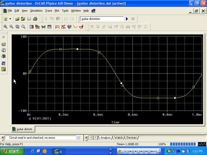

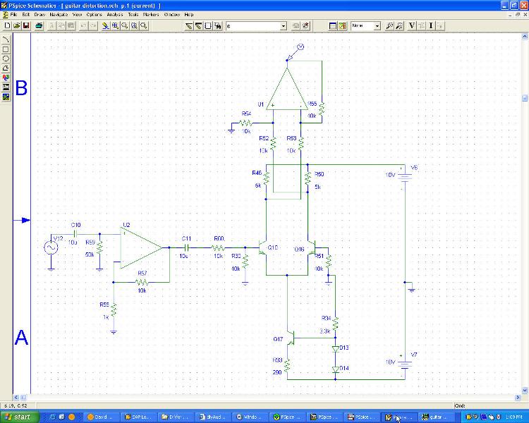

Tha's a mild, very mild overdrive... 6dB or less beyond clippping... real distortion sit's between 20 to 40dB beyond clipping...
I see it has a somewhat soft clipping charateristic.. som people might like that... but...
I wouldn't expect it to be very usefull, usually the tone networks in a distortion effect are more importand than the actual clipping mechanism..
It seems to distort more as I push it harder but keeps the soft transistions.
I haven't built this yet because I have no parts or lab equipment, but it is all on its way.
It will be a month or two before I get equipment, but I will put my results in here when I have made it.
you centanly got my attention.. and I'll try it too in my simulator.. maybe I'll make a breadboard proto...
