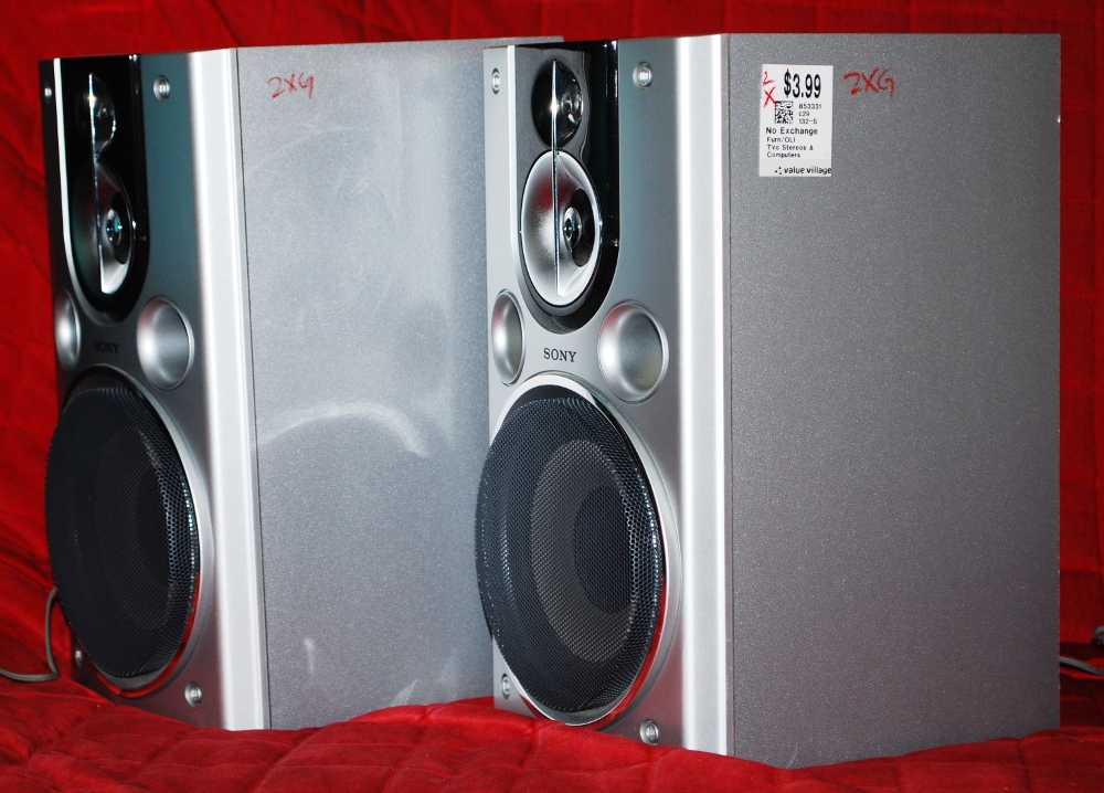

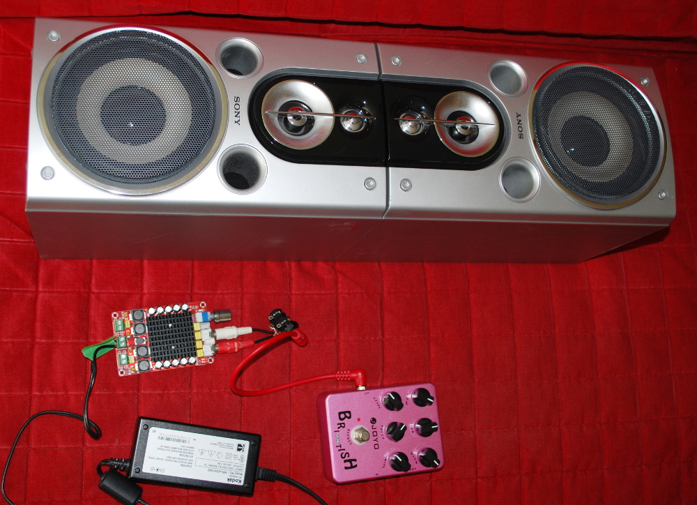

You are in the perfect situation to slap together a low cost, quick-n-dirty, solution that will get you playing and having fun immediately, while you ponder the perfect setup you're going to build eventually. 🙂I got a laptop with GuitarRig on it so rather than buy an amp...
The attached pics show you what I put together recently with mostly thrift-store-refugee parts. It started with a pair of Sony speakers for $3.99, and a Kodak 24 volt 1.8 amp switch-mode power supply for another $3.99. Add a cheap class-D power amp board, a home-made 1/4" jack to RCA plug adaptor, and a Joyo American Sound or Joyo British Sound pedal (both had been sitting in my closet for years.) Voila, instant home practice guitar amp!
This one will get a little additional development. The power supply has now been replaced by a battery pack for outdoor fun in a park, and I plan to add an XLR jack or two for microphone inputs soon. But it is usable now - I was noodling around on it just last night.

I suggest putting a resistor in series (say 1k), and an electrolytic filter cap across the preamp supply rails (say 100 uF.). The cap should be rated for the full DC voltage with a little safety margin, so 35V minimum, 50V better.Still unclear how to attach the pre-amp, power wise... it's 12-35v so within range, do I just split the power coming from the psu and run a pair of wires to the amp and a pair to the pre-amp?
You can solder a 0.1 uF ceramic cap (again, rated 35V or more) across the preamp power supply rails as well. At very high frequencies, electrolytic caps don't behave well, and the little ceramic cap will take over and keep things stable all the way up into the radio frequency band. (Modern solid-state circuits like these are quite capable of oscillating at radio frequencies, so keeping them stable up there is quite a good idea.)
This forms a simple RC filter that will help to keep things stable - otherwise the power amp creates fluctuations in the DC supply voltage that leak back into the preamp, and may cause oscillation, howling, whistling, motor-boating, etc.

I'm using one of these: https://www.amazon.ca/Yeeco-Channel...5?s=electronics&ie=UTF8&qid=1528402069&sr=1-5
Though the ad copy says "DC 15 - 34V", I found 32V filter caps on the board. I'm running it with either a 24V power supply, or a nominally 20 volt battery pack for off-grid use.

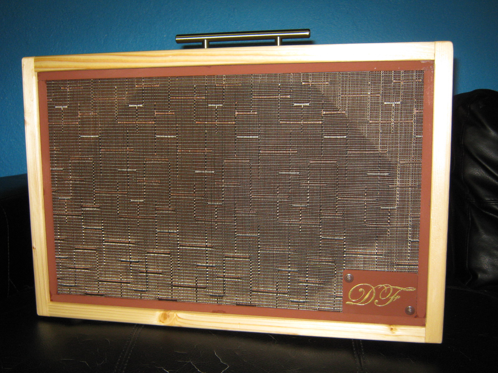

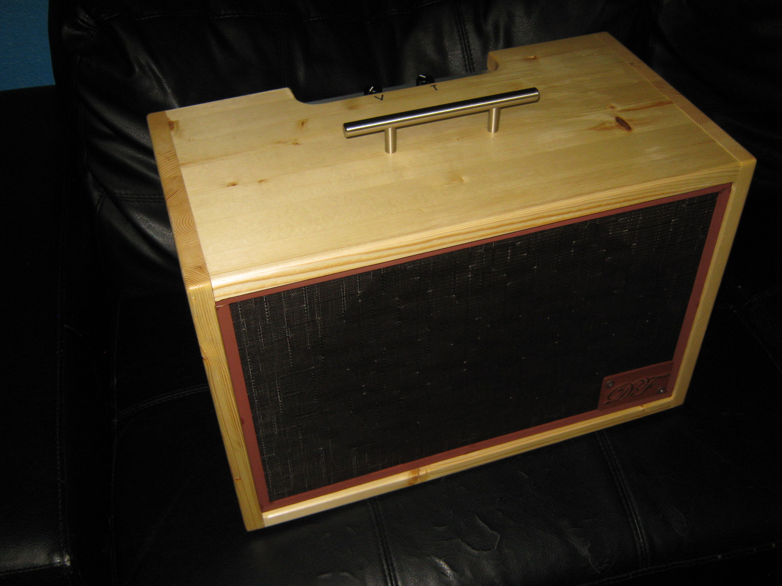

The pics are of an amp I built recently to give a friend. The grille-cloth is a dollar-store place mat. I built the cab from knotty pine.
The grille is actually quite opaque in real life, it's just the camera flash that lets you see the plywood behind it. That wood is completely invisible under normal circumstances.
The letters "DF" are my friends initials. 🙂
