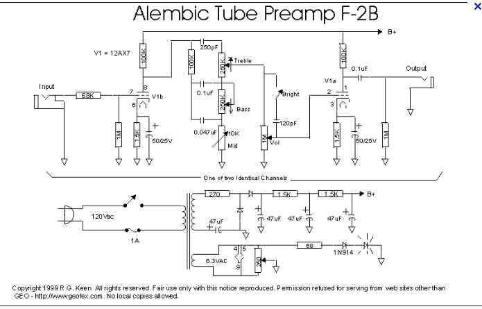

I need advices about a Guitar Bass Preamp Project :
It's not a preamp into the guitar bass project
-1- Tubes ,Op amp or Transistors
-2- Kit ,DIY ,Commercial
-3- Examples
S-PRE - London Power Spectum Bass Preamp Kit
Alembic tube preamp F2B ( pictures )

I would like a bass preamp to be connected to my Headphone AMP.
I would like a "pure" sound with no saturation .
I am interested by a tube preamp project like this one S-PRE - London Power Spectum Bass Preamp Kit
In fact i have no precise idea 🙂

If you're looking for clean sound it doesn't matter much whether you use tubes or solid state. And tubes complicate the power supply, requiring a slightly special transformer, and take more effort to make the chassis. They also run hot enough that if you touch the box, you can burn yourself.
Against that, they do sound very nice. But a transistor or op-amp can sound pretty good, too, with a lower output impedance (100kΩ will make it sensitive to the output cable), smaller, lighter, cooler. And with more flexibility on equalisation, maybe, for use with phones, a touch of compression to stop it blowing your eardrums. The circuit you've suggested looks quite nice, though I can't judge the tone controls without building one - only thing I might do is add an input capacitor so any source with a DC offset (like a stomp box) would not upset the biasing. Oh, and being me, change the input resistor to 3M3, instead of one megohm. (I'm a fanatic for high input impedances on basses).
