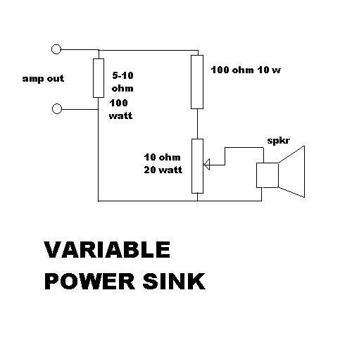

Hi All .My question is can I just buy an old nonintegrated mono tube amp and plug my guitar in somehow?My marshall valve only sounds good when the windows are rattling and the neighbors are pissed off.I'm thinking make a little speaker cab with a good 8inch and solder a rca on the end of the guitar input???Thanks Mark Walls

actually it's very simple to build a "power sink".....
get some dummy load resistors (exact 8 ohm value is not critical, since you're not doing measurements). wire them across the output. then in parallel with the dummy load, build a series string of a 100 ohm 5w resistor and your speaker of choice. power out to the speaker will be between 1/10 and 1/8 of the amp output. if you wire the speaker to a 20 watt crossover potentiometer (usually 10 ohm 20 watt wirewound) you can make the speaker level adjustable.
like this:
