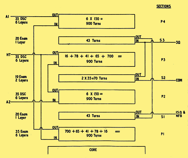

zintolo
we appreciate the values you have shared,is it possible for you to draw or sketch the connections like in this attachment

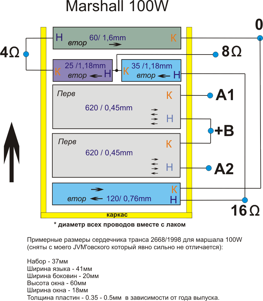

ok i see,can somebody please help translate the specs below the picture,fig in mm😀
It is drawn like yours: H is beginning (начало in russian) of the winding, K is end (конец in russian). You also have the arrows showing how to do it.
thanks,i think the fig. below in mm was lamination specs,can somebody please translate😀
Diameter of all wires is shown with varnish.
The approximate dimensions of the core are 2668/1998 for Marshall 100W:
Set - 37 mm
Width of the tongue is 41 mm
Width of sides is 20 mm
Window height is 60 mm
Width of the window is 18 mm
Thickness of the plates is 0.35 - 0.5 mm, depending on the year of production.

using wolpert formula,can someone teach us how dagnall c1998 came up with 620+620 primary.............
np=E x 10^8 / 4.44 x Ac x F x B

Assemble known data. (Why do you expect US to do this??)
Many cores listed above are near 38mm square stack. This is 2.24 square inches.
Lowest note of guitar is nominally 82Hz. Whether we need full power at 82Hz is a musical question, not engineering.
If you have 490V supply you have say 440V peak or 880V p-p one side, which is 314V RMS one side. 630V RMS both sides.
I am NOT a transformer designer so some of this is WRONG.
As an extreme guess, iron can take 10,000 Gauss which seems to be 64,000 lines.
Bottom of fraction is 4.44 * 2.24 * 82 * 64,000 is 52,194,509
Top of fraction is 630 * 10^8 which is 63,000,000,000.
63,000,000,000 / 52,194,509 gives 1,207 turns. 1,207 is "exactly" 620+620=1,240 within the coarseness of our assumptions (82Hz, 440Vpk, 10K Gauss).
