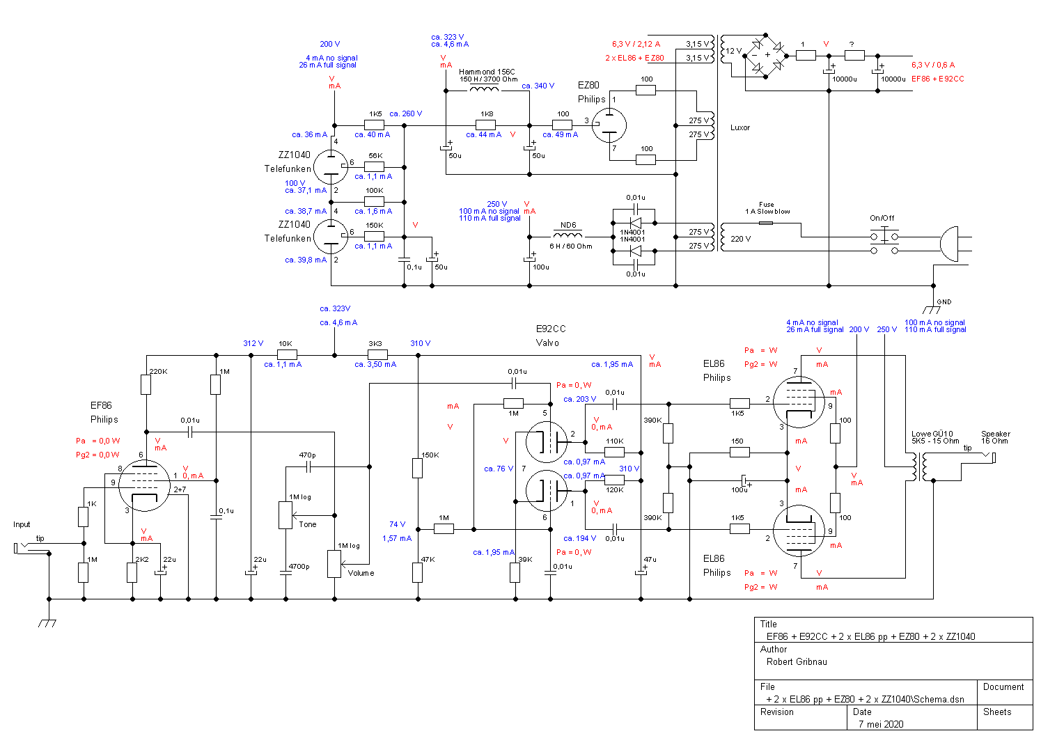

For some time now time i've been planning to make a guitar amp with 2 x EL86 (= 6CW5) push-pull.

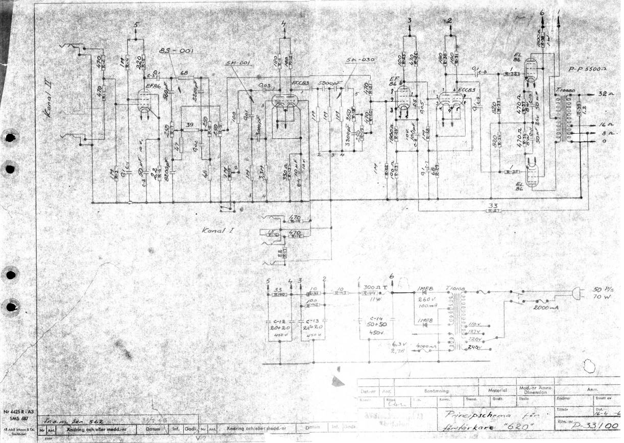

I looked at the schematic of the Hagström 620, which has 2 x EL86 in push-pull but i do not trust the schematic i could find on the internet. The screengrids are being fed straight out of the rectifier section, while the anodes are being fed from a point after a fuse and a resistor. I can hardly believe this to be right. If that fuse would blow, it would probably take the EL86's with it.
Because i allready have built a guitar amp with EF86 + 2 x ECL86 pp which is based on the clean channel of the VOX AC15, i now want to build a similar amp with EL86's, so i can hook the two amps up in stereo.
According to Philips datasheets, two EL86's in pp can produce 18,5 Watt at 4,5 % distortion, with Vba = 250 V and Vbg2 = 200 V.
Because the current for the screengrids varies a lot between no signal (2 x 2 mA) and full signal (2 x 13 mA) i plan to stabilize the screenvoltage with 2 ZZ1040 voltage stabilizer tubes.
I want to use the E92CC as the phase inverter because of the chassis i plan to use. The schematic for the phase inverter comes out of a Philips datasheet for the ECC40. Not exactly the same tubes but i am pretty sure it will work with an E92CC.
So here is my plan. I am a bit unsure about the 100K resistor that is connected to the point where the two ZZ1040 are connected to each other. I think this resistor is necessary for making sure that both ZZ1040's will start up.
Any suggestions?

You're right, fusing only the plate supply is a no go! Anyway, I'm convinced it's just a drawing errror: The 6 and 1 should be swapped in the amplifier circuitry (upper right handed corner).

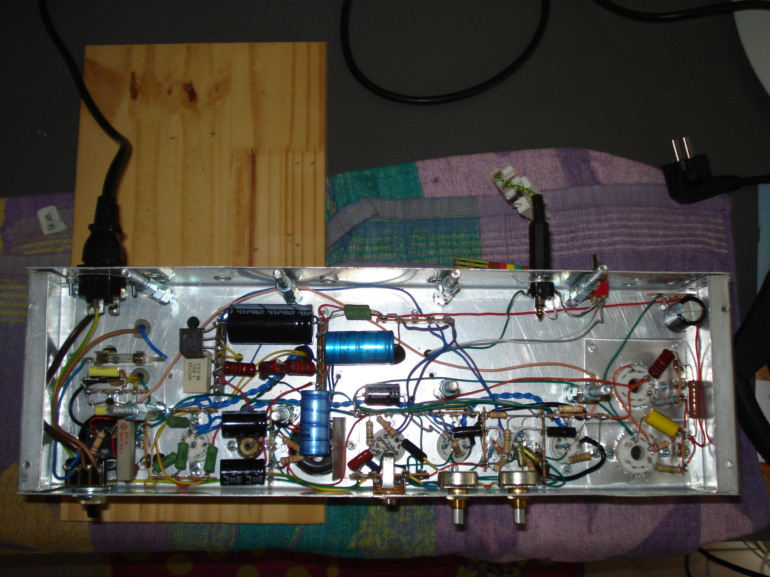

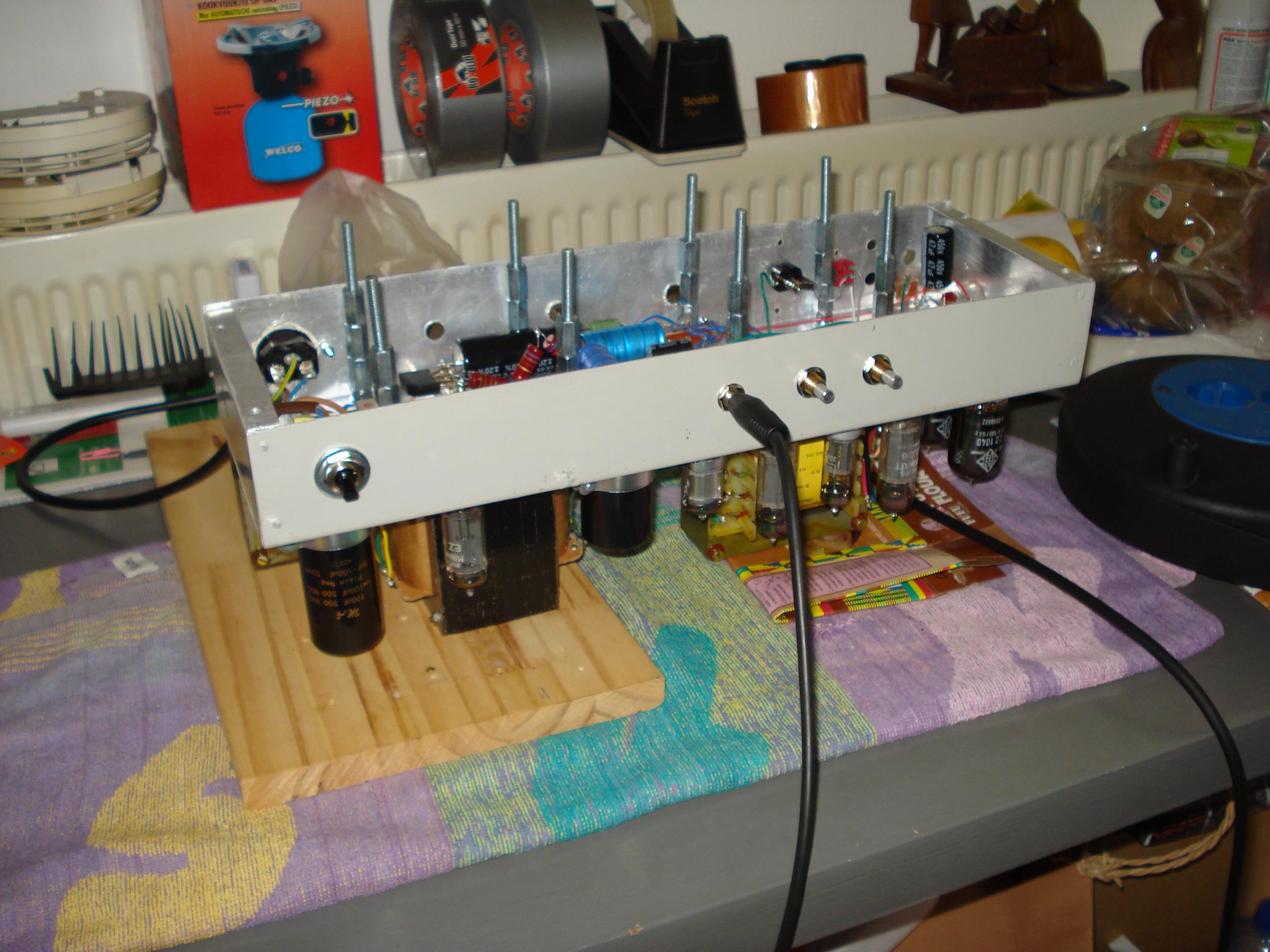

The electronic part of my guitar amplifier is finished and is working very well. The ZZ1040 stabiliser tubes give of a lovely light-purple glow that diminishes a bit if you give the guitar a good hit.
