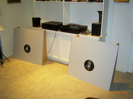

I have a pair of OB baffles I liked with Peak 8CX50's fitted. Maybe I should just bore out the holes?

Enlarge the holes and give it a whirl. If they (the 10s) don't turn your crank, make an acceptable "beauty ring" for the 8s to return to their homes.
I am in love with the wide and low (JE Labs style?) OB. I have a pair of 8s on a face 24" tall by 36" wide with short wings. The baffle is leaned back 8 degrees and I feel I could go farther next time. The imaging was just a tad low, so I experimented with a 3" by 10" chunk placed horizontally across the back near the top; I had seen someone comment on this before. It makes a subtle difference in many ways, combining to make a big enough difference to be well worth it. Imaging didn't exactly move higher, instead the speakers disappeared a little more, they tended to be more involving. In addition, midbass improved, giving an overall improvement of what I was calling slow or a tad muddy bass. It appears that they are a little louder, too.

I played the 8's in OB for a local GTG some time back, and while the feedback was generally good, one person did comment that they found the soundstage too low. (Your description of your OB sounds much like mine ... which I got off a japanese site.)
I think I'll knock together some pieces of chipboard to make a temporary base on which to sit the existing OB's. If I like what I hear then I'll build some new OB's from scratch.
This may take a week or two to achieve, but I'll get back to you with opinion & pics.
