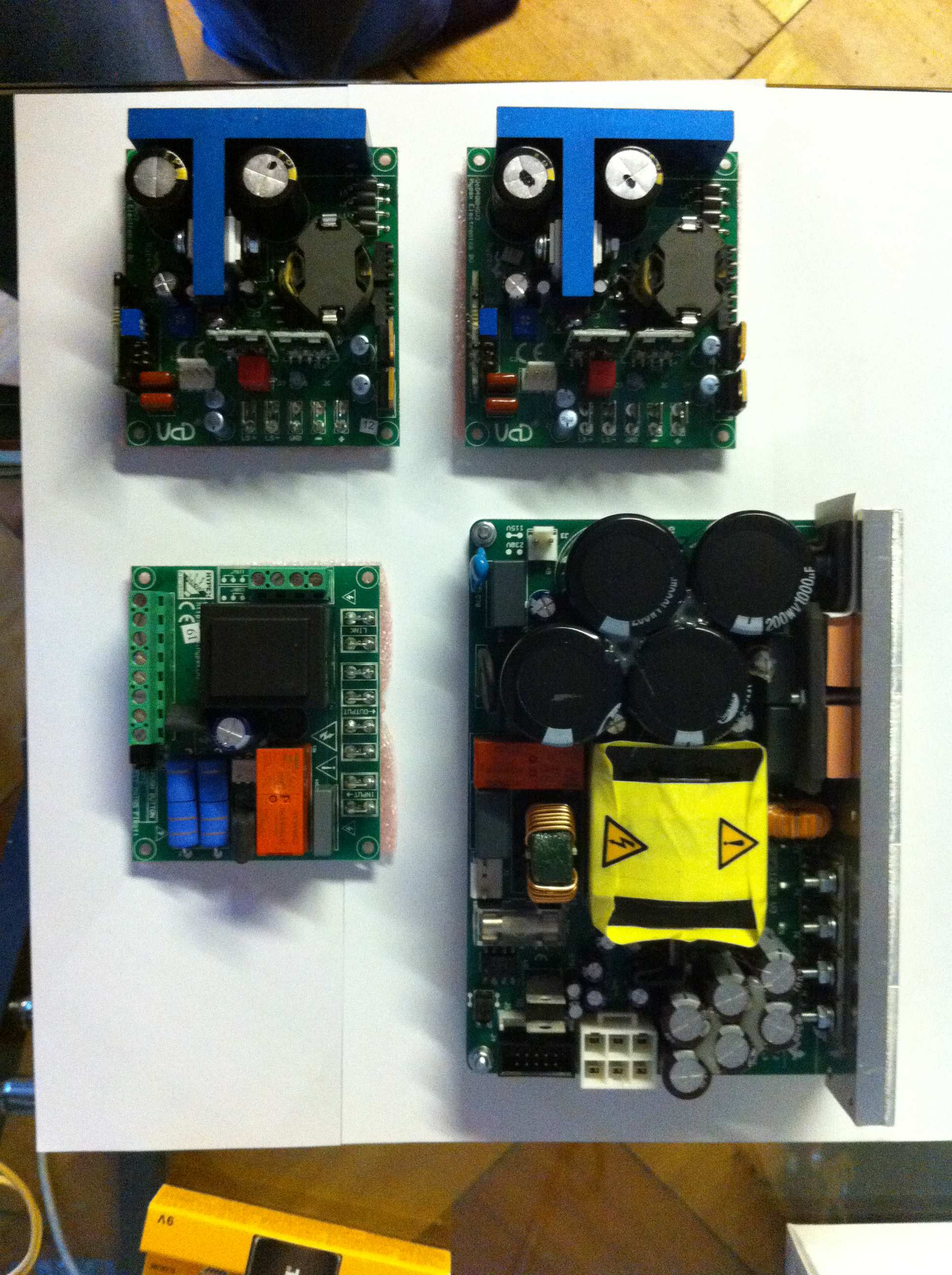

I am absolutely a newbie in amp diy but as i had read all the positive treads about that than i decided to try this way too. So after analising what it is going on the market i bought some modules from hypex (2 Modules UCD 400 Hrx, Softstart and the SMPTS 1200/400). i wanted to have best quality and a easy to build. Yesterday i got them (thanks to hypex, very fast and safe delivery-perfect!). Now i am not sure if this is so easy to put tem together. i am quit familar with building PC stuff, but this seems to be a it more complicate...and also more dangerous. So here my question. Is there somewhere a guide (with pictures?) to put these modules and all the connections (RCA, XLR and LS bindingsposts) together? I tried the search function but i could not find something like that and i guess there are a lot people who will appreciate a detailed guide.
So i would be very pleased to get some help. Thanks a lot.

First I would test SMPS and Soft start, so that you know everything is ok with supply
You put AC to softstart, then out of softS goes to smps AC input.
That I think should be enough to produce voltages (don't know if there is any minimum load for smps)
If it gives rated voltages, then connect one of the amps, after supply has been turned off for "1min" (to discharge capacitors). Then you have + and - and gnd to conenct (there also could be some other, if amp needs more then only main voltage)
Speaker connected to output (at least some 4-16R resistor), no input connected yet...
power it up, and check that there is 0Vdc offset on output
If so, turn off supply, add input to amp, find 50Hz test tone, low volume on source
10% would do... turn on smps... and check that you read some AC voltage... if you do, you can replace resistor with speaker, if you don't already have
Do the same with other amp (one at the time, so that you know they both work)
And that should be it

what kinda picture are you looking for(I mean I know what you want, but picture won't make it any more clear... but if you feel that it will, post the picture of smps and amp on the same one... and I guess we can draw some lines up and down), isn't there any from hypex?

So i will go with softstart. Now, unfortunately i could not find anything "draw" from Hypex (they should do that....a lot more potential customer would appreciate such a help!).
So Luka, i will put a picture just below. tell me if this will work.
Regards

Ok so here it is
Do NOTE, that I would only connect smps alone, and measure if output voltages are on the right pins. That is on J1 on smps, 2x3 pin connector,
top right pin should be GND, upper middle one +Vcc and bottom middle should be -Vcc. If this is right, then you have something like this
This would be minimum that you need to connect
Red is +Vcc
Black is GND
Blue is -Vcc
On the amps, J1, you need signal on pin 1, left one, and pin next to it, which is signal GND (note that it doesn't say, which is pin1, but you can measure if pin 2 (gnd) is connected to supply pin GND J5 on amp)
There could be something else to connect, so somebody else should check what I did, and let me know if it is not ok, so I can change it and repost it (I'll delete this picture and replace it with corrected)

I thnk this looks corrrect...
However - pin 4 on the UcD's input connector needs to be connected to power GND (the black wires on the drawing above), or else the UcD modules will not power on. This is the pin that is to the right on the input connector, close to the output pins.
