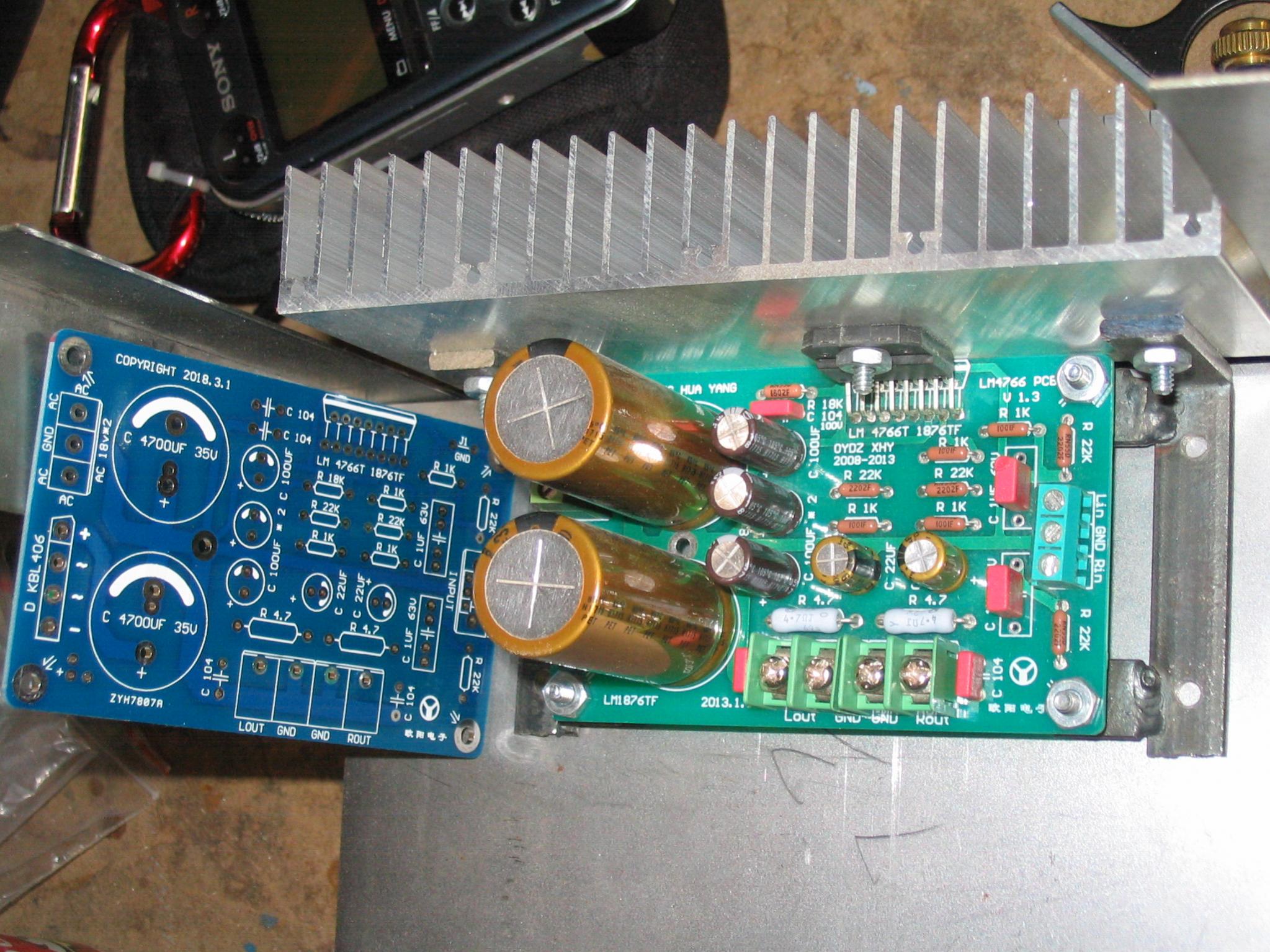

I am happy the LM-1876 is getting some recognition again. So far, I built two of these amplifiers from Ebay boards and found them enchanting. The 4.7 ohm resistors are spec'd on the data sheet supplied with the boards as 2 watt.
Two light green boards (photo, if it comes across) have done duty in my shop stereo (one amp is for the subwoofer) for 3-4 years. The LM-1876 is a good sounding amplifier, within its limits, even on Magneplanars.
The upright unbuilt board in the photo is a newer Ebay board but it has the same circuit and parts list.
I am currently fabricating a real chassis (formerly a plywood scrap) for my shop stereo which made it convenient for taking the photo after blowing off the heavy layer of sawdust.
I recommend the Ebay boards and also recommend (not in the photo) Cornell Dubilier 935 Polypropylene input capacitors, preferably 100 volt. You can find them in the Mouser catalog if you search long enough.
I use a 15V/15V transformer which should give you the needed 20v/20v on the board. I made my own heat sink mounting bracket since I have metal working capabilities. However, home centers have aluminum strap that you could bend and bolt together if want to make the chassis and heat sink a module like I did.
