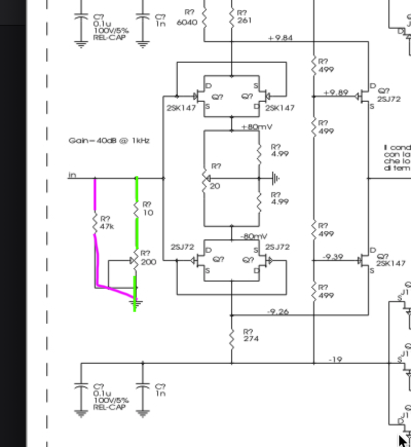

The three FET's should be in parallel and so to the resistors.
Yes. It says 'total resistance is 250' which means the 261 and 6040 are connected in parallel.
Even without that note, the way it is drawn should make that clear.
BTW This is a fine example of how NOT to draw a schematic. Very amateurish. Is this an existing design?

I found the circuit in the network - Italy

Why would there be 3 fets on the negative voltage rail and 2 on the positive? I posted earlier then deleted my post to check Idss on J112 and J175. J175 should have higher Idss. Also why 0.5 V difference after the fets? Any ideas?
Yes, probably to construct two complementary matched 'devices'. Note that this is all open loop so you must go to heroic measures to get some acceptable linearity from it.
BTW in its original complete form the schematic drawing does make sense so I withdraw my earlier 'amateurish' comment...

I'm probably the first idiot who makes a copy it's all about good old transistors that are no longer available
The last question!?)))
- Is this circuit suitable for a 47K head load MM ?
