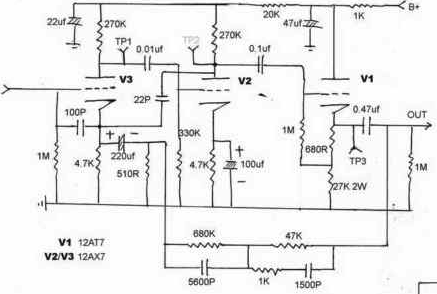

The schematic is attached below, the current is a little less than your measurement subject I think, TP1 is 140V so current is (250-140)/270k = 0.41mA

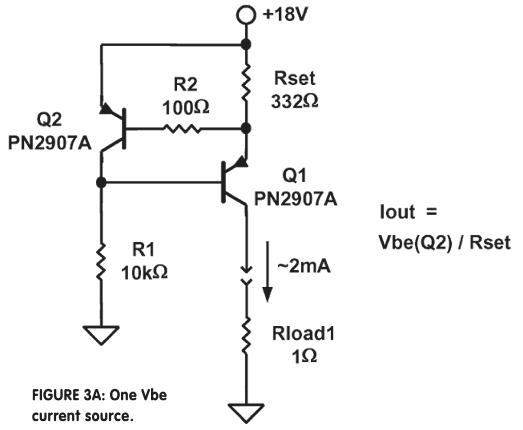

Not sure what a cascode bipolar looks like TBH, every time I look on the internet I get a different toplogy, some with diodes, some with leds here, leds there, the odd potentiometer etc. Very very confusing. I've attached a picture of what I think a Bipolar cascode current source is (from Walt Jung's paper), but like I say, it could be anything 😕

The bipolar CCS I used was a diyAudio group project; I think Greg the Geek was selling boards and documentation for it; it's pretty similar to the designs shown in Morgan Jones's book (though without the misprint, harrumph). The one you showed is actually a ring of two rather than a cascode.

You can use LED and CCS with V2 since it is loaded on a high resistance bootstrapped input.
I've previously looked at 12AX7 curves and thought it should do well at a constant 1mA or so, but then thought the output z might be too high to be usefull. I'll look again.

There was a good document somewhere on this forum called
diyAudio-CCS-beta2.pdf
Or an alternative way from Geek: http://www.classicvalve.ca/docs/CVD_CCS_preliminary_docs.pdf
