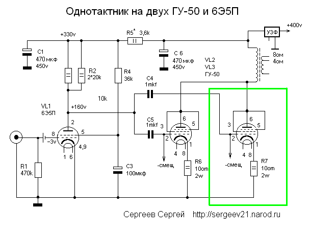

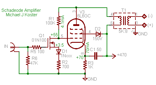

quikie22 thanks for the circuit you posted but how Wavebourn wrote it is not correct so to me how is it useless. Sorry about that..
It is correct, except one resistor is drawn by mistake to be connected to the wrong point. Easy to correct. 🙂
Anyway before building an amp you will have to study it's schematic. Nobody can give you complete instructions, you have to understand some basics, otherwise may be electrocuted to death by high voltage.

The following circuit is a suggestion, seeing that you have 6E5Ps and GU-50s. The variable resistor values given are a rough guide. Owing to the variability of the transconductance of the 6E5P it is difficult to give a specific value as one tube differs from another, just the nature of the high transconductance tube. The important point is to aim for 150V at the anode and screen.

Hello Thank you The question it was only drawn wrong or it was build wrong to.. That was not cleared (or answered) from his side. The reason I wrote the circuit is not useful to me after I read your correction. I can build almost anything if is on the paper and correct (here I'm not talking using micro chips etc). I worked with power many years with electrician mostly residential and sometimes industrial also. That is not mean accident can't happen unfortunately many time happen even with experienced people to. Also I built amplifiers, fixed them, I did volunteer job in TV shop over 3 years. So I do not afraid from the power, I respect it but not afraid. Mostly built SS amplifiers and I did some (not much) tube work to so some help frome tube guys it would be great! Reason I asked for help, if the circuit correct I can build it! Now I have almost all the parts (all do today I studied the sergeev21 PSU circuit and I still need a transformer for the power tube bias. I'm not upset about him, not at all. I appreciate he wanted to help me all my respect to him..
Thanks Wavebourn

Hello Thanks for the posted circuit! I do like them specially with the FET derived version. For now I decided I'll stick with these circuit, these amp was built and work correct how I get the info thorough translator... But.... I do have several question before I start to put together the amp to test it (& buy the missing parts like resisters etc). First I just realised I need one more transformer for the bias -V. If I'm right I need something around 60VAC?? What would be the min.VA req. for both channel? Second question There is something in the PSU circuit I do not understand manly because the language barrier, all do I learned some Russian when I was child in the school.. That little Russian knowledge already gone Well said if you don't used U loosed.. So I would like to ask for help where do I connect that +30 see red arrow green bracket..
Please someone help me with that! All do the circuit use two power tube I will go with one because my OPT only 10W. Do I have any disadvantage because I use only one GU50/ channel in these circuit. OK I get less power, that is still plenty to drive my speakers in a apartment.. I think these circuit can work perfect with one tube also but I ask some of you who has more experience with tube stuff in case I'll need some mode . I post a picture from my power transformer, I think is good quality some kind of Philips product. Good size and has the right the voltage I need. I do not have on the transformer the 12V for filament but I have separate transformer 12VAC 5A, or 12.5VDC 2.5A. So that would solve the problem.. I thought over and over what to do build the GU50 or go for the 300B. I decided if I already has everything almost at hand why would pas by with out give a try..

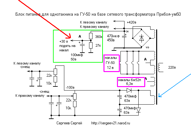

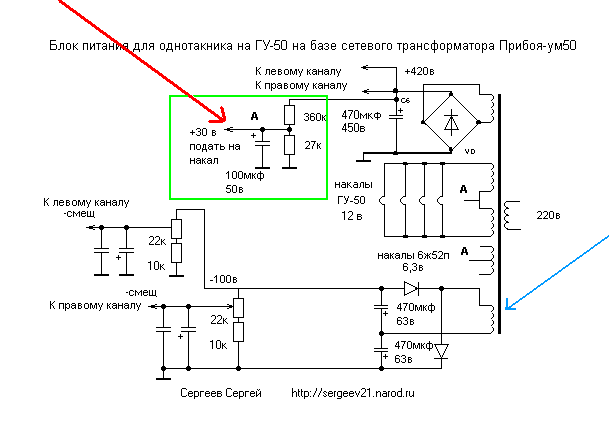

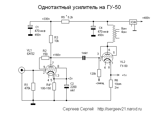

100V*( 100V/(10K+22K parallel 10K+22K) ) = 0.625VAIf I'm right I need something around 60VAC??
To the first tube heater.So I would like to ask for help where do I connect that +30 see red arrow green bracket..

If I look at the tube data that can not be the first tube heater voltage.
http://www.shinjo.info/frank/sheets/113/6/6e5P.pdf
It must be 6.3V..
May be because there is the other circuit where he use 6Z52 tube. I will take a look.
http://www.shinjo.info/frank/sheets/112/6/6Z52P.pdf
Now I'm really confused because these tube heater req. 6.3V.
Do I misunderstanding something?😱
HAKAL is heater that sure, so you right but both tube data show me 6.3V.

I attach the other circuit where he use 6Z52.
I read in English 6E5P much better tube so I purchased that. I would live to use it.

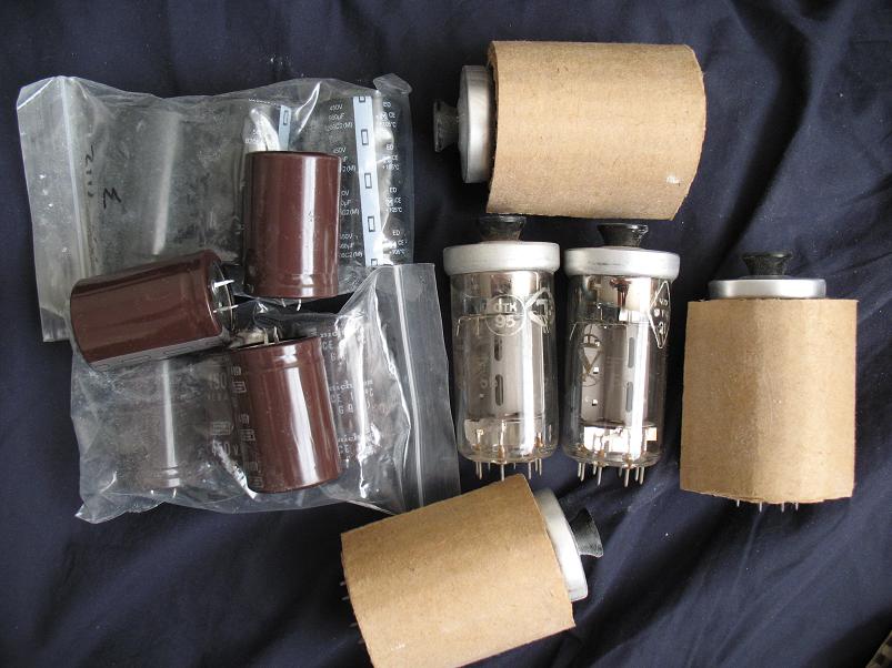

Some more parts
I thought I'll post more pictures from the parts I already collected.
So you can see I'm serious to build the amp.
I also have the tube sockets, 6E5P tubes, 12PC Epcos MKP 450V 150uF capacitors, each cost over $110 and other 450 470uF & 560uF.. I have more parts and more tubes just it is no reason to make picture from all.
I invested way to much just to gave up. I just need the resisters, and for the bias a transformer.
Of course those expensive caps was purchased for other tube project but I can use two piece here in case..
I hope someone will explain that +30V in the PSU circuit since I find the tubes req. 6E5P 6.3V & GU50 12V for filament. I do studied further the PSU circuit and now is 100% the filament voltage is the above mentioned.
I do mark the filament voltage, the designer clearly stated that in the circuit.

Off Szia! On.It must be 6.3V..
I think +30V is the heater elevating voltage.
Some tube's overall noise is smaller with elevated heater.

Reading the tube data I can't go over 7V.

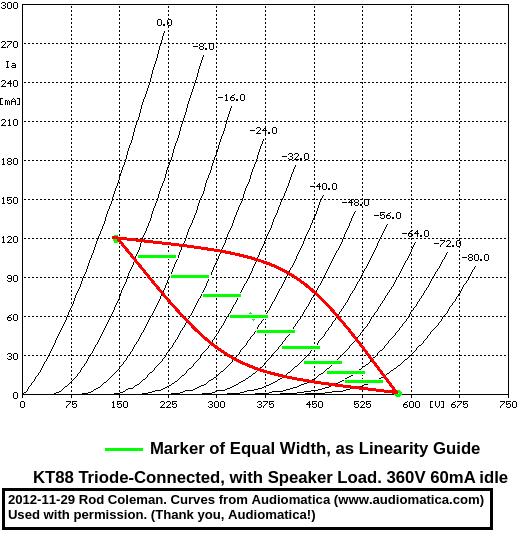

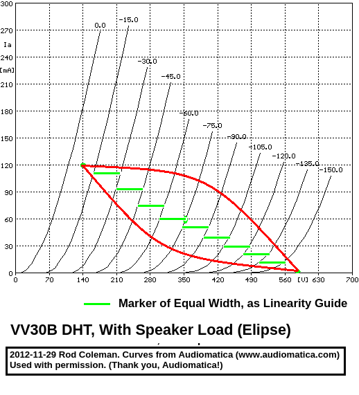

For non-critical amps, or amps where the budget does not allow for the B+ and filament supplies to be implemented properly (eg no choke-input for B+, or filament heating with ac or raw rectified dc) - then you may well be better with KT88, triode connected. The lower cost of the KT88 will be in line with the cost of the whole amplifier.
But if you take the trouble to implement a DHT 300B amp properly, you get open-loop linearity well above the triode-connected pentode class.
The curves below show why. With a speaker as a load, the reactive components force the "load-line" into an ellipse.
Comparing the two power valves, using Audiomatica's curves (used with their permission)
The Audiomatica Tube Directory
I have marked the curves with green markers of equal width, as a measure of linearity. In both cases, the operating point is 350V 60mA. The comparison is hopefully easy to make.

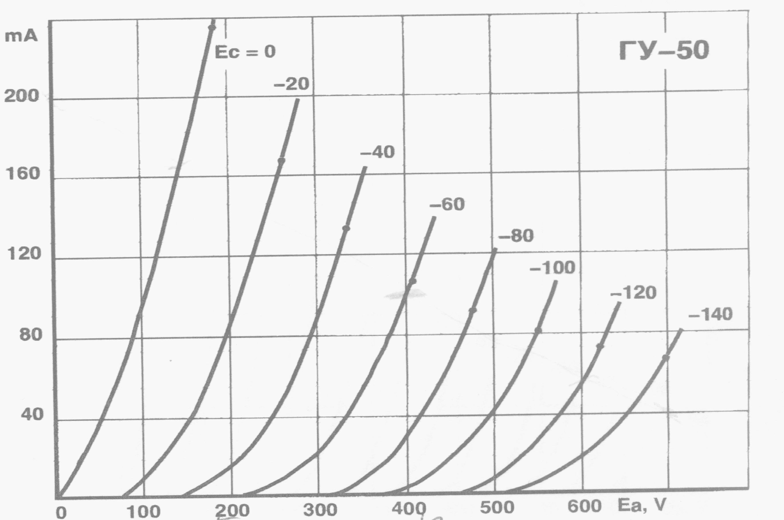

I think the ГУ-50 (GU-50) is a splendidly made power tube. But the linearity in triode will be similar to the triode-connected KT-88.
This is no surprise: most indirectly heated power tubes in triode produce curves like this (see below for ГУ-50 triode curves).
If you really like the ГУ-50, it may be better to design an amplifier that uses some kind of local feedback to improve its high-voltage linearity.
Since the OP question is a direct comparison in a SE amp, the 300B has the greater potential. But only if the B+ and filament supplies are implemented to a high standard.
According to my tests (and simulations too) with sweep tubes (PL36, 6P13S, 6P41S, 6P36S) and with the GU50, the best linearity is not achieved with triode connection.
In all cases UL connection gives better linearity and higher output power.
