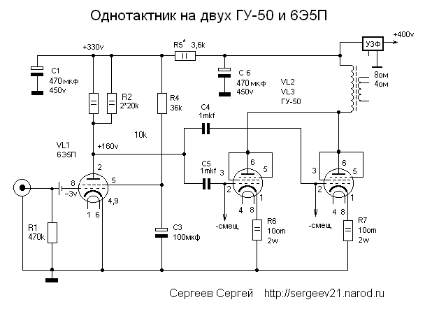

Here is the two circuit I think about
First the GU50 what I planed to build but mean while I collected the parts I get several negative or just OK feedback on these tube using as SE...
http://sergeev21.narod.ru/gu50se.htm
The GU50 I like with the 6E5P driver tube but one power tube only..

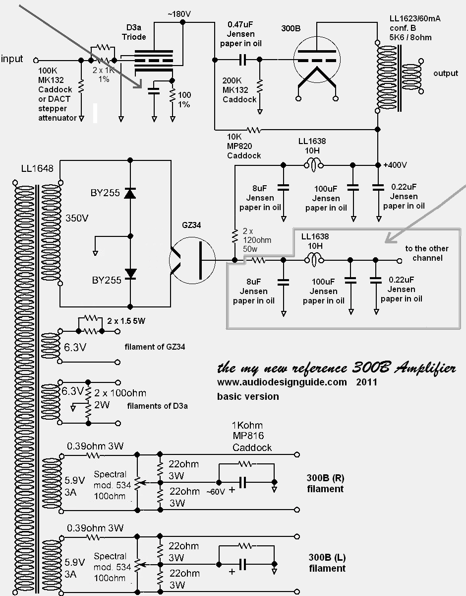

The 300B is from Andrea reference amp all do I have to do several mode because he use higher primary OPT and almost dual mono PSU.
Right now I have only one choke 6H 200mA, he uses two choke. I don't know for start if I can connect both channel to one PSU.. At least to test the circuit.
After I would buy a pair choke because the two must be the same.
I wrote to Andrea to get some info about his amp but unfortunately I didn't got answer yet. Also one capacitor value missing from the circuit..
Please take a look the 300B circuit, can I use it with my 3.5K transformer and for start can I use only one choke in the PSU?? I know these is a great amp, I know if Andrea say is a reference amp that is not bad.

Hello
If you look at the 300B circuit there is two arrow
First I don't know the capacitor value and voltage
second arrow - I'm not sure if I can leave out that part of the PSU and connect both channel for the one 400V.
These would be temporary until I would get some idea about the amp performance after I would buy two 10H choke. Also I plan to use SS bridge rectifier, not tube
Only I question the amp performance because my OP transformer has 3.5K primary. Probably I get higher distortion and higher bias with out mode.
Please let me know what would you do in my case.

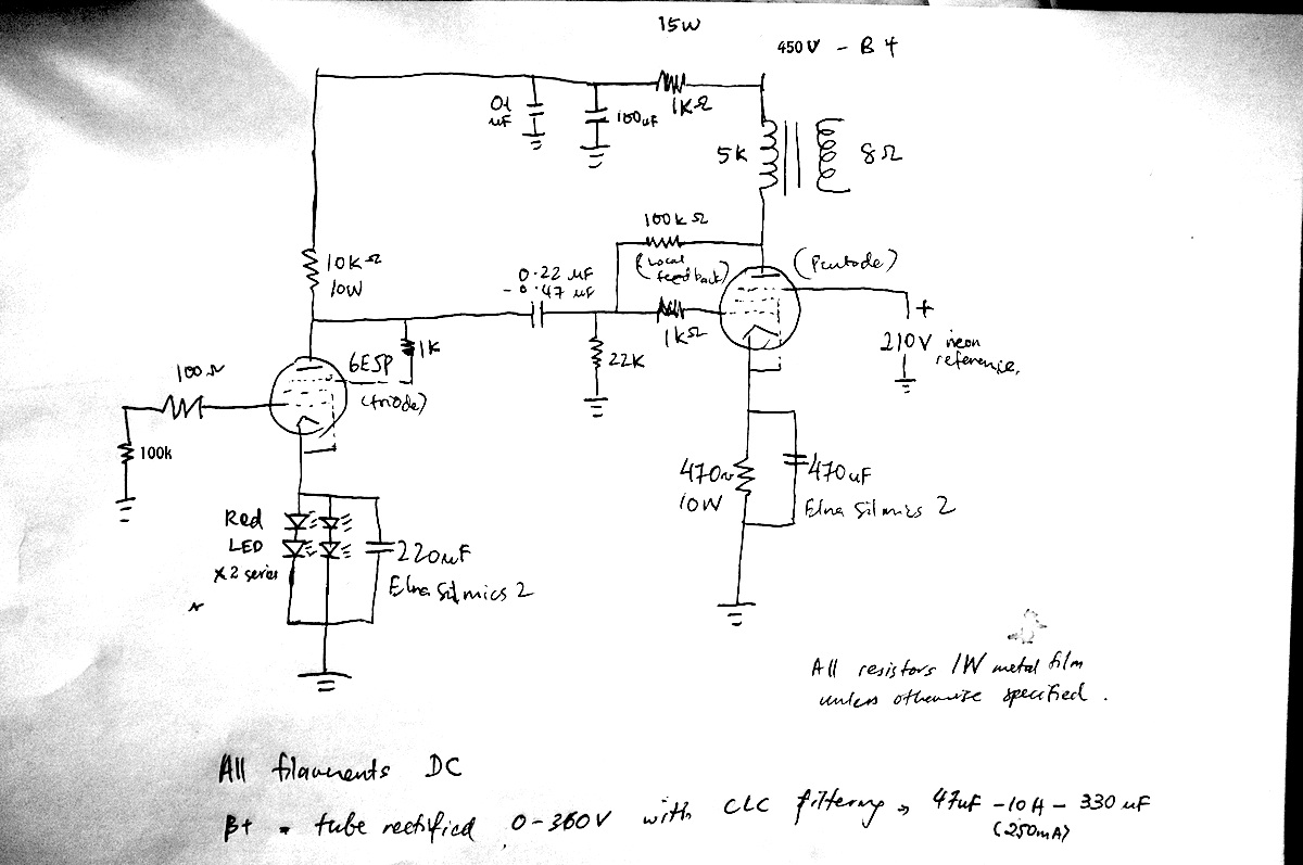

I have built the GU-50... and I think it is pretty awesome.
You can try running it in triode mode, or switching to pentode mode but use some plate to grid feedback.
Since you already have all the parts you need, just proceed with the GU-50... you may end up liking it. I certainly do like mine.
It won't sound like a 300B, but I could say no 300B could ever sound like it, with the solid bass and bite and yet maintain a sweet midrange especially in pentode mode.
BTW, my driver stage is with 6E5P too but using 3 red LED bias bypassed with Elna Silmics2, and the GU-50 run in pentode mode with screen grid voltage regulated by neon lamp voltage reference at 210V.
i'd build the gu50 and when funds allow get some 300b's, the money is in the ps and opt's so swapping sockets and bias components is a pretty economic way to get a new amp. i would not fret too much re your choke, worst case you get a little cross talk and imho thats the least important spec when your listening.
p.s both those circuits could be much improved with 2 resisters and a dn2540 mosfet!

210V probably shout go to the 2'nd (screen) grid of Gu-50 instead of the 3'rd one. 3'rd grid should be connected to cathode. And 6E5P ( 6Э5П) is tetrode, it has 2 grids only. No 3'rd grid.

To the Andrea 300B circuit I can get two 5H 100mA choke plus I use my 6H 200mA.. My question for the 300B the choke does need special air gap/ I see on the Ebay from Taiwan the mentioned choke for $24/PC plus shipping. It look nice but who knows the quality.. One think if I could know from the GU50 can get enough and quality bass in SE mode. That would be very helpful. I read many negative about these the tube. Some people wrote only good for PP if I want audio sound. The picture I got now (from all information get about the GU50 tube) if I want good SE sound with acceptable bass I have to use 300B tube or some transmitter high voltage tubes. Also certain PL TV tubes great but need 500V or more.. And pricey to.. These theory is true I will be not to happy because the GU50 tube price VS the 300B..:bawling: Al do if the extra invested money would ad up at the sound quality I would not mind. I do have the driver D3a tube for the 300B but not the power tubes. So before I will do invest more it would be good to know all that investment it will be for good use or in vain. I do make picture from my collected parts, I have the amp case also but I will tested on a PC of plywood at first.

Plate to plate or "Schade" feedback works best with a driver that has a very high rp, that is tries to works like a current source. A triode on the other hand has a relative low rp and tries to work as a voltage source. There are basically three options for a Schade driver:
1. Use a high gm tetrode or pentode, (your 6E5P), but do not triode strap it.
2. Use a cascode with a high gm triode (6DJ8).
3. Use a depletion MOSFET (DN2540).
Either of these three options will out perform your 6E5P operating as a triode. Also operate the output pentode as a pentode as well.
Go build your 300B amp gaborbela 🙂 and enjoy it.
