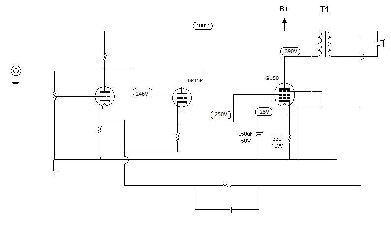

It is possible, but screen drive is not very linear and high driving level is required.
With 100 Vpp the output power is some 3,3 W (2k5 OPT), THD = 6 %
With 240 Vpp, 13 W, THD = 14 %. Distortion is mainly 2nd harmonic.
All the above values are from LT Spice simulation.
