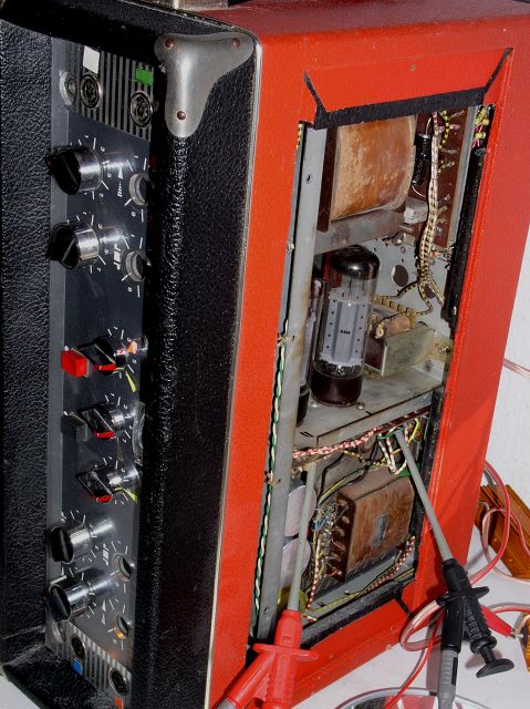

i have a few old Dynacords that need to be restored. These amps deliver 80W of constant power from 2 EL24 running at 750V on a 220V mains (i.e., something around 90W on modern 230V mains). Similar to the GU50, the EL34 demands for an Raa of 8k at these voltages.

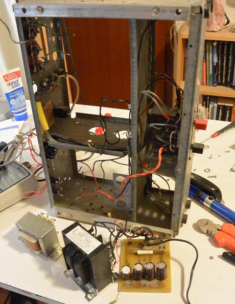

One of the amps is nothing more than chassis, headshell, transformers (hopefully ok, tested), and a few poti knobs.
So why not try to set it up with GU50?
There are a few peculiarities, however:
a) mechanically:
the EL34 are mounted horizontally relatively close to each other, but 2 6L6 can be fitted into that space. Pictures of the situation below.

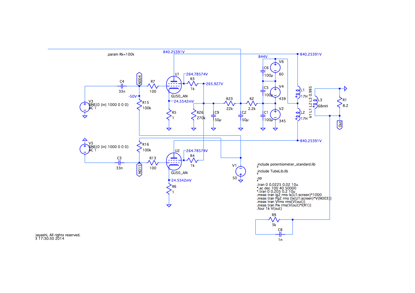

b) electrically:
the GU50 needs 12.6V. Is a voltage doubler an option? Otherwise i would need to squeeze a heater supply into that space.

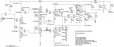

the G2 voltage of the GU50 is much lower. In the experiment shown below i changed the stacking of the secondary voltages in order to account for this. Meaningful?
Obvious disadvantage: rail voltage for the anode supply of the preamp is pretty small, possibly a bit too small for the PI stage.
So my question: what Do You think?
The simulation shows up pretty large distortion - more than 5%. And surprisingly large output power - 135W at 7% THD. Which i cannot believe. Mhmm.
Shown below: the schematics of the original PSU, the numerical experiment, the target transformers and the EL34 board i would like to avoid to reuse, and empty chassis and a fully equipped older version of those amps with two additional chokes in the PSU.
In the simulation i scaled the voltages by a factor of 1.045 = 230V/220V.

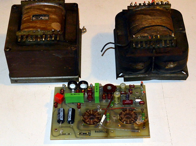

As the dead amp was a hybrid amp the PT provides an additional secondary of 45V, i had the idea to add its voltage to the others as well.
The preamp uses around 90mA so it is unclear how much it can actually deliver. Same for the heater supply. In the original amp it feeds two EL34, 1 ECC81 and to lamps each taking 0.3A. Like all other secondary outputs of the transformer.
There is still a replacement transformer set available, on the same core size. This is specified 4.8A for the heater and 260mA on the 45V and the HV rails (plus 100mA for the bias rail). Although that PT has been designed as a drop in replacement, it remains speculative to which detail the original PT is mimicked.

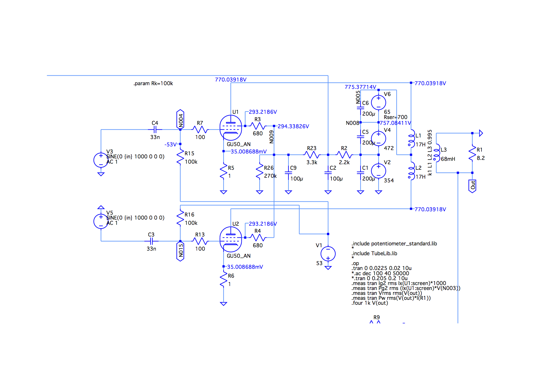

You need a much lower impedance for the G2 supply. According to the LS50 datasheet, G2 current varies from 2x 0,9 mA at idle to 2x 13 mA at full output at these operating conditions. When G2 is fed through a resistor of 22k, the voltage would collapse when driving the amp.
When you look at the schematic of the power supply, you see that the 750V is generated from stacking two individual supplies. In the original EL34 version, G2 is fed from the bottom supply, or around 400V. Use a regulator (not a resistor) to bring it down to 300V for the LS50/GU50. But -more importantly- know what you're doing! These kinds of voltages are much higher than in the typical amp and can be very dangerous.
Thanks for the response.
First of all - i am fully aware of the danger of these voltages. I have already restored a few of these amps. And the board of the EL34 shows the traces of what they can do - the burns are so deep that it should not be reused...
A word to the regulation: there is actually a regulator, although the most primitive one: R26 does not only act as a bleeder, but also as a shunt regulator.

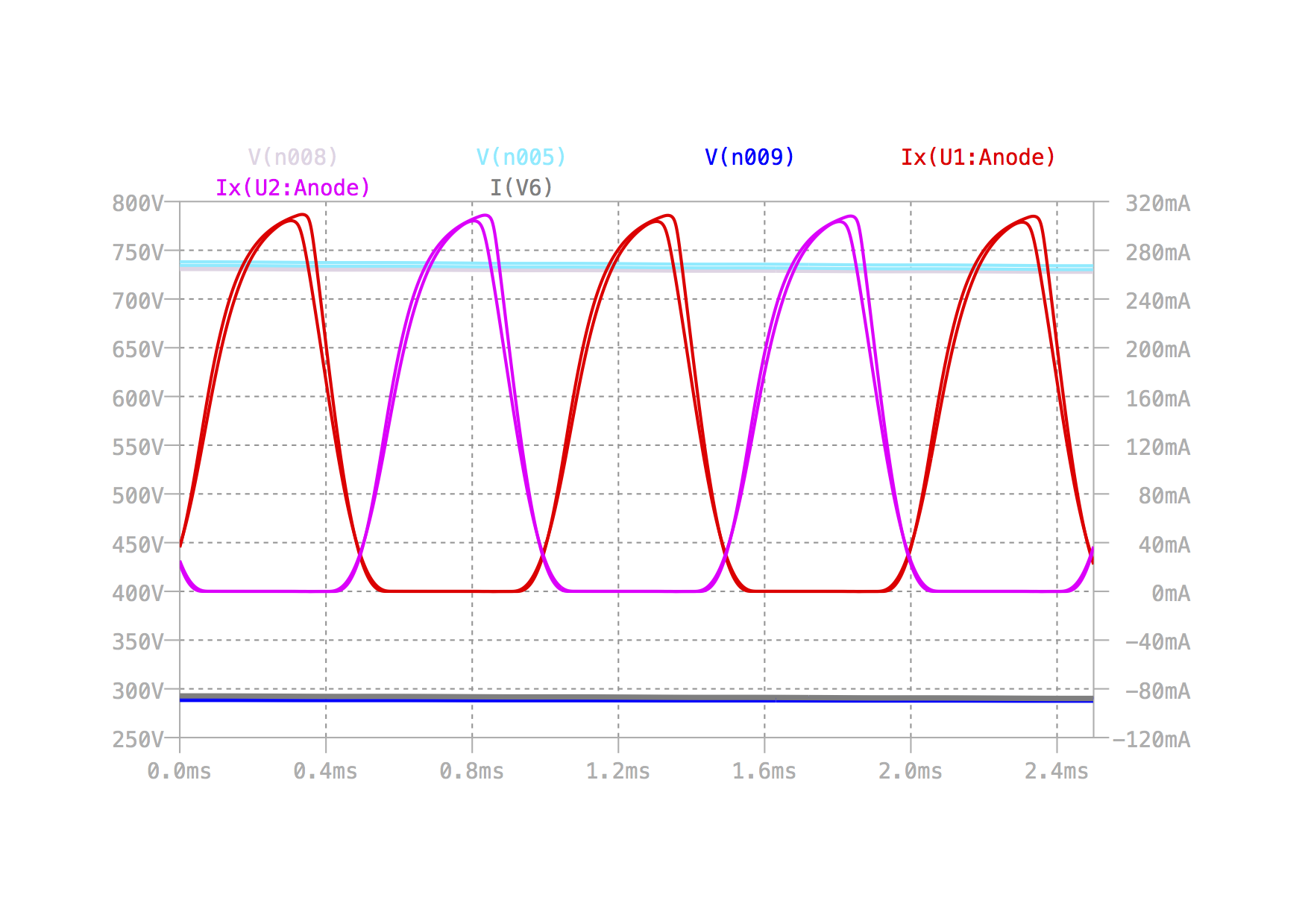

In order to see the effect i plotted the G2 voltage below, for a very small input signal, a signal short before clipping and a signal at the onset of clipping.
You see the voltage directly at G2 (N007) and the voltage at the junction between G2-resistor and the shunt (N009) which has a very low impedance for NF currents due to the capacitor.
At N009 the voltage is pretty stable. The voltage drop over the G2 resistor is to some degree desired; it protects the grid from overload. Grid load reaches 2.7W - so it might be possible to reduce R3 a bit.
That's going to be used as a bass amp, so it is quite possible that the amp will be driven into saturation, at least occasionally. So i prefer to be conservative and would like to ensure that even massive overload of G2 will not harm it.

Addition: i tuned the parameters a bit toward larger G2 voltage, smaller G2 resistance and larger idle current and came out with R23=3.3k instead of O(20k)) and G3/G4=680R.
Now i try to get an idea what might be going on in the PSU. In this respect the simulation is pretty tentative: in reality the windings of the transformer are independent. Hence there is no common current path through the real "sources". In the simulation i used some ballpark values for the internal resistance to roughly match the values given in the original schematics.
Anyway, here is a view on what might be expected: You see that the current in the uppermost branch of the stack is about 100mA. And that's something the transformer will most probably be able to deliver (it definitely does 90mA).
I also plotted the anode currents and voltages at the anode and the screen voltage.
The input signal has been chosen slightly smaller than the bias voltage and somewhat larger.
This looks sufficiently reasonable to try it out, doesn't it? Which does not mean that i will not try out using a better regulator some day.

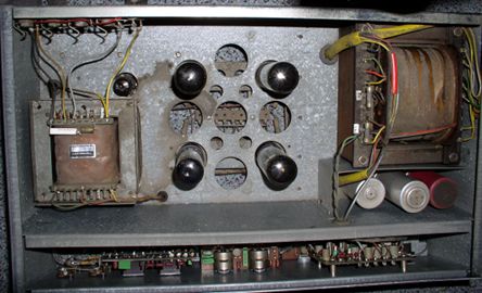

1) have a look into an early all tube Eminent 2 (i own one of these, way better that the hybrid version)
2) who forces me to use the headshell, or to use it unmodified? If done right, parts can be positioned above or below the chassis.
the Gigant and Gigant II with their four EL34's are quite another story, though, 'cause their chassis offers much more space for the required supplements.
Where is the choke in the amp below (my G2000 before restauration)?
I will not touch the PS of that amp unless that project has turned out successfully - it is one of my "production" amps. (Again, they probably started production with chokes and changed that pretty soon).
attachment.php
I own four GIGANT and one B2000, all featuring the same PSU/power amplifier section. The choke is beneath the chassis, in all of these.

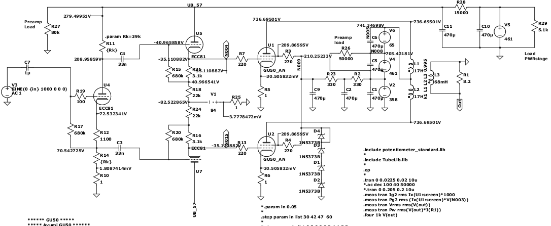

A recent experiment, still far from usable. Main goal is to check the driver. Although the catodyne should drive that stage with ease as long as gridd current remains small here a variant with an additional cathode follower:
attachment.php
I am looking at the effect of Zeners to stabilize the screen voltage. Remarkably the input voltage for full power will be smaller when G2 is kept smaller, without a significant effect on available power (which seems limited mostly by the PT).
Another issue is to keep the cathode currents below 90-100 mA - that's what the DCN027 is known to deliver safely. And that is apparently the biggest difficulty aside from the queston of the permissable grid leak.
Anothe remark - the power supply: i have the idea of spreading the load on the secondarys of the PT - feed the screens from V2 but the preamp and driver from V4 -capacitively attach a 2nd rectifier to V4. I do not know how to describe that in LTSPICE, so i do temptatively add load resistors R27, R29, R26 and use a seperate voltage source V5.
Unfortunately i cannot show simulation results - the postcript preduced by the windows printer driver under wine does not work at all.
You see that the bis circuit needs a lot of detail - i'm currently more interested in feasibility. But from the Eminents plan the 65V winding will deliver 76V under load with just one way rectification. I will, of course, use a bridge which will probably
