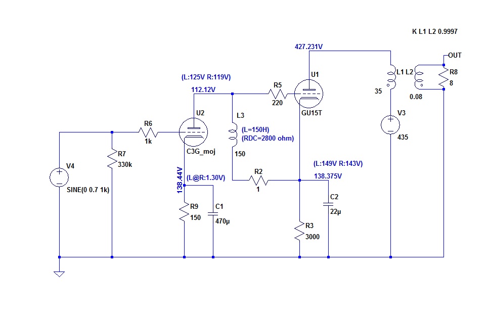

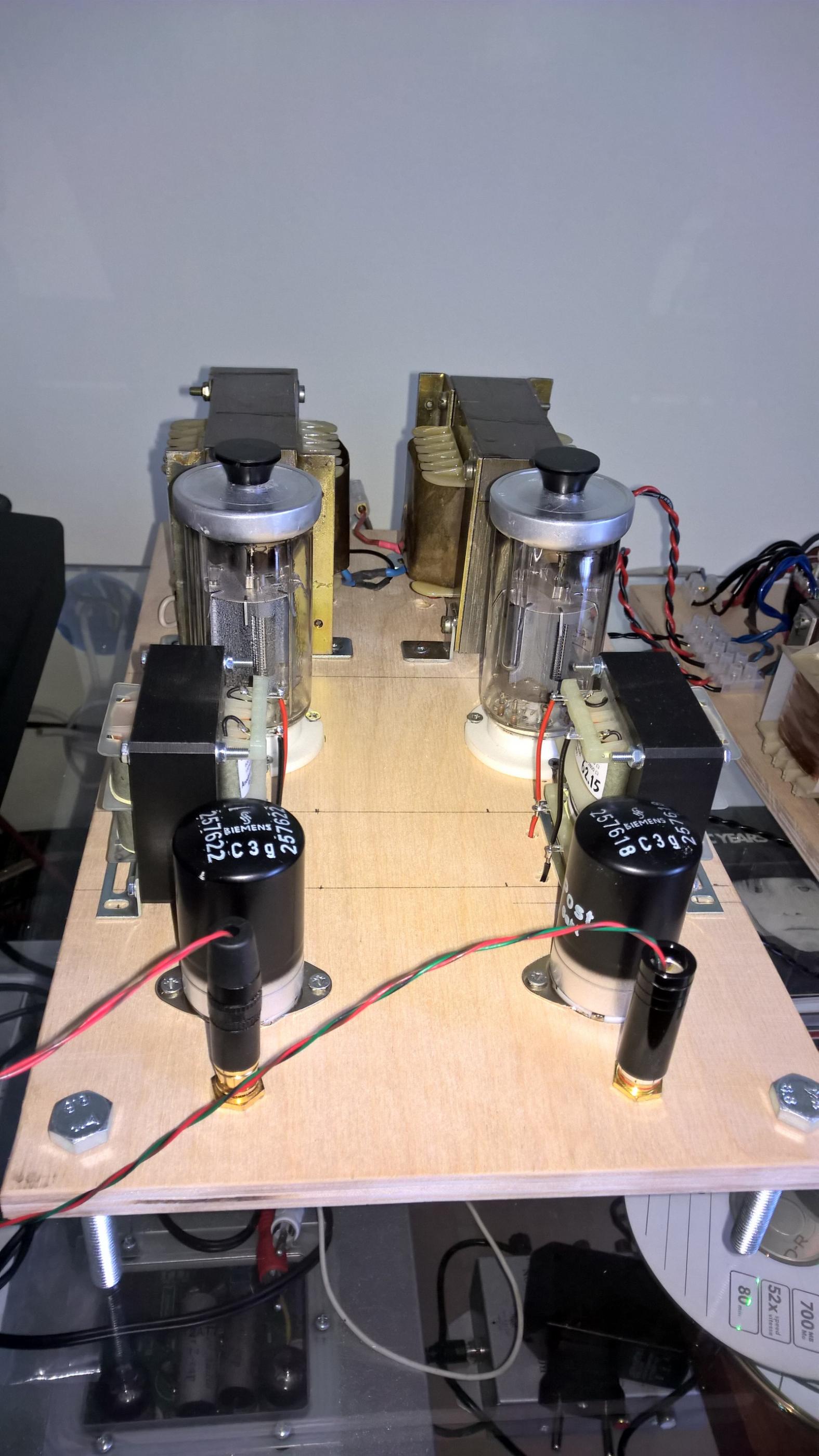

I am finished my new prototype amp with GU-15 tube. GU-15 is medium power (19W) DHT pentode. More information and some data: http://www.diyaudio.com/forums/tubes-valves/47108-magic-gu15.html.

Can you please let me know some more details about the sound? Does it sound like a DH tube (airy and effortlessly)? Did you think about a comparison with 4P1L and/or 6P21S, or maybe even with #45 or 2A3?
From the circuit, I understand Ua is 435 Vdc while the drawn current is only 35mA. Why did you chose this OP?

yes it sound like a DH tube -airy and effortlessly. Not so sweet as 4P1L, but with more body. I like this sound.
OP is around 290V/57mA - 16,5W. Where did you get 35mA?

Thank you! I saw written 35 near the OPT primary, but now I think it’s the impedance (3K5).
Anyway, I’ll check the impedance on the diagrams already provided by our colleague

35 is the inductance in Henry for the primary of the output transformer.
I simulated the schematic in LTSpice... I kinda still don't understand why it works 😛

I am not decided to use this tube, I was only trying to find some more interesting DH tubes which may work in audio. To be sincere, I listened to a 6P21S SE, amplifier, to a 4P1L SE and to my 2A3/#45 amplifier. 6P21S, clearly sounds better than a usual indirectly heated penthode or tetrode, but not that refined as #45 does. 4P1L is much closer to the triode DH tubes.
