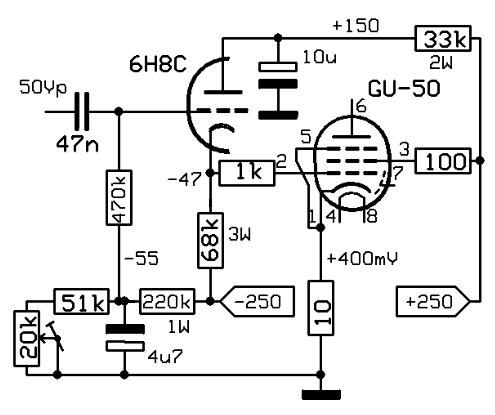

As the bias winding doesn't need to be tied to GND, you'd use a Delon doubler. It's output impedance will be sufficiently low for the purpose.
